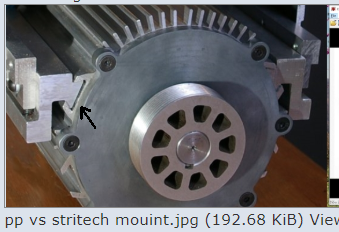

Also noticed-there is a slight bit of play on one of the motor mounts-since I don't know the exact names-i will take a picture after i tear it down some but the mount bracket slides into the fins on the motor and this is where i can see some play on one side. Its almost like the fin slot is a bit wider than the mounting bracket mate piece that slides into it.

JPG showed a good image of where I see the play on the motor mount.
Re: Audio Analysis of PowerPro
bainin wrote:JPG showed a good image of where I see the play on the motor mount.
Dusty posted the pix first.

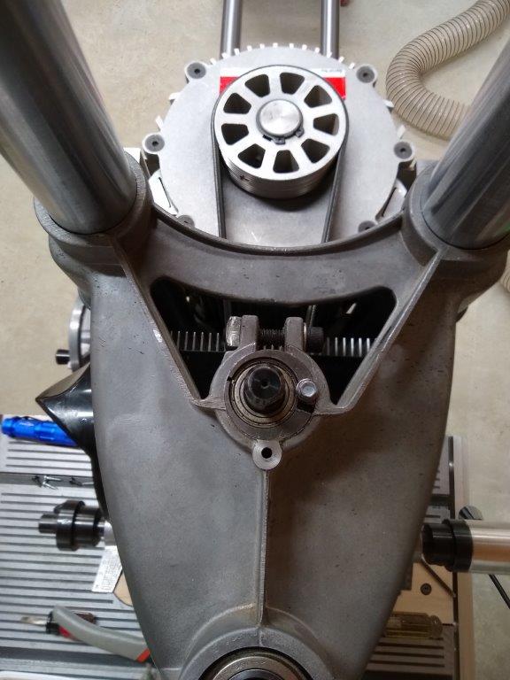

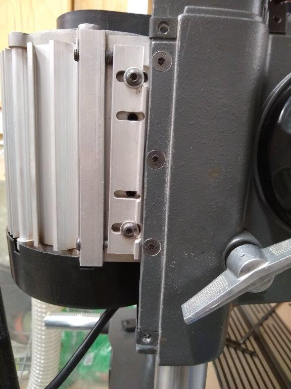

I took a couple of photos-hopefully someone can educate me on previous parts of the discussion above.

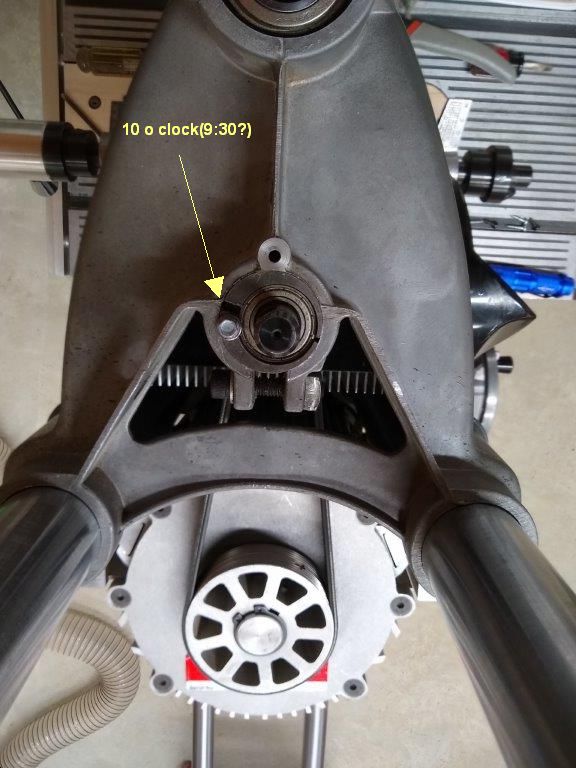

First - the eccentric position ... is that 4 oclock or 10 oclock?
Also-at 6 o'clock in the image- seems I am missing a retaining screw/washer?
2nd- I noticed that the offsets for the front and back of motor brackets were different.
Measuring the gap near the offset screws- the top is ~ 5mm, the bottom about 3.9mm.
However, a straight edge running from the motor pulley surface across to the belt pulley is making pretty close to 90deg.
I couldn't find any guidance on if the offset gap top and bottom should be the same?
I adjusted the top set screws to be roughly equal gap, and the bottom screws to be roughly equal gap..but not equal top/bottom .
I have to assume I want the belt to be perpendicular to the eccentric axis--which is why I left the motor angle the way it is shown on the brackets.
b
ecc 10 o clock.jpg (68.96 KiB) Viewed 5603 times
DLB
Posts: 2308
Location: Joshua Texas
Post by DLB »
So, as JPG rotated your picture the missing screw/washer is at 12 o'clock. I reckon the function of the screw/washer is somewhat less critical on a PowerPro, but they would normally be there. I had a conventional headstock that was missing the same parts, and in fact the hole was not threaded so they were never there. (And it did not have a problem in its first 17 or so years of use.) https://www.shopsmith.com/ss_forum/view ... 90#p268690
A very small amount of 'play' of the spindle inside the quill seems normal. I can hear this more than feel it. I'll try to rig a way to measure a couple of samples.
Does your install manual have section E? It refers to the Tensioning Setscrews at the pulley end of the motor and the Belt Alignment screws at the other end of the motor. They are not adjusted equally, having different purposes. (But IIRC the install video said they should be equal?) Procedure says to adjust them using a straightedge so that the face of the motor pulley is aligned with the center of the Poly-V Pulley on the Idler.
- David
