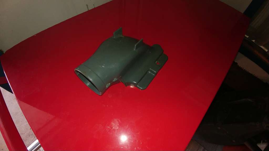

One of the small things included in my recent purchase was this dust fitting, which looks as though it might be intended for the bandsaw:
Dust fitting
Dust fitting
If so, I don't have any instructions or other hardware for it and I'm not really sure where or how to mount it. There are no obvious locations and a hole would need to be cut somewhere. I do want to have dust collection on this machine; can someone provide information as to how I should proceed?

That is the dust collector fitting for the jointer. None of the SPT's came originally with dust collector fittings.

jsburger wrote:That is the dust collector fitting for the jointer. None of the SPT's came originally with dust collector fittings.
Ah, OK. I did buy a jointer (eBay); looks like some of its pieces have gotten mixed up. Thank you.
