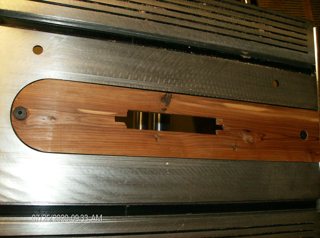

Make your own table insert(s) from wood,
I have done that for my 10ER and it works great.
Zero clearance insert for wobble dado.

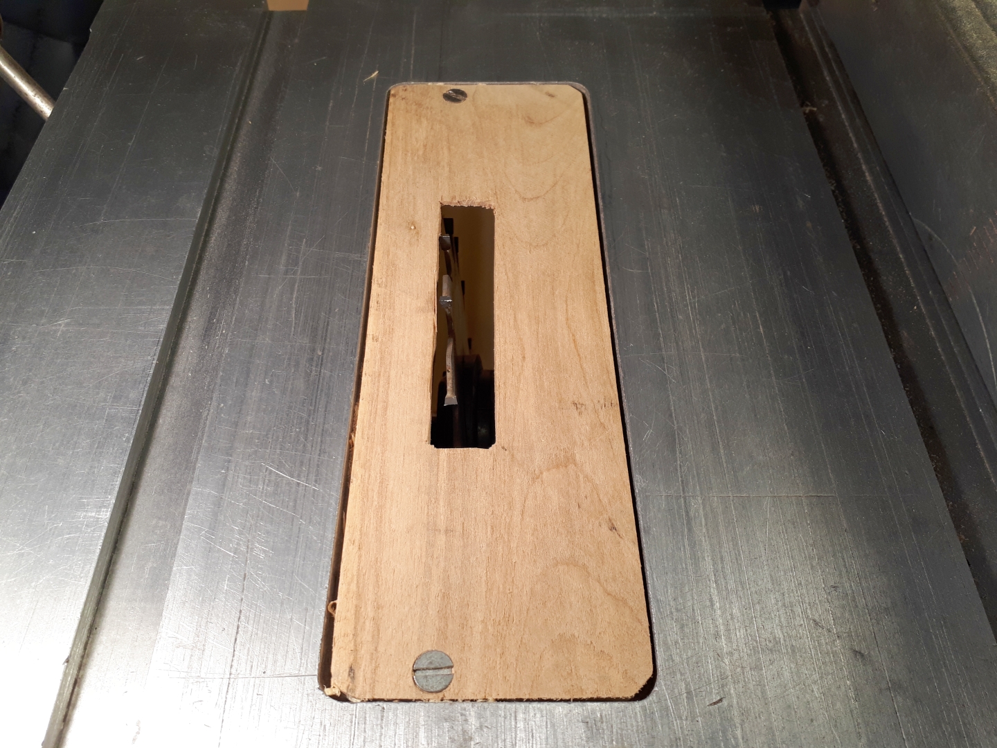

You can make insets from any 1/4" thick material you have laying around. Plywood is often not true sized at 1/4". Check your scrap bins and you should find something that works.
This is a dado insert for my 510 table. I made some for my 500 table too when I had it.
