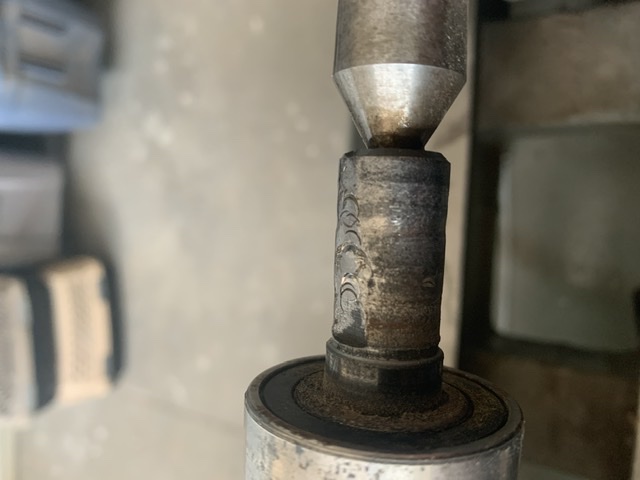

It looks like it had a reverse taper. I would probably just grind a flat back in it. It does not have a key way. The local machine shop wants $75.00 to do it. I have a metal lathe that I just got going but need the cutters and something to practice on. I wouldn’t want to mess this up.

Spin it and clean it up with fine emery cloth.
The flat can be 'improved' with a flat file.
I think this is salvageable.
Be careful to not repeat what the PO did by not orienting the pulley properly over the flat.

It looks to me like the OP routinely failed to mount the hub properly. The marks left by the set screw appear to me to be in-line with the flat but spread the length of the flat. Position the hub properly on the shaft before tightening the set screw.
Re: Planer head shaft damage from pulley.
Yes those marks are 'along' the flat, but do vary off the cl of the flat(especially the apparent last one). Apparently the po did not know to 'rock'.dusty wrote:It looks to me like the OP routinely failed to mount the hub properly. The marks left by the set screw appear to me to be in-line with the flat but spread the length of the flat. Position the hub properly on the shaft before tightening the set screw.

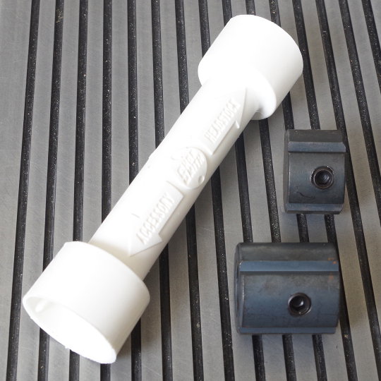

After seeing the end of your Planer's cutter head it appears you have an older Mark Mount Planer. The flat is for attaching a hub. A keyed shaft is for attaching a pulley. Re-reading your original post has me wondering what was attached to the shaft end to drive it.
Since you have a metal lathe can you mount the cutter head on it to check how out of alignment the shaft end is? Using my Mark V or 7 I would clamp the far side bearing in my Nova Lathe Chuck and support the near bearing on the table so I could turn the cutter head by hand. I would use my dial indicator on the end of the shaft to check it. Something similar may be able to be done on a metal lathe. Just needs a steady platform to hold the cutter head while rotating it. That may give you a better idea of the best way to correct the problem.
First you said the pulley is wobbling but at the end said hub pulley. Is your Planer a Mark Mount using a hub (similar to the ones in the picture below) powered by the headstock or has it been mounted to a stand and uses a pulley/belt drive from a motor?I’m new to the forum and Shopsmith tools. I purchased a used Shopsmith planer and found the pulley attached to the head was wobbling. After getting the pulley off i could see the shaft is damaged. I was wondering if any of you have machined the shaft to accept a 1/2” hub pulley?
