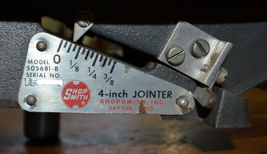

Now that you understand the Fence Locks is there any other questions you have about the Jointer? Do you still have the 1958 Jointer? If so you will notice there isn't a lot of differences between it and your 2000 Jointer. In fact the main differences are the Dust Chute, Feather Guard and Safety Upgrades. These can be added to the 1958 Jointer. There was also an adjustment stop added. That can be seen just above the depth Indicator/Logo Plate on newer Jointers as shown in the picture below. This cannot be added to older Jointers since it has a protrusion from the Base/Outfeed Table casting as part of the stop.

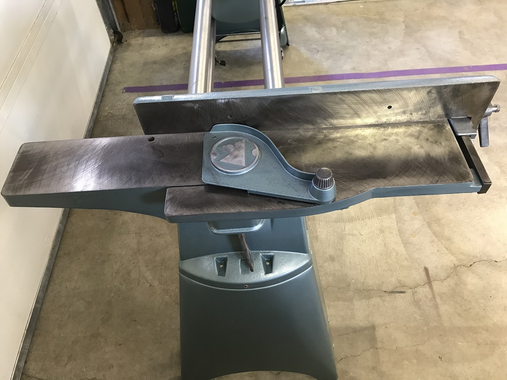

I cannot tell you if there is a weight difference. It is possible some of the castings could have had their mass reduced. Don't give up on your 1958. It can be restored unless there is serious problems with it. Below are before and after pictures of an early 1954 Jointer I restored. The first shows the Infeed and Base/Outfeed Tables already cleaned up but they were in worse shape than the Fence. I wish I had take more pictures of it before and after.

Wow Russ that did clean up nice. And that fence is close to the current condition of my old Jointer. Now that I have the Mark V and some other SPT's I have a lot of other projects I have in mind before the restore. LOL...
