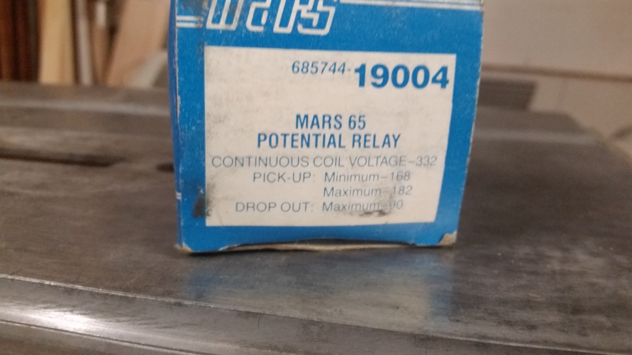

So, as speaking with the tech the motor needs to be rewired, he said that the FWD,REV,and stop switch is bad and the relay needs to be replaced. Have fixed issue with the FWD,REV and stop switch fixed. I still need the relay switch, It is a GE 3ARR3 63 relay. They have tried to get one with no luck. I'm at a loss if there are any work around can someone let me know Thanks
Re: PROJECT Mark V11 need motor
Point the tech to "supco model apr5".
or better yet, try and find an OEM relay on Ebay such as this Mars relay. Worked much better for me than the Supco.
- mars relay19004.jpg (603.99 KiB) Viewed 3353 times
