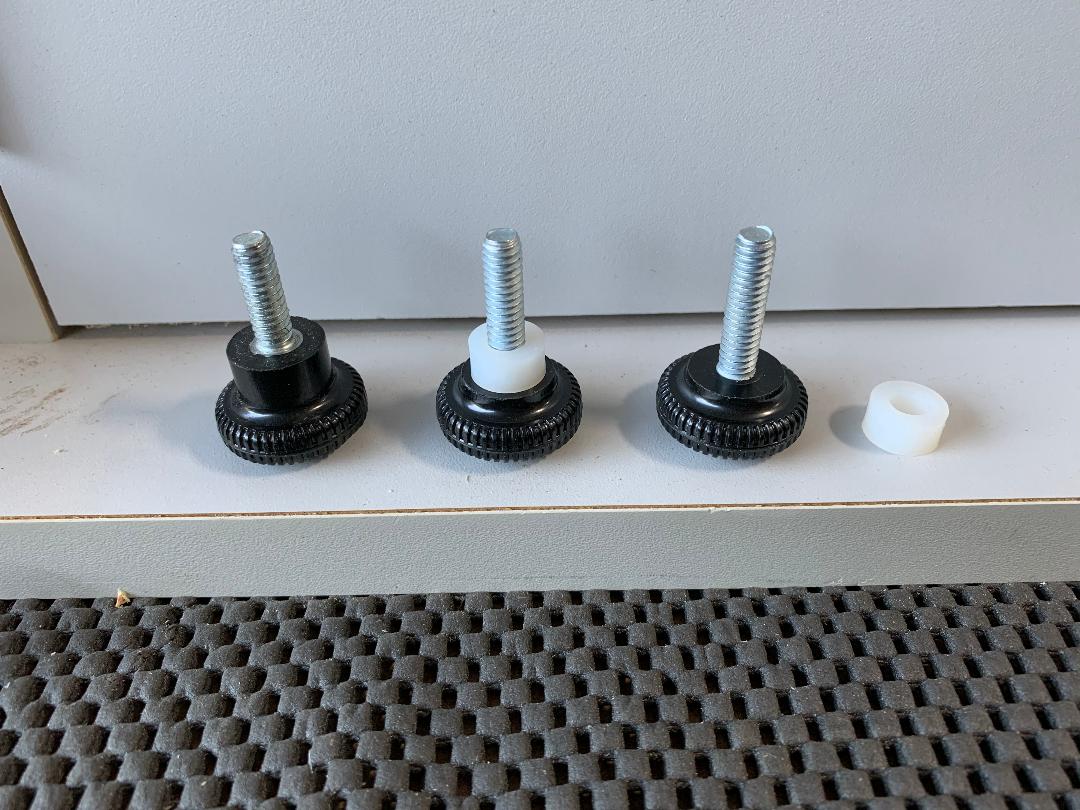

I've tried to find a replacement for a while but it was never a very high priority. Recently this subject has come up on the forum so When I placed an order from Lee Valley I ordered what looked to be close to the right knobs. The pair arrived so I was able to check them out and yes the round plastic bit looks to be the same thing. However the knob does not have the same lower profile and the screw length is to long, or is it?
In this next image the knob on the left is the original one from my 520. The middle one is the Lee Valley knob with a 1/4" nylon bushing, making it pretty much the same as the shopsmith version. On the right is the knob as it arrives.
If this interests you the Lee Valley part is a 1/4"-20 1" Clamping Knob (Male 1" stud) and they cost $2.30 in low quantities. The spacer/bushing I got a while back at a hardware store so I don't have a cost for them.(5 or more $1.95 each)
