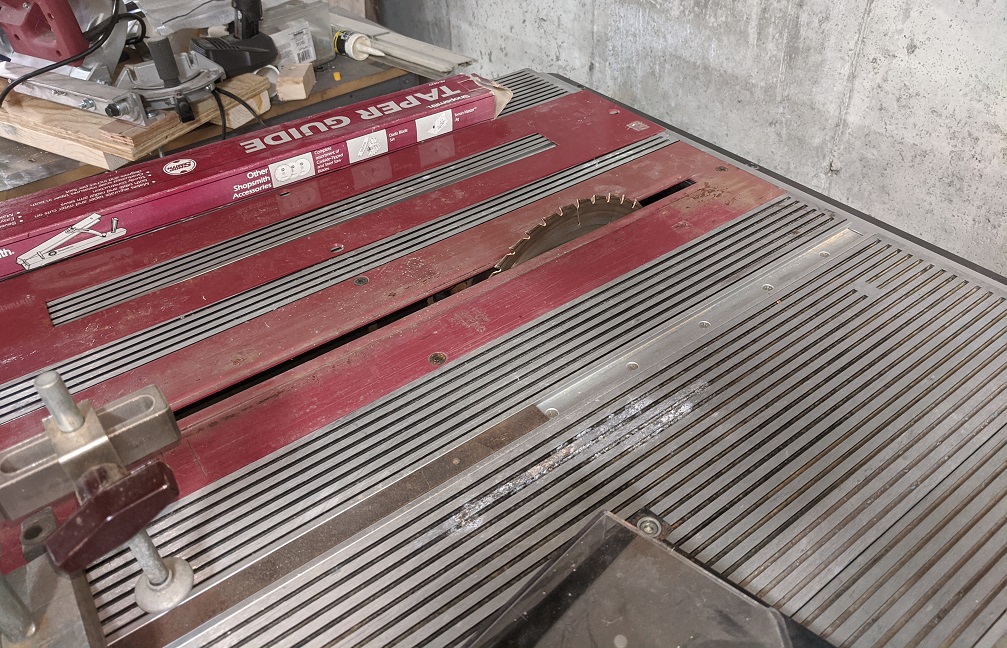

Here's my Shopsmith 2000 Ultra-shorty. I found this at least 5 years ago and only this week was able to re-assemble it. I have the 48" rails mounted, it came with 71" rails that had been cut into 40" and 31" pieces for reasons unknown. I won't need the extra length any time soon, there are several ways I can join those cut pieces if needed.
It came with the Excalibur fence and rails, two extension tables, an unused Shopsmith Taper Jig, regular and dado inserts. The miter gauge and upper blade guard are the same as the ones on my 510. The picture shows the telescoping legs attached, they aren't necessary for the short rails but I'll probably keep them there when I'm not using them on the 510 (never got those legs with the 510).

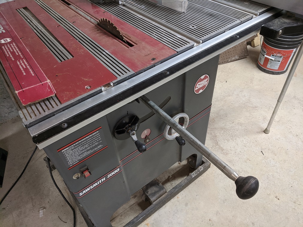

The unique feature of the Sawsmith is the sliding blade carriage. Additional pics show the blade at the furthest back and forward positions, and the carriage pull extended in the front.
This is a sturdy saw. I don't know why they didn't move forward with it. The tables have similar construction to the 510 and later tables, but are larger, 10.5" X 31". Each table piece has a Shopsmith miter T-slot. They are very sturdy and cast with several attach points underneath. These castings could have been used with the regular Shopsmith system, and the Excalibur fence is sturdy and smooth riding on the rails. The sliding blade may have been a bridge too far, it's hardly necessary if you have a cross-cut sled, and this machine will accomodate one easily. I needed to assemble this to make sure I has all the pieces. Like magic the missing lock plates I needed to attach the rails re-appeared right after I had finished fabricating some new ones so everything is there.
Powered it up, the motor ran smooth, but I don't know anything about that blade. Before any actual use it's going to get a thorough cleaning and very careful alignment.

- sawsmith1.jpg (361.2 KiB) Viewed 5418 times
- Rear blade position
- rear blade position.jpg (385.47 KiB) Viewed 5418 times
- Front blade position
- front blade position.jpg (354.42 KiB) Viewed 5418 times

The saw is now cleaned and aligned and in use. So far it is fantastic. It has a Shopsmith blade that glides through hardwood, MDF, and plywood with ease. It doesn't make much noise running either, seems to have a very nice motor. The sliding cross cut feature works fine although I will likely limit it to small stock. All the stock glides smoothly across the table and the Excalibur fence is a dream, long, solid, stable, and extremely easy to align. And it virtually floats along the table top for positioning. My regular Shopsmiths have been the best table saws I've had so far, much better than an old Craftsman, Ryobi BT-3000, and Porter Cable contractors saw, but the Sawsmith 2000 has now taken the lead in this contest. I'm surprised myself at how well it cuts, how smoothly the stock feeds, and even the dust collection works well and I only have it connected to a ShopVac right now. The table is 31" deep, just 9 more inches than my 510 table, but it seems to make a lot more difference. And I can position the blade along a 13" span in the middle of that to suit the size of the stock I'm using.
Just found something interesting on the saw. It comes with 2 extension tables, these are the equivalent of floating tables for a 510 or 520, you can place them anywhere on the rails. I just have the short rails on now so the two extensions fill up all the space. Each extension table has it's own T-track. The table I placed in the middle has the common 3/4" wide track, not a Shopsmith track. The saw came with a familiar Shopsmith miter gauge plus a simple but sturdy non-Shopsmith miter gauge that I put on the shelf and turns out to have the more standard 3/4" wide bar that will fit tightly in that slot.
So for some reason I have one track that fits common miter gauges and accessories but not the ones from Shopsmith. It's the track to the left of the fence in the picture in post #1. In it's position that far from the blade I wouldn't have much use for it, especially since I have the sliding cross cut feature on the saw. The tracks aren't cast into the tables, they're screwed in and the screws can be tightened to open up or close up the track a little, but not enough to get a Shopsmith miter bar tight in the track. I did get most of a Tenon-Master type jig with the saw and that also could fit in that track, but would be too far from the blade to be useful.

This wouldn't be a fair review if I didn't mention any of the problems, which are minimal for now, and I do hope stays that way.
This saw really could use a blade break. I've timed it from 12-14 seconds of spinning time after turning off power. That's not awful, but if you're working through a lot of cuts that's a long time to wait to clear pieces by the blade.
The sliding cross cut feature of the saw is clearly it's weak point. The blade travels along a path over 12" long, but most of the time the blade should be somewhere in the center of that range for manual cross cutting or ripping while leaving the most infeed and outfeed distance on the table. That leaves the pull rod that moves the carriage sticking out about 5" past the table rails. Just enough to bump into. I suppose I'll get used to it in time. But it is an extra control on a table saw that has to be remembered in each setup.
Another issue with this feature is holding the wood in place for the blade to move through it. So far I've been holding pieces by hand or using the miter gauge. The sides of the table aren't open to use clamps to hold down wood. T-slot hold downs could be used but there's no simple way to align the piece for cutting. Also, if the wood is held down on only one side of the blade then the piece cut off the other side is free to kick back.
I think I'm going to align that blade in the center of the travel range and avoid using the slide.
