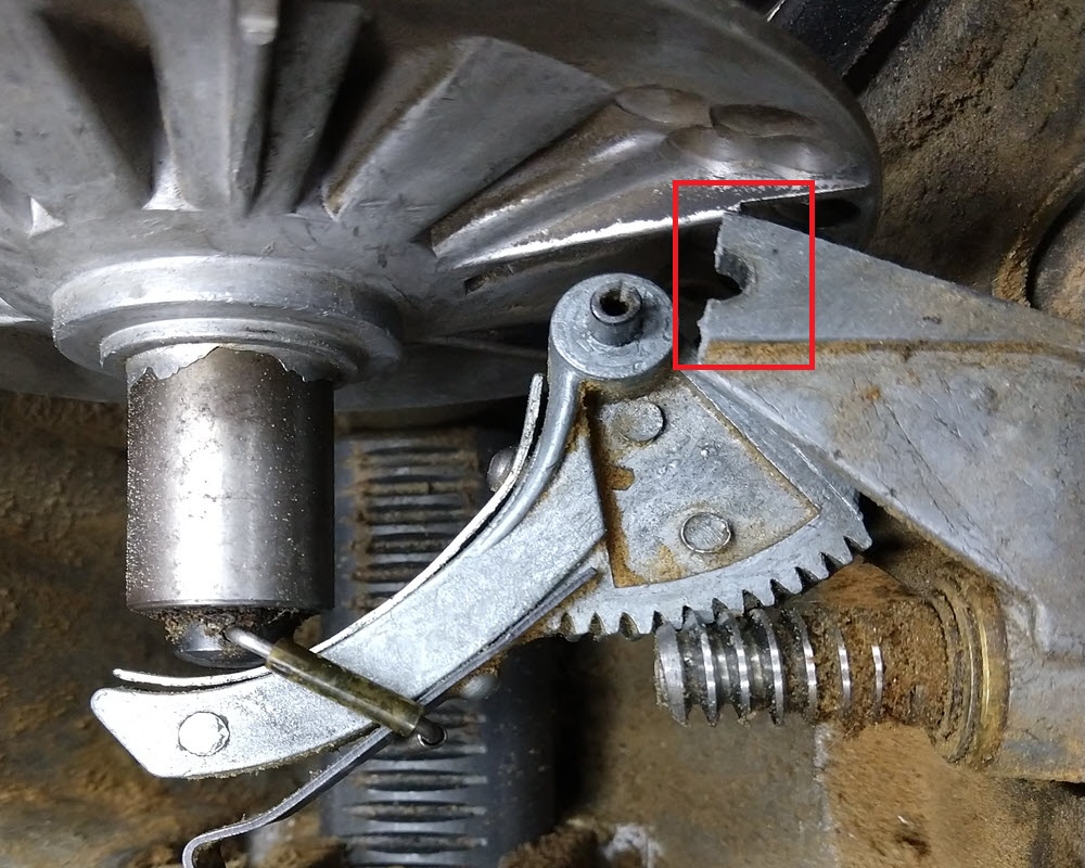

When I removed the motor from the headstock, I found an O-shaped clip broken-off and laying in the bottom of the headstock’s pan. I can’t figure out where this part came from. [This is the same ring addressed in my most recent post. I’ll assume that the ring was left inside the case by a prior owner and so, I’ll move on assuming that the broken ring was not the cause of my circuit breaker tripping and I’ll move on.]
Problem #3.
After detaching the motor, I tried to turn the speed dial to move the sheaves for oiling. It did not move easily, so I added a bit of pressure. That snapped the Speed Control Bracket casting (part #89) in 2 places—on the top and bottom extensions which have holes in each to hold the Rollpin (part #88) and Quadrant Assembly (part #87) with the Worm Control Shaft (part #87). I’ll likely have to replace this unit at some exorbitant Shopsmith price.[I am posting a photo of the broken Speed Control Bracket casting.]
I’m considering operating my machine in single speed only based on the viability and safety in doing so based on what I hear from you folks in this forum.

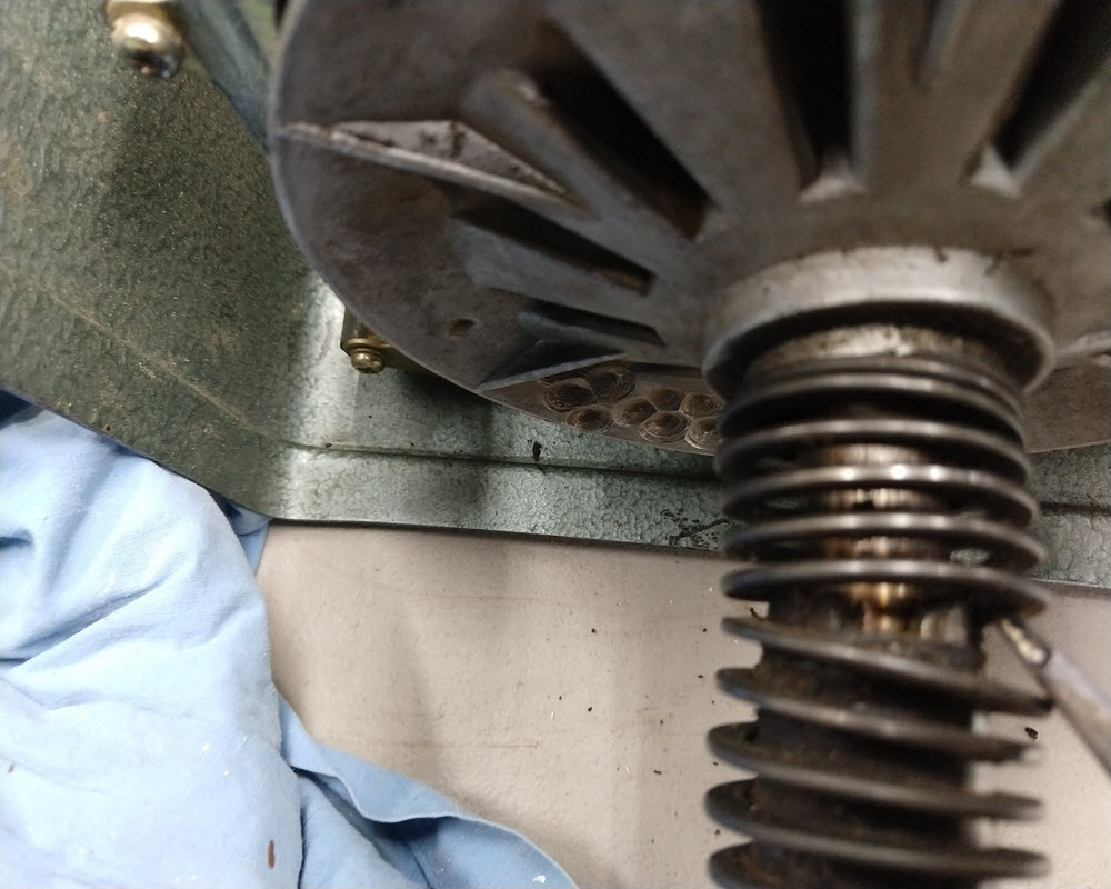

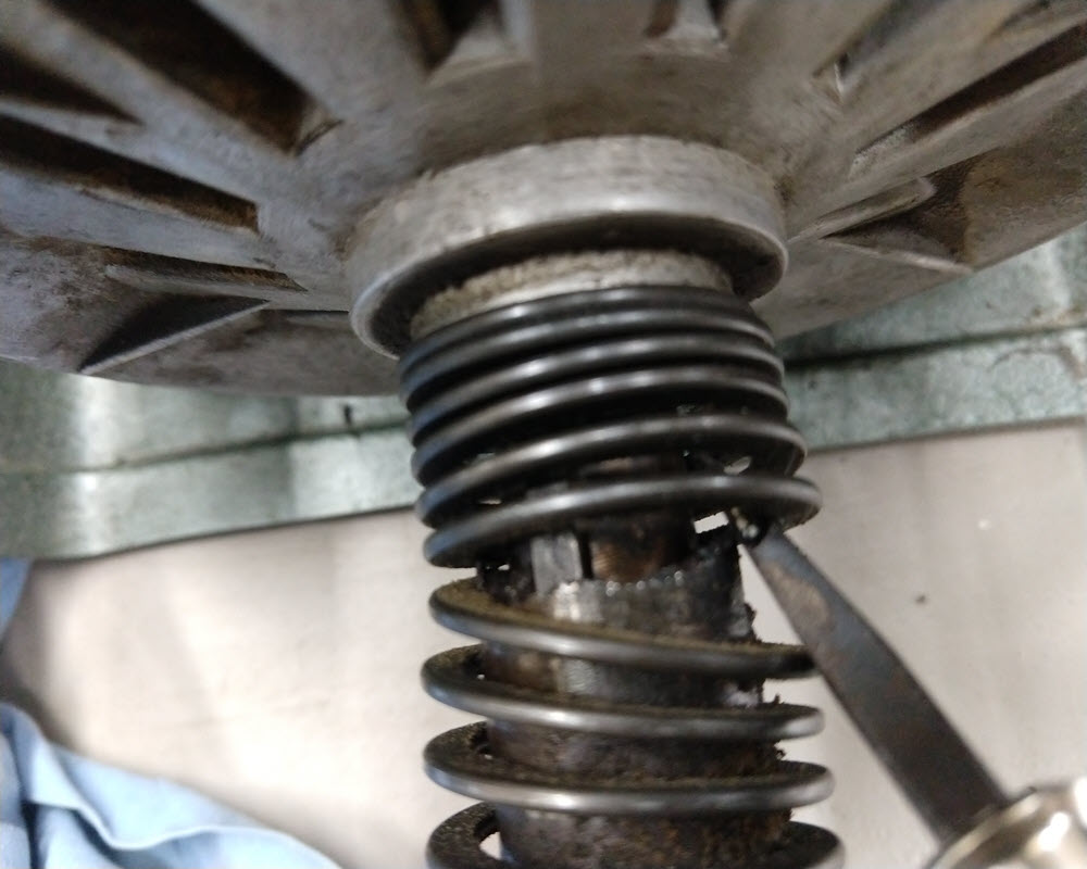

Examining the other engine shafts and sheaves, it appears that the neck of the Motor Shaft’s Floating Sheave (part # 117) has some fractures and missing fragments around its circumference and will likely need to be replaced. [I am posting 2 photos of this part.] I will likely have to replace that sheave. {That’s even more More Shopsmith parts to buy. :O)

Problem #2.
Problem #3.

Problem #2 - I think you are correct, and the control sheave looks in good shape, so it was likely replaced by the previous owner.
Problem #3 - All the crud in the quadrant teeth probably didn't help.
So worst case scenario you are looking at $140 plus shipping

Is it possible that if the motor sheave failed and caused the spring to decompress (forcing the sheaves to close therefore starting automatically at high speed), could that trip a breaker due to the start-up amps needed at a high speed?
Not sure if you can tell from photos, but when I opened the case, I found the motor sheaves as shown---sheaves are together and spring is not compressed.

A possible scenario: Speed control broken/stuck with idler pulley wide open. Floating sheave(motor pulley) fully closed. That describes 'fast' speed. Plug motor in and turn on the switch. Motor attempts to start, but the belt gets caught in the vanes of the idler pulley. Motor stalls and the breaker trips. Makes sense if the motor shop says motor ok.
So I think thee should get a new floating sheave and speed control part(s). i.e. replace the broken stuff.

Latest on Sheave replacement and circuit brkr tripping repair.
My repair parts are in plus I ER disassembled the spring-loaded parts from the end of the motor shafts sheave.
The neck of the sheave had sheared off of the sheave and had slipped to the extreme end of that shaft and had likely jammed the whole mechanism, thus causing an immediate short circuit.
I'm not much of a mechanic-- more of a woodworker, so I have some mechanic's question to you mechanical gurus.
1. The diameter of the hole in the neck of sheave is IDENTICAL to the motor's shaft, not even a 1/64th to spare. It comes in at exactly 5/8" diam.
1A. So am I supposed to add penetrating oil lubricant to the hole and shaft and tap it on w rubber mallet?
1B. Or should I use emory cloth on the shaft removing 1/128" or so?
1C. Other tips?
I do know that the sheave neck's key slot needs to align w key mounted in shaft.
2. When done with that task, I'll be swapping out the speed changing mechanism that broke, but that looks like a simple operation other than:
2A. How to zero-up the speed dial with the worm gear?
2B. Should sheaves be in expanded or closed positions on the shaft when zeroing up to slow speed?
2C. I know motor is to always be started up in slo-mo, so how do I attain that w sheave positioning on both shafts plus V-belt install?
Tx in advance for the addtl help.
