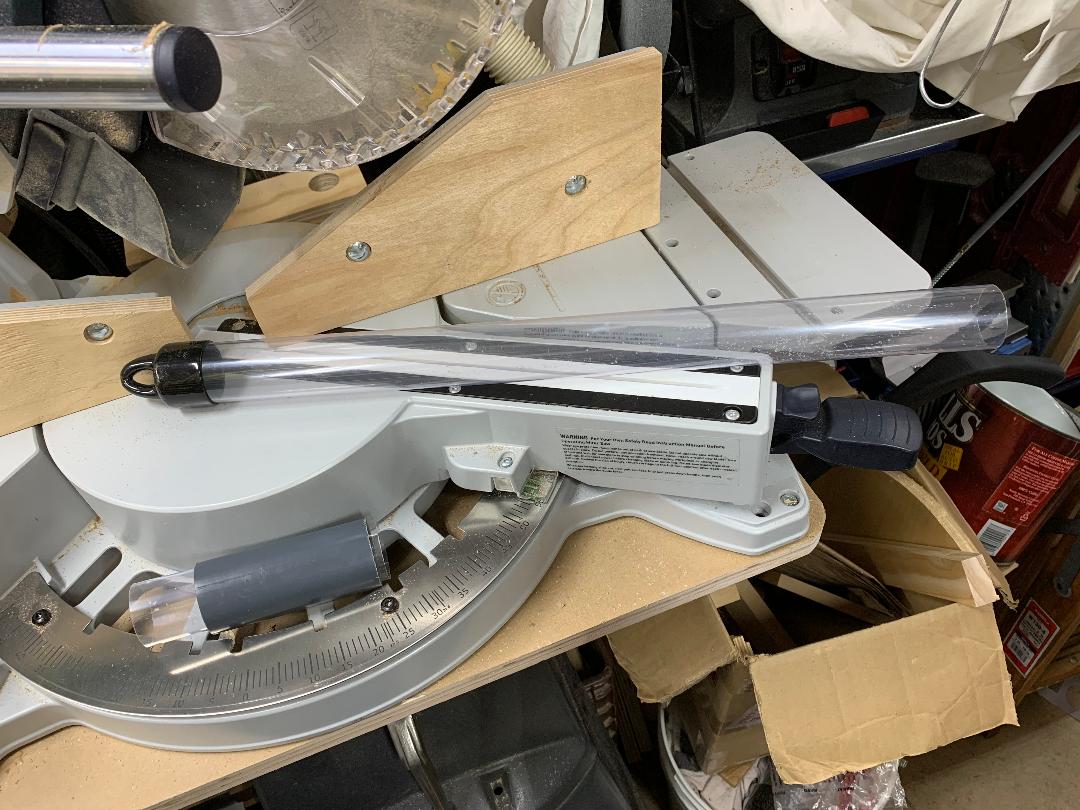

If you even purchased the 2' lengths of t-track from Rockler you will know the tubing I'm trying to cut.
I've tried with a thin hand saw and with the miter saw both have been less then wonderful.
In the end I want a couple of "viewtainer" sort of containers that are 10" long. I can do a couple more test cuts before I have to get the money cut.

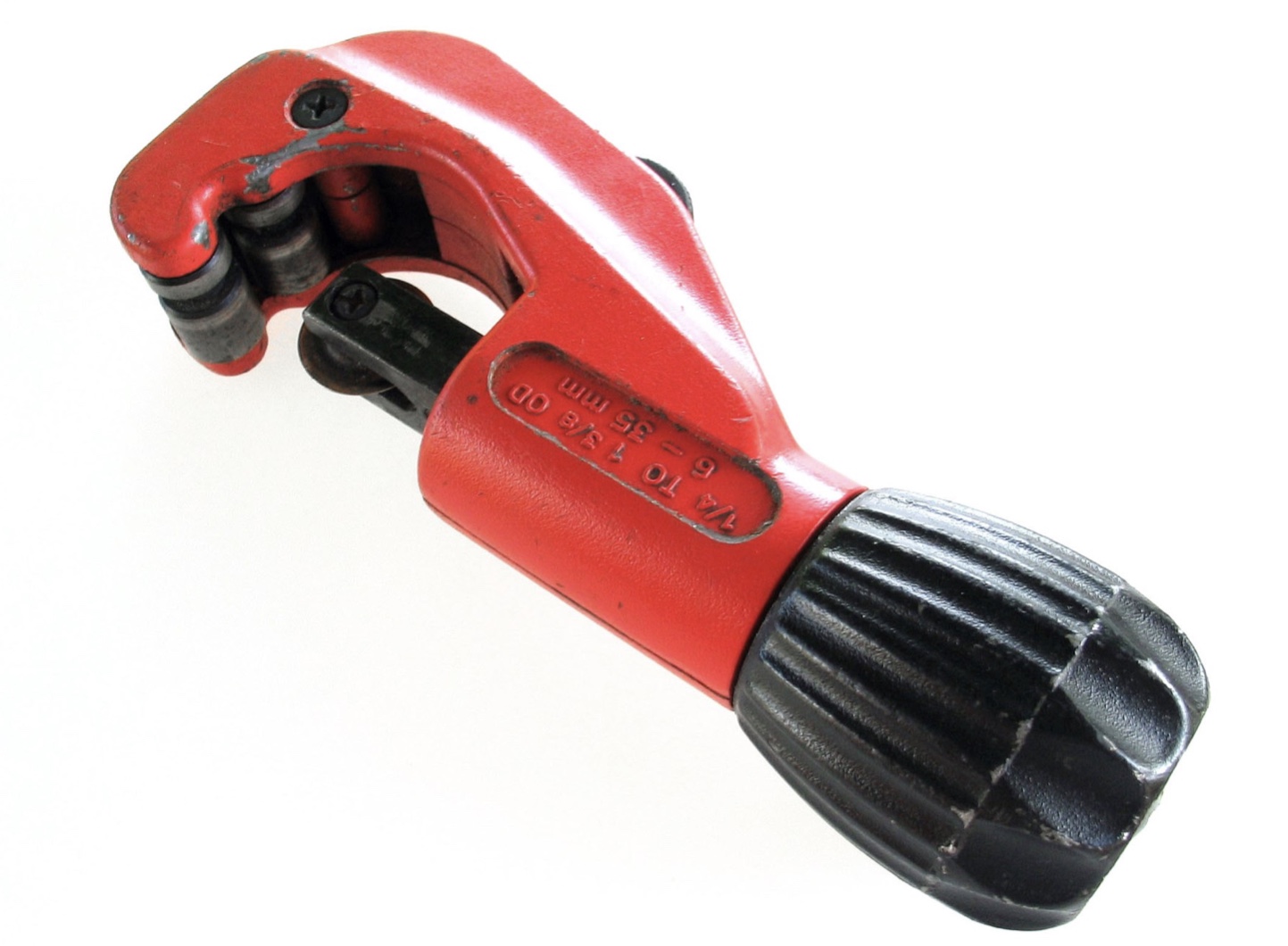

Insert a dowel into the plastic tube so as to maintain its dimension, and then use a nice, sharp tubing cutter to "slice" the plastic instead of trying to cut it.
Just my 2 cents.

I wonder if a wooden dowel inserted in the plastic as has been suggested along with a pipe cutter would give you a clean cut.
