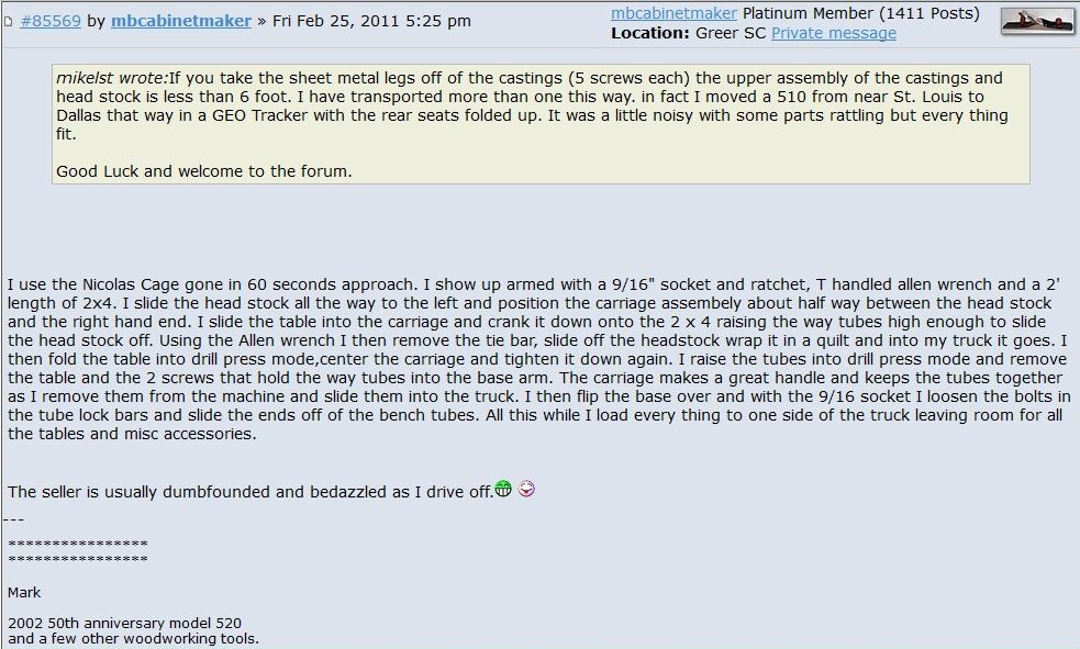

I have an opportunity to get a shopsmith for a good price, but my problem is transporting it home. Does the unit break down into smaller pieces to fit in a small suv?

The legs can be removed and that makes it much smaller. But, a lot of people have the ability to get things taken apart and don't know how to put them back together again. It might be easier to borrow a bit larger vehicle to move it than to disassemble it.

Yeah, taking the legs off will make it shorter in height (21 1/2" to be exact). Bare in mind though, a Shopsmith Mark V or the new Mark 7 is about 6 feet long (65" without the legs to be exact). It would make a Shopsmith A LOT less top heavy without the legs attached. So, a "small suv" can't be too small.

I have some reservations about separating the Headrest from the Bench Tubes that I don't have about disassembling any other part of any Mark that I can think of. After struggling with this interface trying to get the accessory mount in correct alignment to the base accessory mount, I've concluded that it is likely that the mothership has a big jig that holds everything in alignment during assembly. Fortunately everything that mounts out there is pretty fault tolerant unless you are trying for that elusive 'I want my extension table properly aligned and interchangeable between Left and Right mounts.' There are at least three degrees of freedom of movement locked down by this clamp, all somewhat further impacted when you lock down the tie bar. It is possible that I just don't know the proper technique for putting this back together.
Don't get me wrong, I have taken several of these apart for one reason or another. But I struggle every time to get it back together the way I want it, like it is more hit and miss than anything. (Except the two units I use are now a Double-Tilt mod and a shop made DT. DTs have essentially no error on this and what there is cannot be aligned out.)

Think about reassembling a Mark VII end casting on to two way tubes AND two bench tubes(with two kinky vertical clamp shafts connecting the two ) simultaneously with carriage and headstock attached to the way tubes . :D
Oh BTW the way and bench tubes are all 4 the same length.

Movie reference aside go ahead and take it apart as much as you need to transport it safely. Assembly and alignment instructions are in the manual which I recommend you get one if it doesn't come with it. Help can also be found here anytime you need it.
