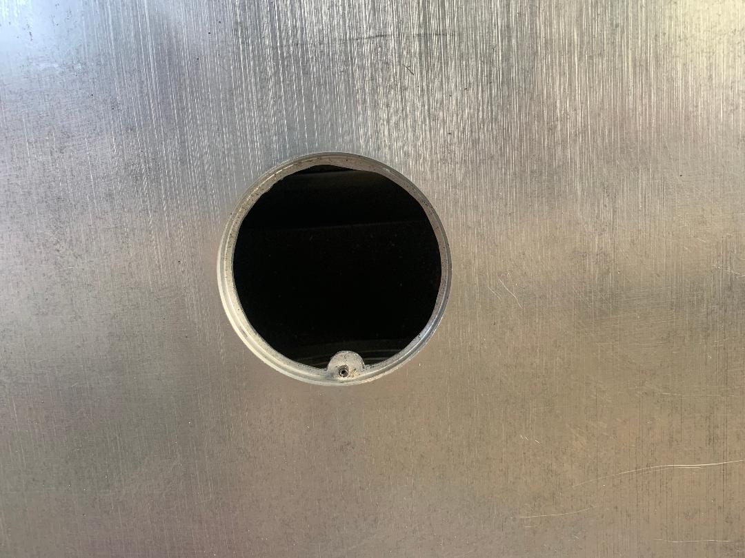

I came upon an almost unused stand alone SS scroll/jig saw. It is missing the 3 inch round table insert and have had no luck trying to find one.
Anyone have one to sell? Anyone know where I can get one?

I believe they are about a 1/4" thick and could be made from hardboard. I have made some for a bandsaw from aluminum, but they were not 1/4 thick. I was luck that I had a hole saw of the correct diameter.
If you had a 3" hole saw it should be easy to make.

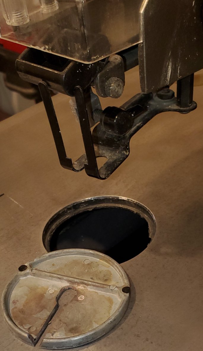

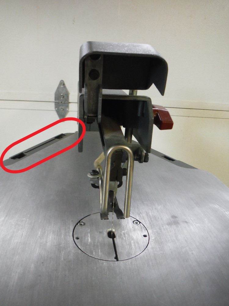

Re: SCROLL SAW TABLE INSERT
This is what my saw looks like:
It looks to be about 3" in diameter and a 1/4" thick. I see no problem making your own out of either hardwood, or plastic and even a good grade of plywood.
There is nothing very critical about the center opening or the path to it. I would make it slightly over sized then sand to fit.

Posts: 3488
As you can see from the pictures in Ed's and my posts the table inserts are different but the part number I gave before is the one for Ed's table insert. I looked at a different parts list first in a 1998 manual and found the one for yours and Ed's. That insert does look a lot like the one for the Jig Saw. The part number for mine is actually 516061 and is still available since it is the same table insert that the Band Saw with the aluminum table uses (P/N 516173.) There has been quite a few changes in the Scroll Saw since its introduction in 1987. My Scroll Saw made in March of 1990 has what they called at the time (12-89) the newer design table which included the Blade Mounting Guide and a different Table Insert Opening. It includes four leveling screws under the insert. The quick release blade blocks came out in 1994 and eliminated the need for the Blade Mounting Guide. There was a separate Blade Mounting Fixture P/N 515183 for the early Scroll Saws but that is no longer available. Maybe the Blade Block Upgrade is cheaper so the Guide was discontinued.

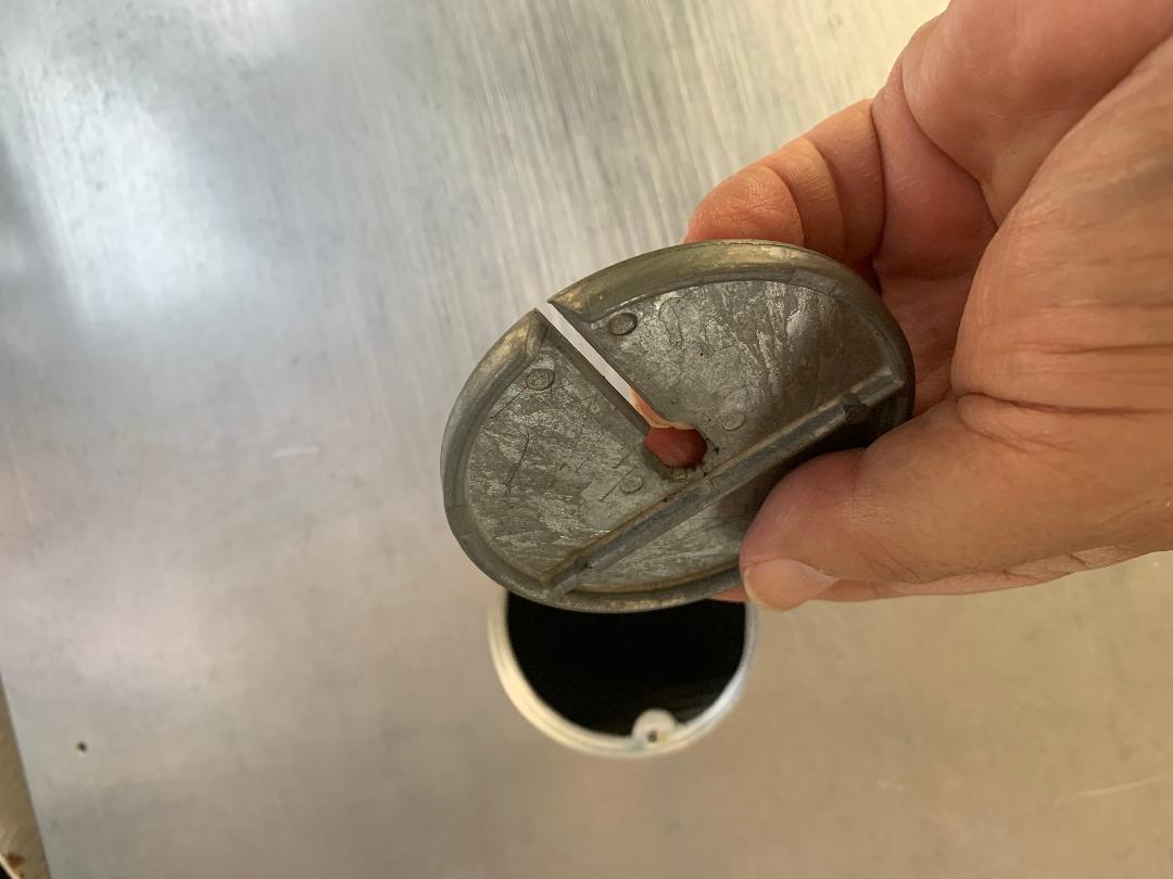

paulrussell
Posts: 667
Joined: Sun Apr 11, 2010 10:35 am
Location: Dewitt MI
Post by paulrussell »
Adding to the thread with yet another scroll saw inset variation. Mine has two rubber plugs which I *believe* were intended to friction fit the cover in place to prevent rattling.
