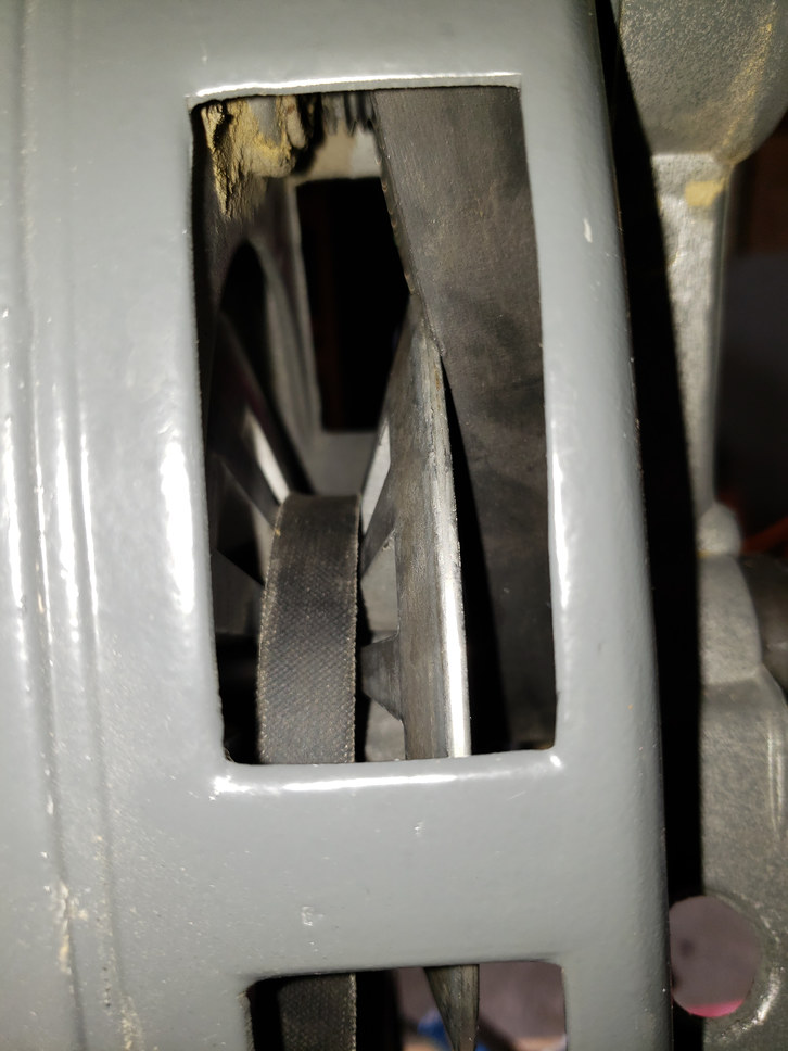

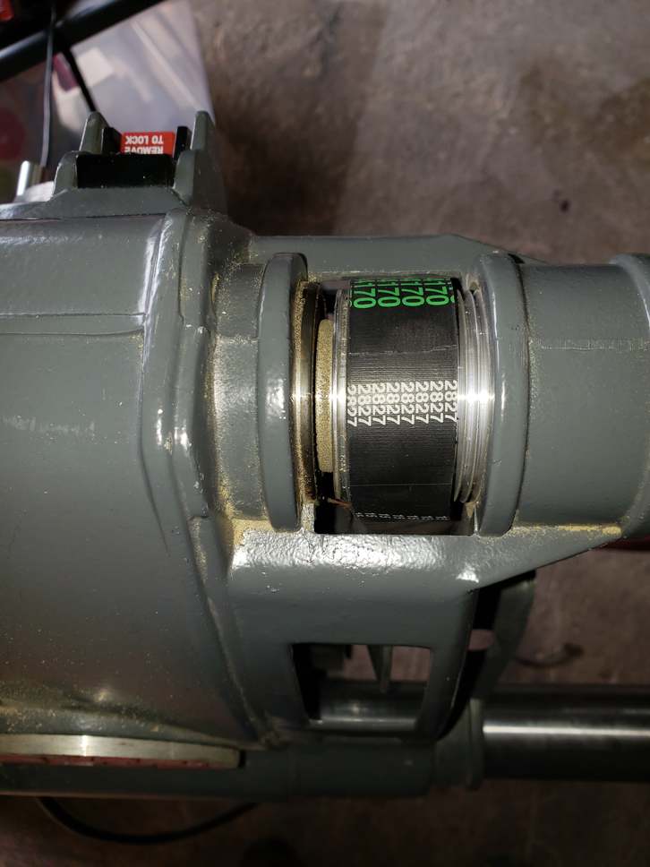

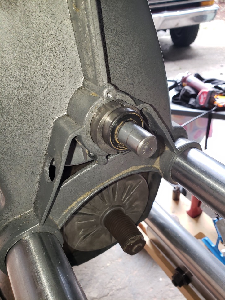

The pictures attached show where I'm at now. Any help would be appreciated, I'm supposed to building a workbench right now!

- Eccentric protruding.
- 20200920_111442-min_3_24.jpg (219.76 KiB) Viewed 12595 times
- Eccentric protruding - nut is missing, something is in there though.
- 20200920_111452-min_4_24.jpg (77.47 KiB) Viewed 12595 times
- Belt position to threads.
- 20200920_111458-min_3_24.jpg (49.98 KiB) Viewed 12595 times
- Belt against sheave.
- 20200920_111512-min_3_24.jpg (109.74 KiB) Viewed 12595 times

Basic understanding - The upper (poly-V in your case) is tightened via the eccentric to less than 1/8" play. The V-belt, lower, is tightened automatically as a function of the speed control by the spring on the motor shaft. The V-belt will normally feel loose and cannot be adjusted by feel or free play. At this point, all of your problem appears to me that your idler shaft is way out of position.
There should be a screw where you observed (you called it a nut) on a new eccentric. The screw's purpose is to retain the bearing from protruding beyond the eccentric. In your pic where you described it as 'something is there' I'm thinking the head of the screw is broken off. There should also be a screw and washer in that threaded hole above the eccentric, which keeps the eccentric from protruding as yours is. So, two screws, one retains the eccentric in the headstock and the other retains the bearing in the eccentric.

I JUST NOTICED THE ECCENTRIC HAS THE TAPPED HOLE, SO YOU DO INDEED HAVE A NEW VERSION OF THE ECCENTRIC SO PLEASE IGNORE THE STUFF BELOW THAT ONLY RELATES TO THE OLD VERSION.
1) Don't panic!
2) More 'issues' than you currently realize.
3)Terminology - Poly-v belt - motor belt - both are v-belts so different words need to be used to describe them.
4) IF the hex screw beneath the idler is the one accessed through the split in the headstock casting clamp, that should not have been messed with. It only secures the idler shaft bearing in the eccentric. Hopefully it is not protruding and jamming the eccentric.
5) You have the original version of the eccentric, NOT the newer version.
6) The drive sleeve/pulley does not appear to be positioned correctly. More about that later!
7) I am surprised that you appear to have a very old motor. It MAY be only 3/4 hp.
So the immediate problem is to get the eccentric and idler bearing correctly in position.
First task is to get the slot (the screwdriver slot) to 6 o'clock so as to get access to that hex screw. You likely have the eccentric cocked so it resists rotation. Take the motor belt OFF so as to eliminate it biasing the idler shaft etc. Then some GENTLE tapping to hopefully relieve the cocking. Then rotate the eccentric so you can 'see'(from the floor) THE BEARING RETAINING SET SCREW. Remove the set screw and VERIFY the idler bearing groove is directly in line with the det screw hole. Then reinstall the set screw and snug only(do NOT over tighten). The set screw should NOT be proud of the outer diameter of the eccentric
Now get the assembly pushed back into the headstock.
enough for now. More progress later.

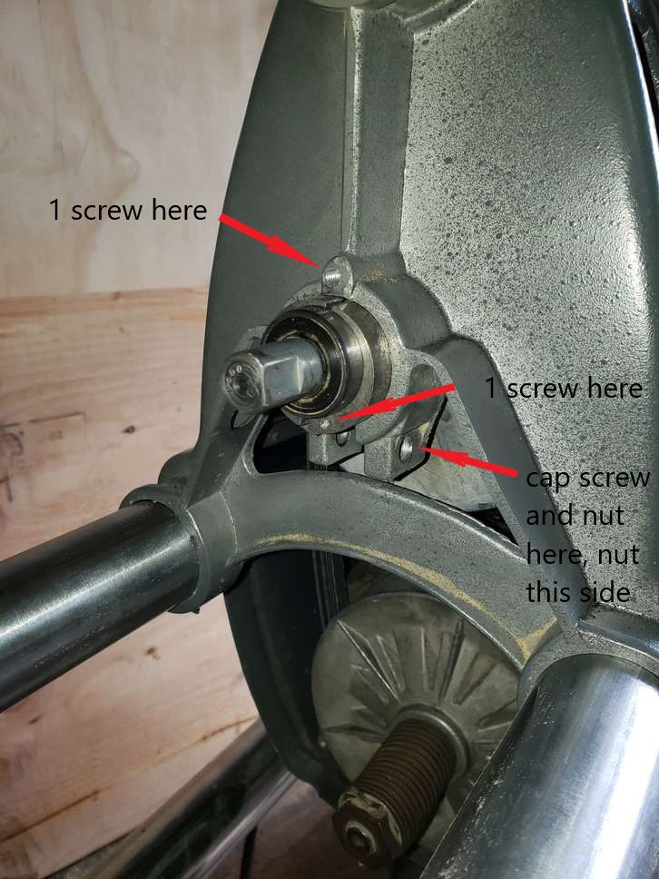

Follow the advice given above. The picture below indicates where the corrections need to be made regarding the idler bearing, eccentric and the housing screw and nut locations.
If the screw was broken off in the eccentric than it will need to be replaced. It is the combination of these two screws and the cap screw with the nut that is needed to hold all the parts in place. Some of the information in JPG's post refers to earlier versions on the Mark 5 headstock so as JPG said ignore that. When in the correct position the bearing, eccentric and the headstock mounting point will all be flush as shown below. Sorry it is the only picture I have showing that but not a good one.

GENTLY tap the outer race of the bearing in an attempt to get it back into the eccentric. The tapped hole(you may have a broken off screw in there) holds a screw the head of which extends between the od of the bearing and the eccentric thus preventing the bearing etc. from exiting the eccentric (as you now have it).
The tapped hole at the top in the headstock casting should have a screw and washer that prevents the eccentric from exiting the headstock.
The cap screw and nut which tighten the clamp portion of the headstock casting places a slight squeeze on the eccentric which has a slit in the narrow portion and that squeeze is transferred to the idler shaft bearings. DO NOT OVER TIGHTEN THAT CAP SCREW!!! There should be a split lockwasher under the nut(which is best a square nut).
In any event do not force anything.
Replacing the screws may be a challenge as IIRC self threading screws were original.

Aha! I see now, I knew the eccentric needed to be flush with the headstock but I did not realize the bearing needed to be flush with the eccentric itself as well. The tapped hole does indeed have a threaded screw in it with a broken off head. I bought the unit used, everything seemed to have run fine maybe with my fiddling with the tension of the V belt put it out of whack in a way that I can't get back.
The hardware for the tapped hole at the top in the headstock casting along with the hardware for the cap screw I have, just removed for the purposes of these photos.
I plan on ordering new belts anyway, would it make sense to just get a new eccentric (#515616) that has a good screw as opposed to attempting to move this broken one and retapping the hole? How difficult is putting on this new eccentric? Probably easier than attempting to retap this tiny hole? I have watched Shop Sessions #23 and have a better idea of working with the headstock, however I believe in his demonstrations he has the older style eccentric.
