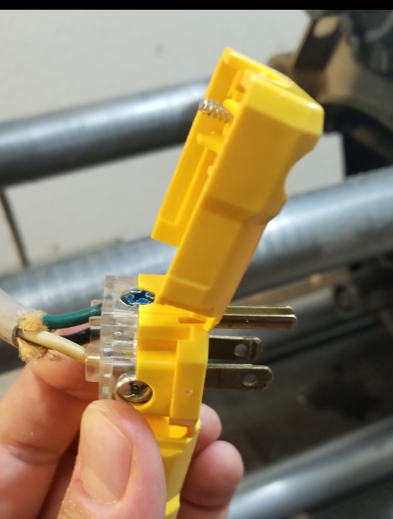

- SmartSelect_20200927-142429_Gallery.jpg (417.7 KiB) Viewed 2648 times

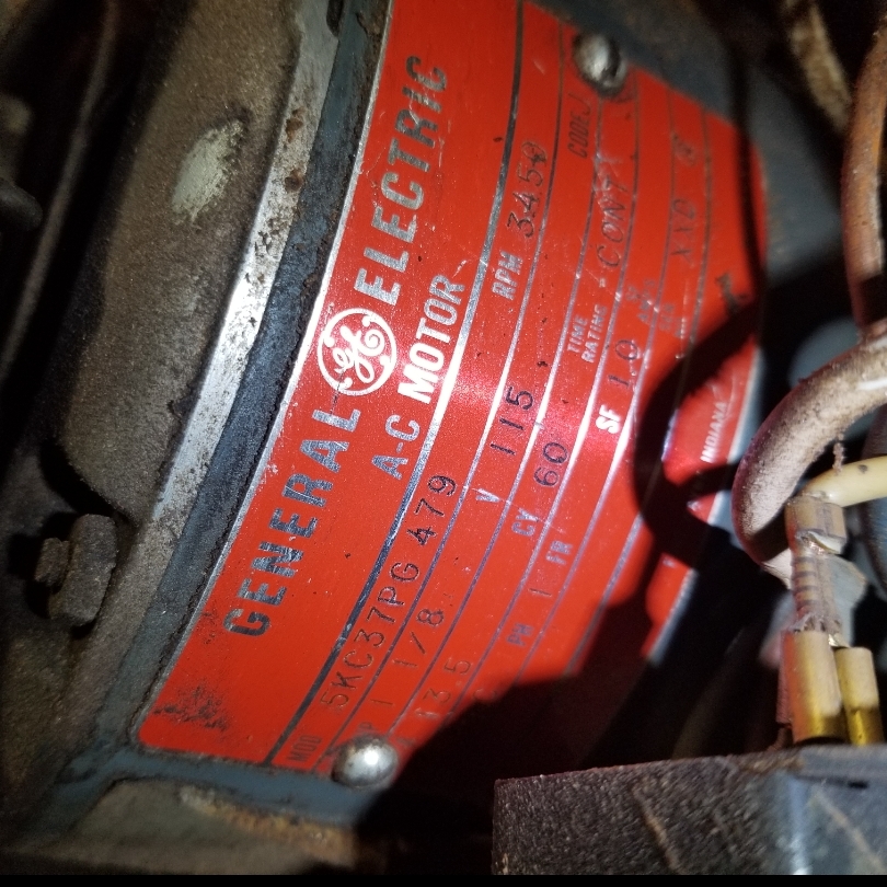

Ok, the motor is GE, model 5KC37PG 479. The SOB relay plate has now come off. So that was probably the culprit. Going to test.
- SmartSelect_20200927-145534_Gallery.jpg (486.02 KiB) Viewed 2643 times
