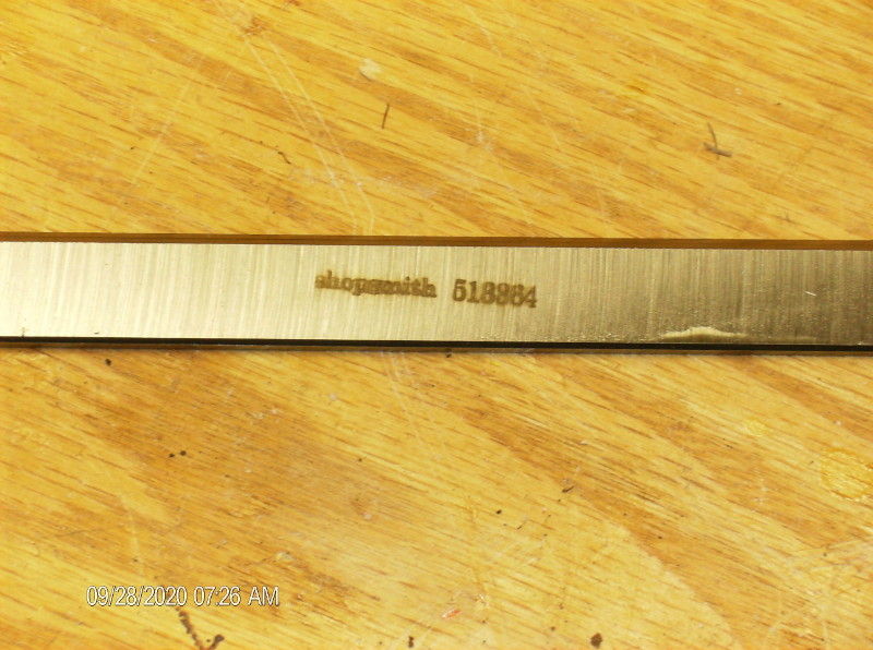

The Shopsmith user's manual admonishes against the use of non OEM planer blades. The ones I have came with my Mark V. I didn't even know I had them until I had a chance to look over a lot of miscellaneous components which were included in my purchase. Is anyone on this forum able to identify these blades as OEM blades. There are no markings of any type on either side of the blade. The only number, 365523 or 3651523 I found is the one on the rectangular shaped box and I am not certain that it has anything to do with the blade . Do any of you Shopsmith planer users use non OEM blades in your planer? I did send a message to the person I bought the Mark V from but haven't heard back yet.

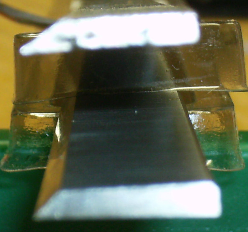

I tried taking a picture, but my camera refuses to focus close enough for something this small. The upper blade is a generic flat blade for a standalone imported planer. The lower one is a tapered Shopsmith blade for the Shopsmith planer. Even with a bad picture, you can see the taper of the Shopsmith blade.
- blade.jpg (164.12 KiB) Viewed 5058 times

The profiles look very similar but mine does look like the bottom photo. Thanks to all for responding to my inquiry. There is a set of new set of Shopsmith planer blades available on Ebay, with a buy now option, for $40 dollars compared to Shopsmith's current price of $130 and they are labeled with a Shopsmith numeric designation, 505640 which includes a set of three. I can also read tha Shopsmith name and number, 502902 on the blades. My Mark V was purchased by the original owner in mid 1980 timeframe so maybe this reflects a change in terms of the way Shopsmith labeled the blades. It's also confusing because there are two numbers used to identify the same product. For someone that knows the history of Shopsmith from their inception, I am sure they could explain how Shopsmith naming nomenclauture was derived. It's is very confusing for a novice to buy on the secondary market and not be able to know if a particular part is compatible with a given system. I have owned my system for a year now and I am still reading Shopsmith manuals, watching Shopsmith sponsored videos etc. I have learned a lot but it's going to take some time before I feel safe and competent enough to actually use the system. I have a Shopsmith planer, bandsaw, jigsaw, beltsander, and jointer, items which I have never used in my lifetime. I have also upgraded my Mark 500 to a Mark 520 table configuration.
