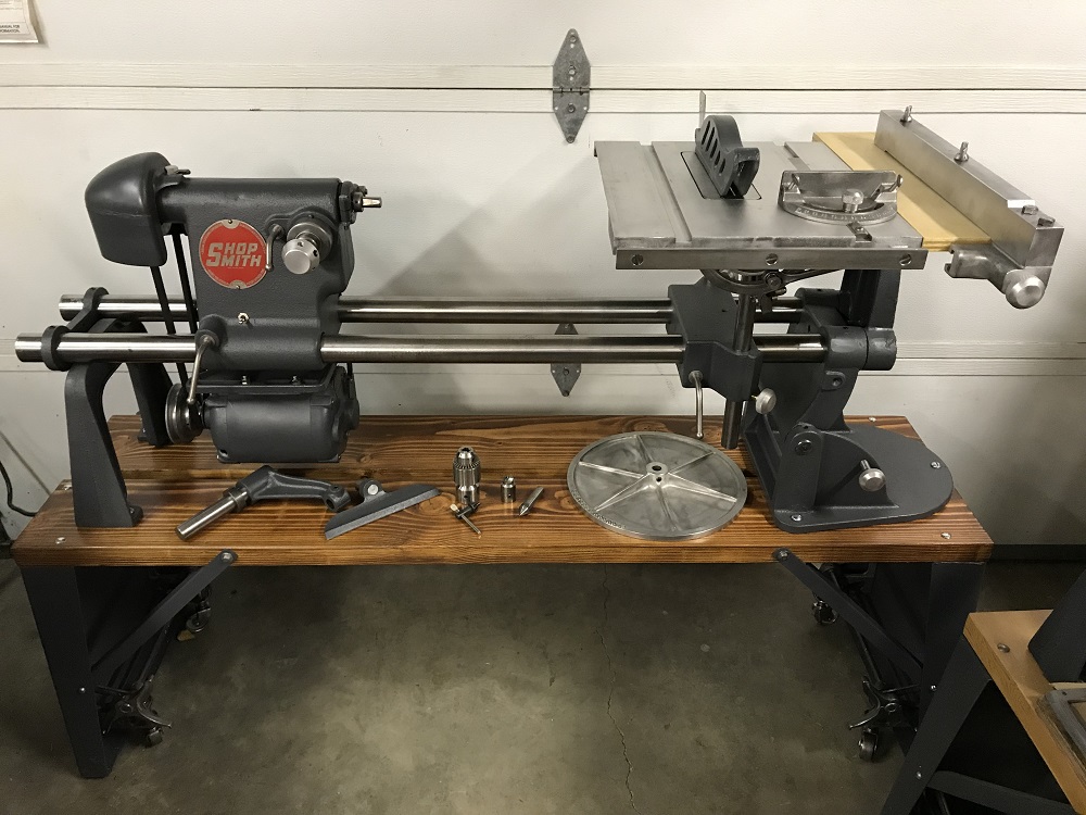

It is easy to tell what Shopsmith it is by simply looking at the Logo/Serial Number plate that is mounted on the front of every Model 10. It will say Model 10E, Model ER or Model 10ER. ER and 10ER are both Model 10ER's. Below is a picture of one of my Model 10E's. Note the red and silver Logo/Serial Number plate on it.
1077 restored 11-14-18.jpg (234.12 KiB) Viewed 15677 times
The picture above shows all the parts that originally came with the Model 10E except the arbor. Benches were also extra and to be supplied by the purchaser.

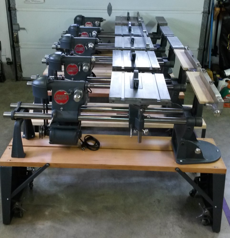

4708-8865-55582-R57376-R64000 full.jpg (177.55 KiB) Viewed 15677 times
These are all Model 10's I have restored and having 5 done at one time made for a great picture. The front four have since been sold.

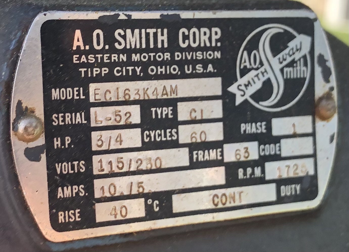

So thank you again for your response. I’m going to include the only two pictures I have of it. Do you have any thoughts of this model? I’m not seeing where it says that it’s a 10e for sure. Maybe I just don’t have the right picture that shows that.
One of the issues will be transporting it... that thing is heavy!
But one question I had was whether or not this model would work with a dado blade? What would be needed to use that, if it’s possible?
Thanx again!
Couldn’t get the whole picture to fit in this forum
So, doesn’t seem to have the model number on it

It is a ER with that metal aux table. and I've used a dado on mine. You will need to make a throat plate to pass the dado blades through. and you've got a 3/4 Hp instead of the 1/2 HP used on most so that is a plus. and you need the long arbor for the dado stack.
