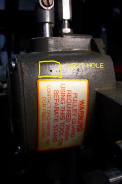

I use transmission oil as you do but I did one more thing. There is a small hole for air relief on the front. Using a fine wire I often make sure it is clear of crud. This keeps air pressure from building inside on the down stroke. It may not be much but does keep oil from being forced out through the seals. Not 100% but manageable with a rag wipe.

Where exactly is this small air hole?

Not easily found. It is on the side opposite the support arm. A hand lens might help. It does not go directly into the casting but takes an indirect route. Nearly all compressors, lawn mowers etc have such a means of keeping internal pressures equalized to atmospheric pressure.

The vent hole is small. Here is a photo of the area. I hope this helps. :)

Excellent....thanks for the photo! I'll try to clear it out and see what happens.

I cleared the hole...no change. Looks like the seal is shot...i may try the stop-leak stuff.
