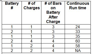

I have an 18v NiCad DeWalt drill that I bought before the 20v LiIon came on the market. Of course they changed the battery and charger so you couldn’t use it in your 18v drill. Buying a new Nicad was out of the question. I looked for an 18v LiIon replacement and found this one on Amazon. It’s from Energroup and reading the ratings decided to buy two. The seller says that you shouldn’t use these with any charger that doesn’t specifically say for LiIon batteries. Some buyers tried them on their existing chargers with mixed results. Reading the reviews I concluded that the bad reviews were because they didn’t know how to charge them. To charge put the battery in the charger and the red light on the charger should “flash” and the first bar on the battery also flashes. When charging stops the red light is solid.
This table shows the results from charging both batteries. The first charge for both was a single attempt with 3 bars showing and the run time that resulted. The second attempt was different. I attempted only 1 charge on battery 1 to see if there was any improvement in the run time; there was. On battery 2 I charged it until all 4 bars showed charge. That took 4 attempts. Red light is solid, remove the battery and re-insert it and the red light flashes; repeat until fully charged. On this one the run time is 60 minutes. On the 3rd charge I charged only battery 1 and the run time is 58 minutes. I don’t know how long the batteries will last but this is quite acceptable. Just charge them the way I did.
