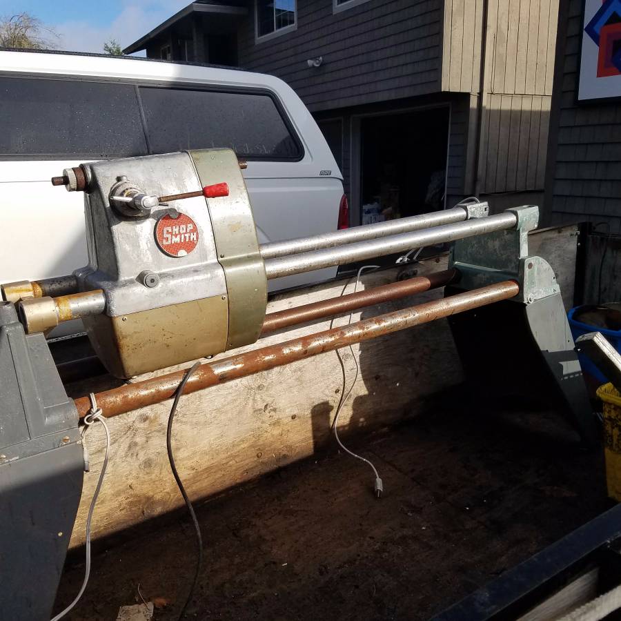

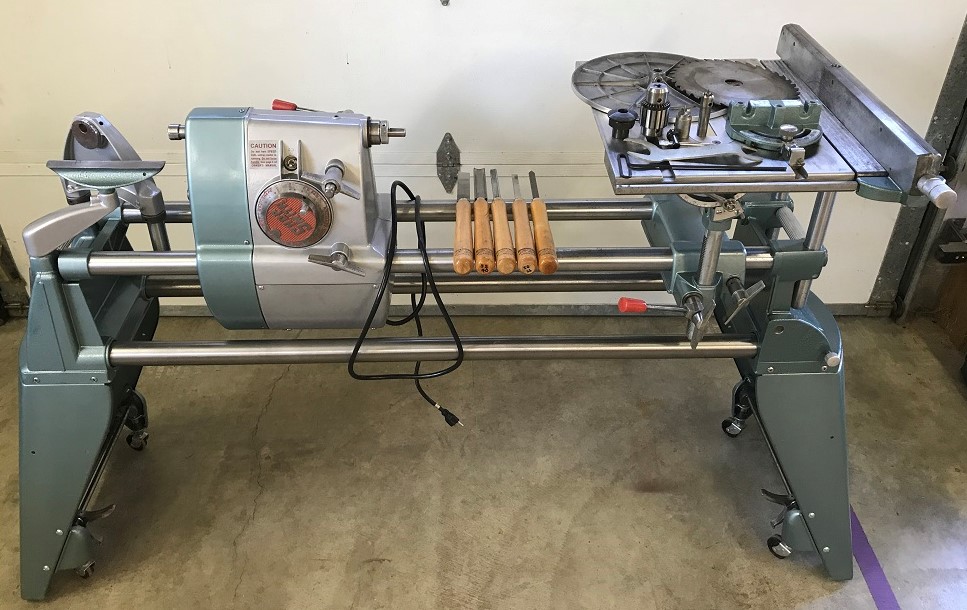

Doing maintenance and trying it first may be a good starting point. That way you will know if there are any specific problems you need to address as you restore it. Even basket cases can be made like new again. Below is a Mark 5 Greenie I restored a few years ago.
It looked like this when I picked it up.
There was rust inside the headstock too. The Quill had rust pitting so it needed to be replaced. There was quite a number of damaged and missing parts that needed to be repaired or replaced. What you see in the before picture is the same parts as in the after picture except the Quill and some hardware.

Oh, Russ, by the way, those caster wheels on the machine you restored... are they original? Mine does not have them. Is there somewhere I could buy them?
