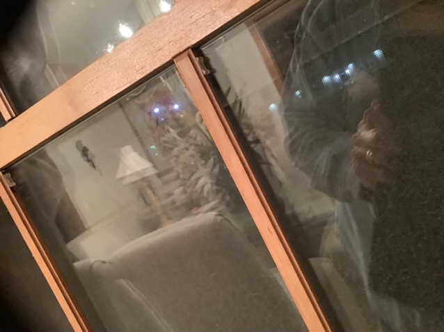

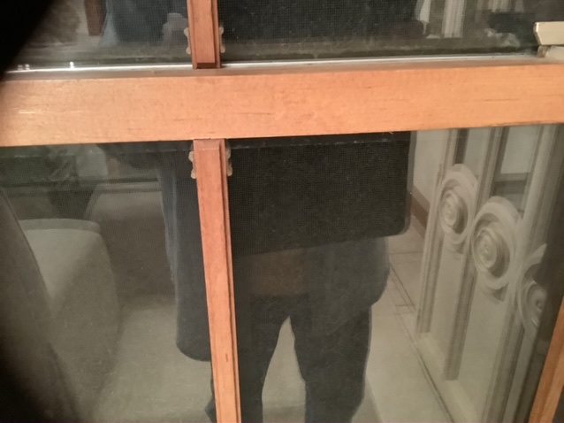

The grids have a sliding pin on the ends that keep them in place on the inside.
- 19E89F15-C592-4BA4-9DE1-7339160F69F9.jpeg (73.55 KiB) Viewed 1596 times
- 61BDF3A2-0F53-4326-BDFD-F9EEAB5AA3CD.jpeg (84.51 KiB) Viewed 1596 times

Late to the discussion, but I would secure the vertical members by a very small(< 1/8") pin and hole at the bottom and a small screw through the top into the grid. Horizontal grids attached to vertical ones and the ends simply float.
I am assuming wood sashes.
