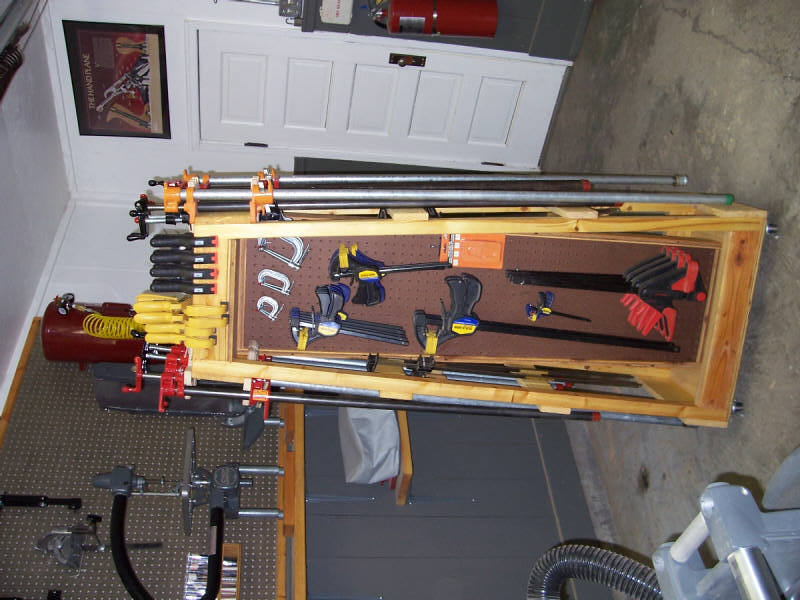

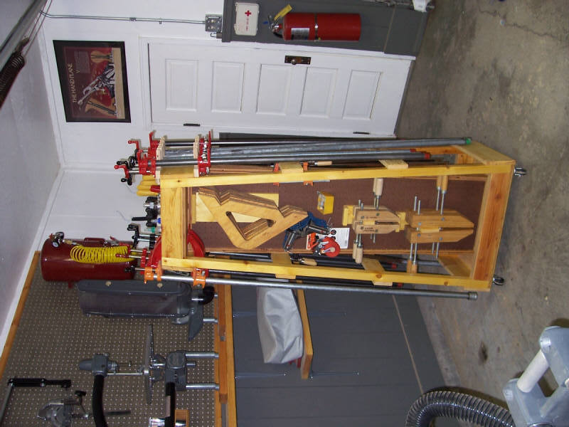

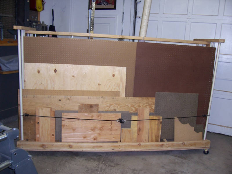

Attached are photos of my 2 latest projects - A Clamp Cart and a Lumber Cart.
The Clamp Cart is a collage of different ideas I picked up from Woodsmith, Shopnotes and Wood magazines.
The Lumber Cart is my rough intrpretation of an idea sent into Wood magazine a while back.

Could you snap a couple of photos of the clamp cart with all of the clamps removed? (Just kidding :D ) But I do have a couple of questions:
I think I see bar clamps hiding under the pipe clamps. Are they clamped to the back of the cross pieces that the pipe clamps a resting against, or am I not seeing some other part of the cart?
What are the approximate overall dimensions of your clamp cart?

perryobear wrote:Hi,
A pair of useful projects!
A clamp cart is high on my list of thing to make for my shop, thanks for sharing your work.:)
Regards,
Dennis
Dennis,
The overall dimensions are:
Top: 17" x 16"
Bottom: 25 1/2" x 16"
Height: 60 1/2" (not including casters)
This clamp cart was designed to fit a specific location in my shop. If possible, I would recommend increasing the width of this cart to be able to include additional pipe clamps (or whatever clamp you have).
There are bar clamps are clamped to the back cross pieces.
I am pleased with using the pegboard interior. I have purchased additional, smaller clamps, and have rearranged the the clamps in this area at least 3 times.
Thanks for your interest.

I gota ask if the clamp cart is top heavey with such a small base. Does it feel like it wants to tip while rolling? I suppose if you took care not to load the heavey stuff up high it might be alright. Nice work thou I must say,,,:D
