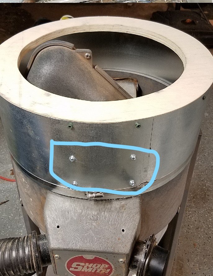

After watching Stumpy Nubs video on modifying single stage dust collectors for replacing filter hoods with canister filter, I decided to give it a go. Dick Wynn at Wynn Environmental sent me these pictures of a conversion he saw.
ShopSmith canister conversion.jpg (171.01 KiB) Viewed 7114 times
It all makes sense to me except I can't figure out the purpose of these four screws. Any ideas?
Inkedcanister filter Wynn environmental_LI.jpg (153.08 KiB) Viewed 7114 times
By the way - Dick doesn't know how this was constructed. He does recommend their 35B222NANO filter.
Looks to me like I'll need a piece of sheet metal about 12" x 60" to make the shroud. Any ideas where to source that? Maybe a HVAC comp;any?
