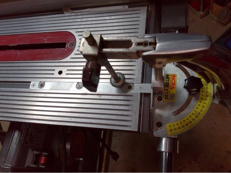

Here is a pic of it from another forum member. I don't know if this helps to compare:
viewtopic.php?p=267634#p267634

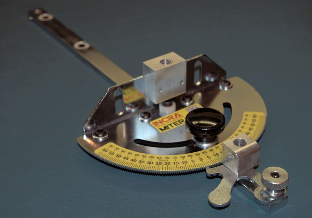

Pics? The SS web site describes the Incra as "with adapter" to mount the safety grip. Their pic looks like this, I assume the aluminum blocks are the adapters:

Thanks to both of you. The pictures do help. They show me that I have not been trying to fit it all together incorrectly.
In the image posted by DLB I see a slight difference in a part. The rounded corner in that small aluminum block in not rounded on the block that came with my V120. That corner on mine is just a bevel but I cannot imagine how that could be my problem.
It appears to me that if the horizontal hole in that aluminum block was just a bit larger that mine would come together. It is right there where I have a problem. A screw (in the Safety Grip handle) is suppose to go through that hole but does not line up. I cannot install that screw.

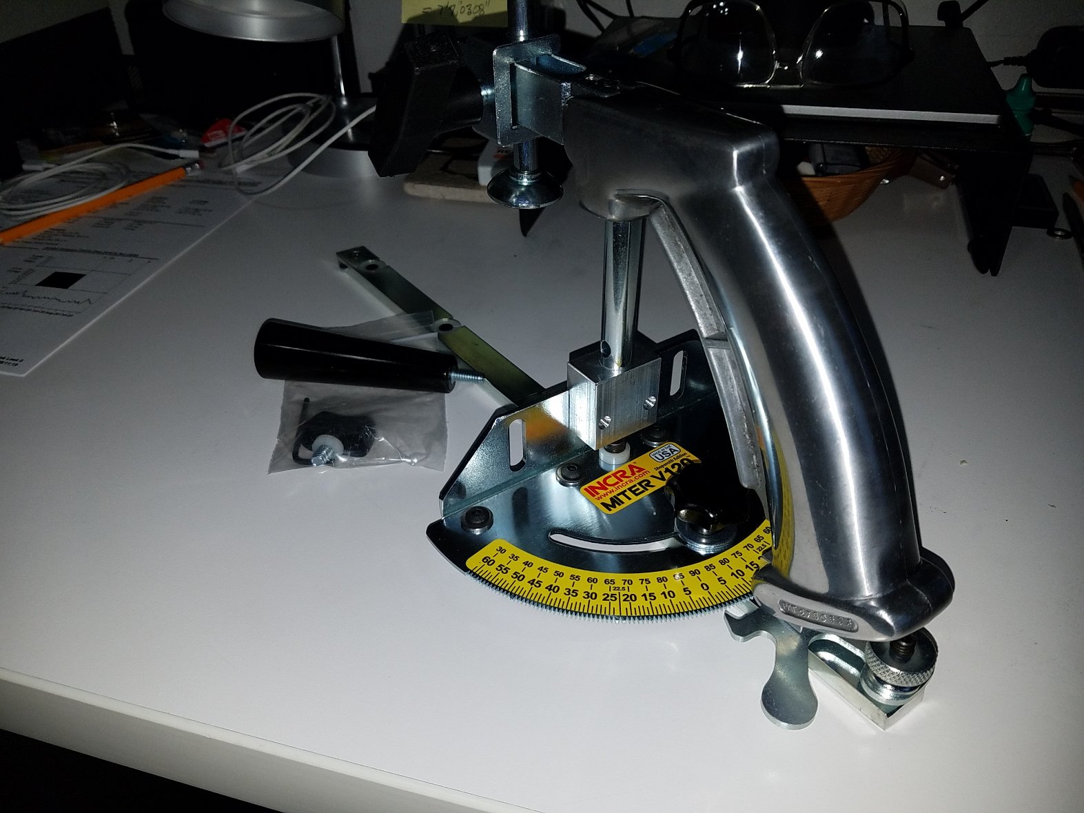

OKAY I now have an Incra Miter Gauge V120 with Shopsmith Safety Grip.
Gorilla tactics, in this case, worked. I loosely assembly the adapter parts, aligned the screw hole in the handle with the hole in the aluminum block and then tightened every thing down. As I did this, I heard a snap but everything appeared to be in place so I continued. Once secured, every thing appears to mate up so I am declaring victory. I now have two more miter gauges than I can use at any one time. Don't ask why. My wife already did that.

I've got to reassemble mine and follow the instructions received (both here and from Shopsmith). Didn't square the face. :mad:
Re: Incra V120 with Shopsmith Safety Grip
I removed the safety grip, checked the fence for squareness to the table, readjusted tension in the miter slot and then reassembled. But, prior to reassembly, I mounted the aluminum block and tightened the screws down (no gorilla tactic). Yes, the aluminum block is not firmly attached. It does move "a little". I modified the assembly sequence. I left the aluminum block loosely mounted (backed out the two screws). I then attached the heel of the safety grip to the other aluminum block. I then attached the threaded rod (safety grip) to the aluminum block and secured the two screws holding that block. All went well.
There is nothing wrong with the V120 or the Safety Grip. The assembly process went a bit different than I remember but all is well that ends well. :) :) :)

Dusty, I have had my V120 set up with the safety grip for a few years. It is great. You will enjoy the simple accuracy of the unit.
