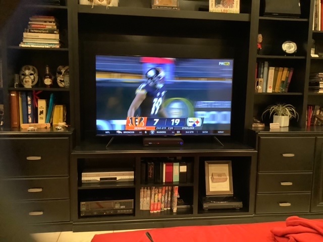

I have a 54” tv on the two original legs it came with and it stands about 3” from bottom of tv to shelf it’s on. I would like to raise it 4 1/2” so that it is centered in bookcase. Any ideas on individual lifts for under each leg? Suggestions would be appreciated. My better half would prefer that they would not be too obtrusive. HELP!

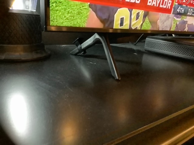

wrmnfzy
Posts: 758
Location: Destrehan, LA
Re: Raising a tv
Post by wrmnfzy »
Your wish is my command.
Posts: 6585
Re: Raising a tv
I see the height difference but, can't see the legs in your pictures.
rpd
Posts: 3045
Location: Victoria, B.C.
Re: Raising a tv
Post by rpd »
jsburger wrote: Sun Nov 15, 2020 6:03 pm I see the height difference but, can't see the legs in your pictures.
Took me a while too. :)
They slant out to the side at 45 deg, in the first picture one is below #91"s left elbow .

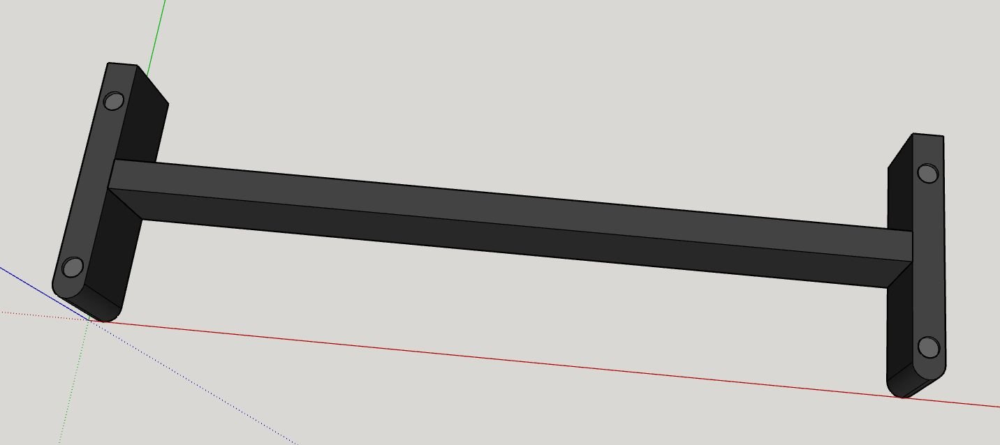

Re: Raising a tv
A simple solution would be some 2 x 6 's cut down to like 4-3/4" then four holes for the existing legs to set in that are 1/4" deep. Now so it doesn't tip over you need to connect both sides together, again the 2 x material. Something like this:
tv stand.jpg (41.29 KiB) Viewed 1391 times
You can paint it some dull black or semi gloss black to hide it more. Perhaps rounding the front edges as shown or not.....

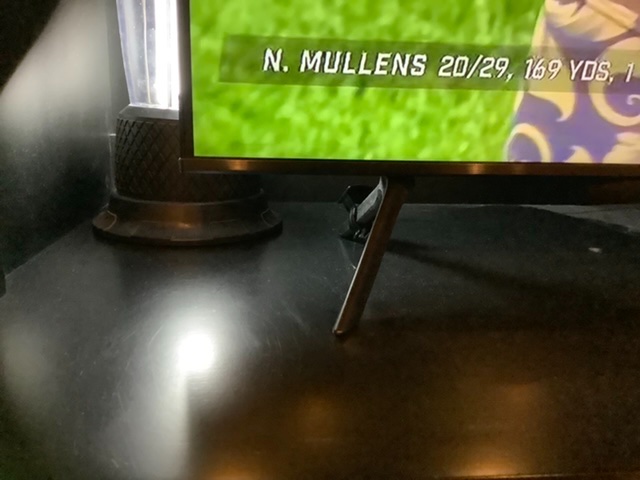

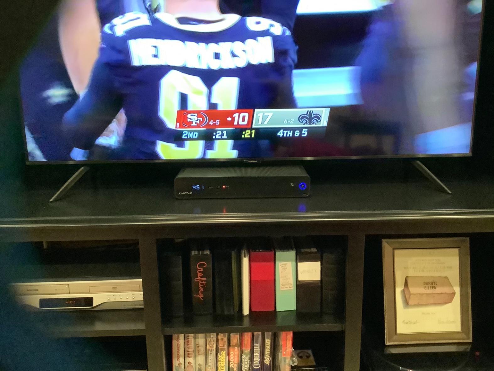

wrmnfzy
Posts: 758
Re: Raising a tv
Post by wrmnfzy »
I put a light behind it and here are 2 better pics
