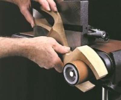

Check the picture of the belt sander on the SS web site. It is actually mounted on the left side with it projecting towards the back. It needs to run in that direction for the dust collection to work.

I may not have noticed that it's actually on the left because I assume pictures are taken from the front. The position of the table should have given it away!
I can see how that the rear projection directs the dust rapidly toward the manifold when working on the platen side, but the dust has to take the long way around whenever you're sanding on the slack side or against the idler roller end. I can reverse that on the PowerPro machine though this is destined for permanent-ish mounting on the shortie I'm preparing with an ordinary headstock.
I think I want this mounted on the right side, projecting back so the platen is on the front in vertical mode. That should work exactly the same for dust collection and leaves the left side available for other accessories.

Yes, since the drive shaft projects out both sides that can be done. On either side the sander has to project towards the back.edma194 wrote: Mon Nov 16, 2020 5:13 pm I may not have noticed that it's actually on the left because I assume pictures are taken from the front. The position of the table should have given it away!

Because of it's design the Belt Sander can be powered by either side of the headstock. It should only be run in the forward direction with the backing plate forward. Running it in reverse not only sends the sawdust up into the air it also has the upper tension/tracking drum running backwards. That's a problem too. The Belt Sander is designed differently than the Strip Sander which can run in reverse.

I spent hours over the weekend working out how that crazy idler tension mechanism works but didn't think about this aspect of it. So I guess if it's running backwards the roller puts a force on the spring relieving some of the tension so it's not being driven efficiently.chapmanruss wrote: Mon Nov 16, 2020 9:18 pm Because of it's design the Belt Sander can be powered by either side of the headstock. It should only be run in the forward direction with the backing plate forward. Running it in reverse not only sends the sawdust up into the air it also has the upper tension/tracking drum running backwards. That's a problem too. The Belt Sander is designed differently than the Strip Sander which can run in reverse.
So left or right side is ok, but the orientation must be platen forward when it is in the vertical position, or the frame projected toward the back in the horizontal position.

One of the uses for the drive shaft going all the way through is the ability to add a Sanding Drum outboard on the Belt Sander making it a more versatile sanding station.
