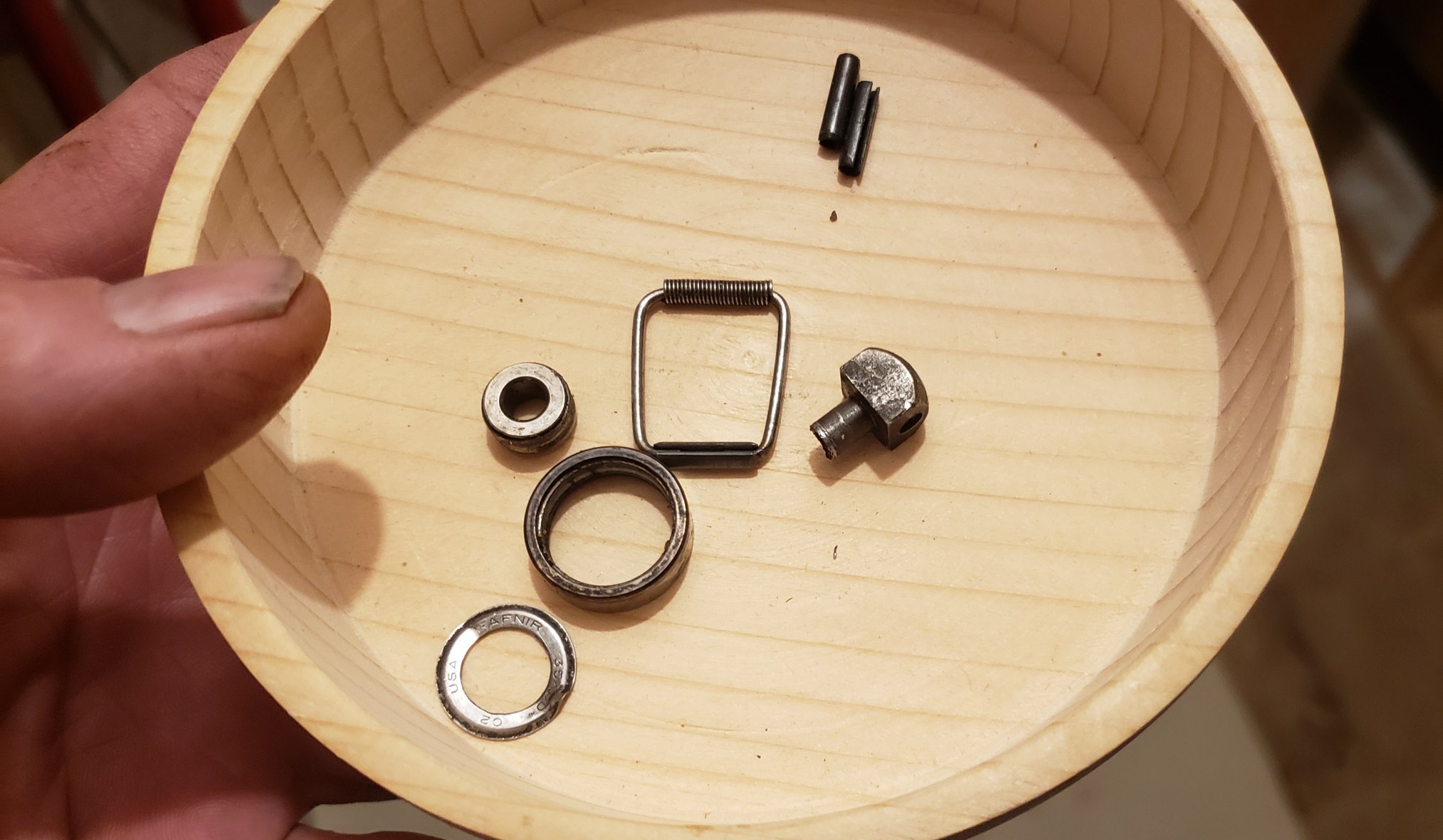

I currently have my mark v in pieces...looking for a bearing for my shave control (in Canada so not so easy).

Here is my current issue... thought it was going to be simple repair...my bearing supplier is ordering a replacement bearing... but really could not give me a time when it might arrive.
The bearing is a 5 x 19 x 6 .... which for some reason is hard to find.
I can get a 6 x 19 x 6... no problem while I am waiting for the proper bearing I may turn a new center button on lathe with a 6 mm shaft.
Any thoughts against doing this?

The parts tray was built on my mark v

The entire button bearing assembly is available from Band Saw Tire Warehouse. Here is a link to their store on ebay.
https://www.ebay.com/str/bandsawtirewar ... 1763958015
Here are two threads full of ideas. My approach with JB Weld is still holding up, and I have been using the advice of keeping the bearing well lubed by oiling it in the drill press position. If I seen redleg's method before I repaired mine, I would have tried that first.
viewtopic.php?f=10&t=19133
viewtopic.php?f=10&t=19238

Thanks for the info...looks like supplier does ship to Canada... I will post outcome
