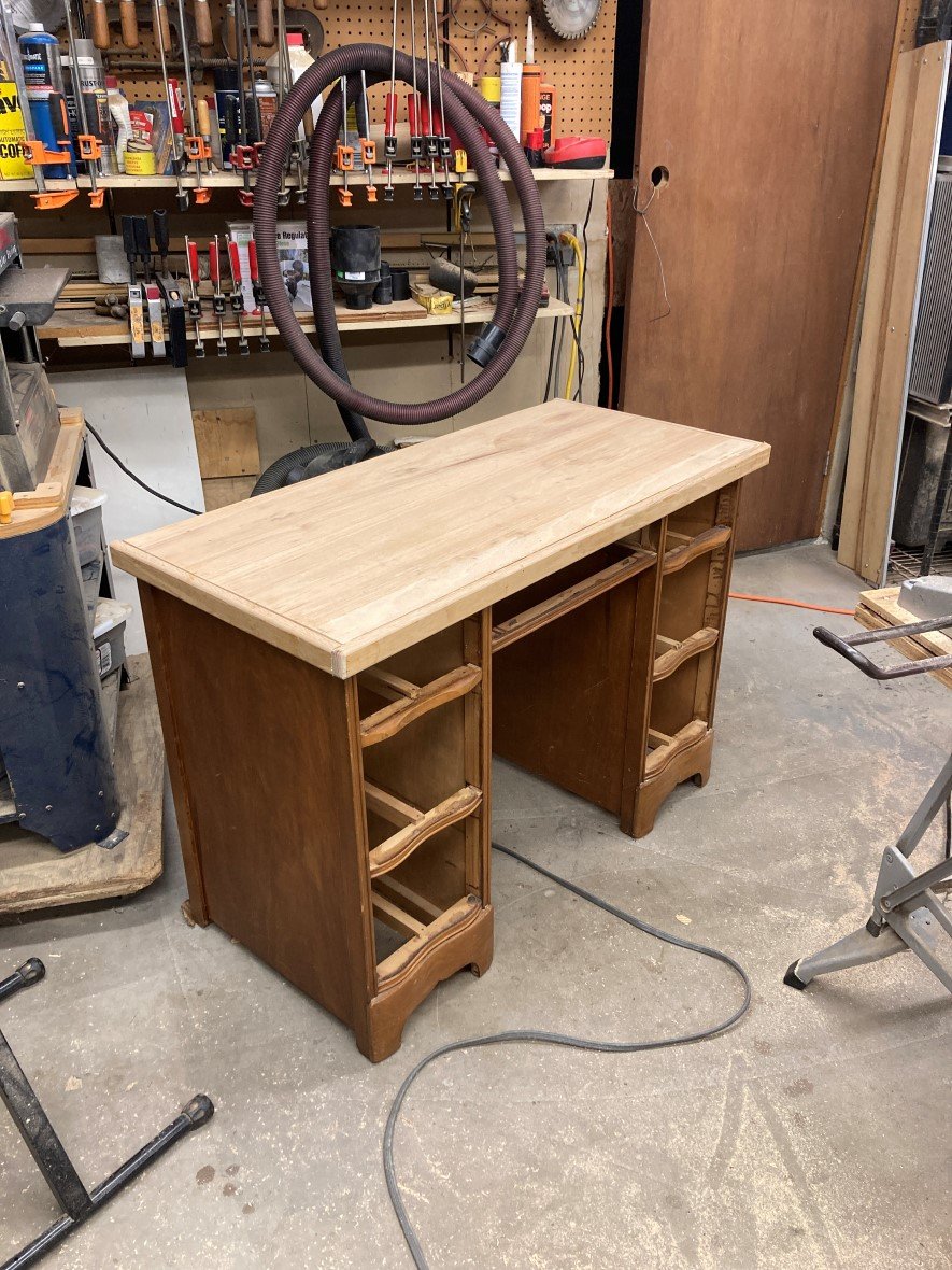

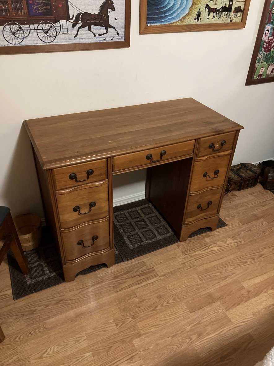

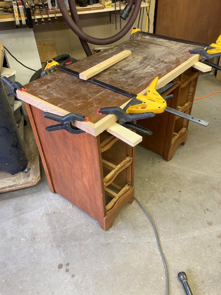

I retired September 1st and I like it! I can go to my shop anytime I want, weather and wife permitting of course. :D My daughter's boyfriend asked for a fly tying station or desk and I had some salvaged materials laying around. We had a student desk that we picked up at a yard sale several years ago for $25.00 and I'm reusing a salvaged oak countertop that I've had for at least 20 years and some oak boards that I saved from an airport remodel last year. The new tying station will cover the original desk top and can be lifted off if desired. I sanded all the old oak and will try to stain it to go with the desk. I believe the desk is made with maple so I know the grain won't match but maybe the color will be close. I'll replace the nails in the last picture with brass rod to hold thread spools. Actually the stain is drying now and I'll add that pic when I get it all back together. All the tool shelves bolt to the top and can be changed out/modified if his tool/material storage configuration changes. All I have had to buy is the brass rod.
Yard sale desk
Yard sale desk
067 (Custom).JPG (192.06 KiB) Viewed 5258 times
Salvaged oak counter top
071 (Custom).JPG (246.61 KiB) Viewed 5258 times

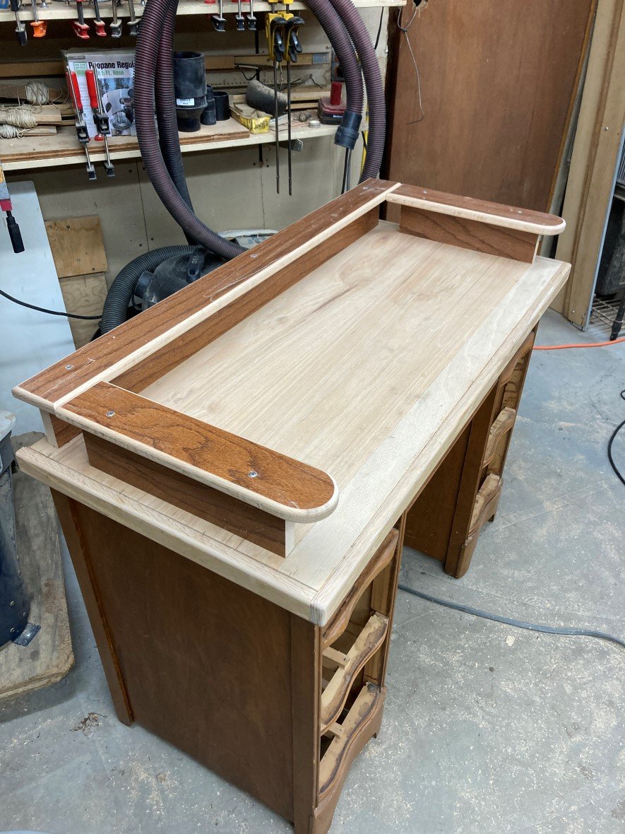

Tying station mock up
074 (Custom).JPG (248.2 KiB) Viewed 5258 times
Sanded & added edge band
081 (Custom).JPG (272.55 KiB) Viewed 5258 times
Working on the shelfs
092 (Custom).JPG (247.83 KiB) Viewed 5258 times

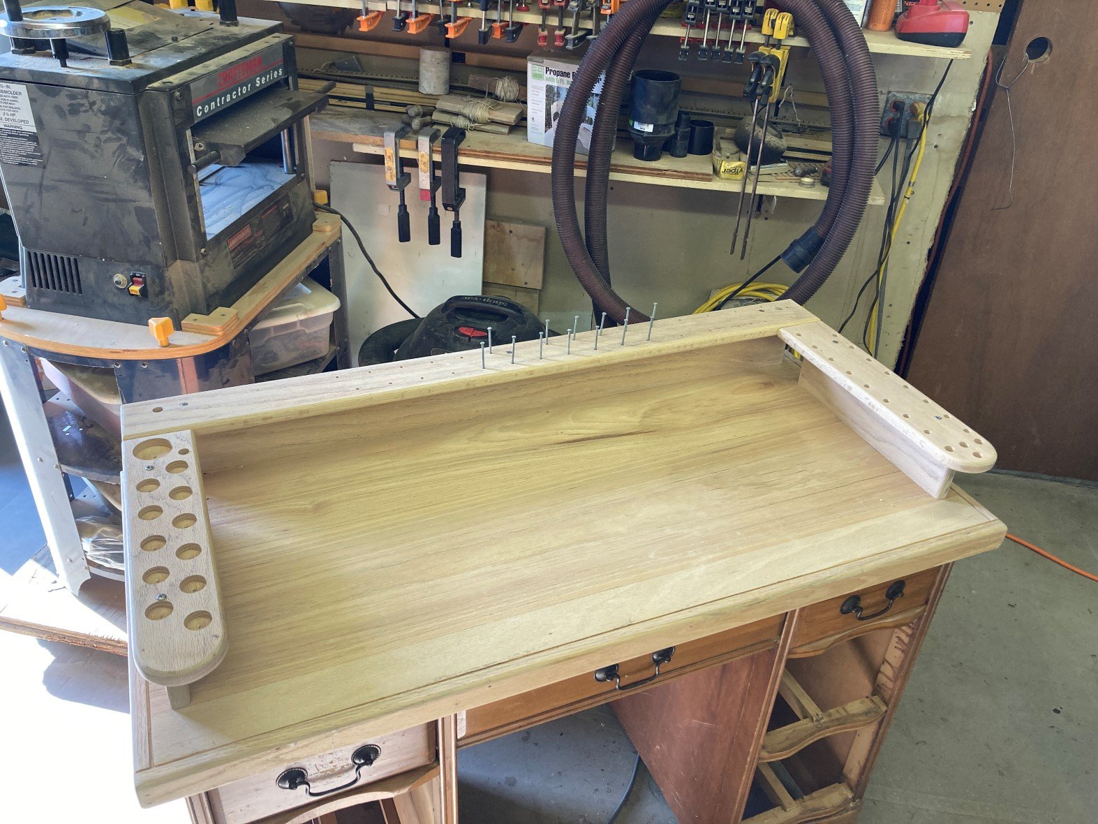

All sanded, holes drilled, temporary nail spindles
098 (Custom).JPG (383.92 KiB) Viewed 5258 times

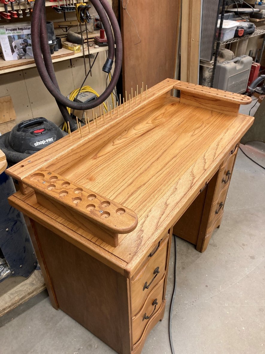

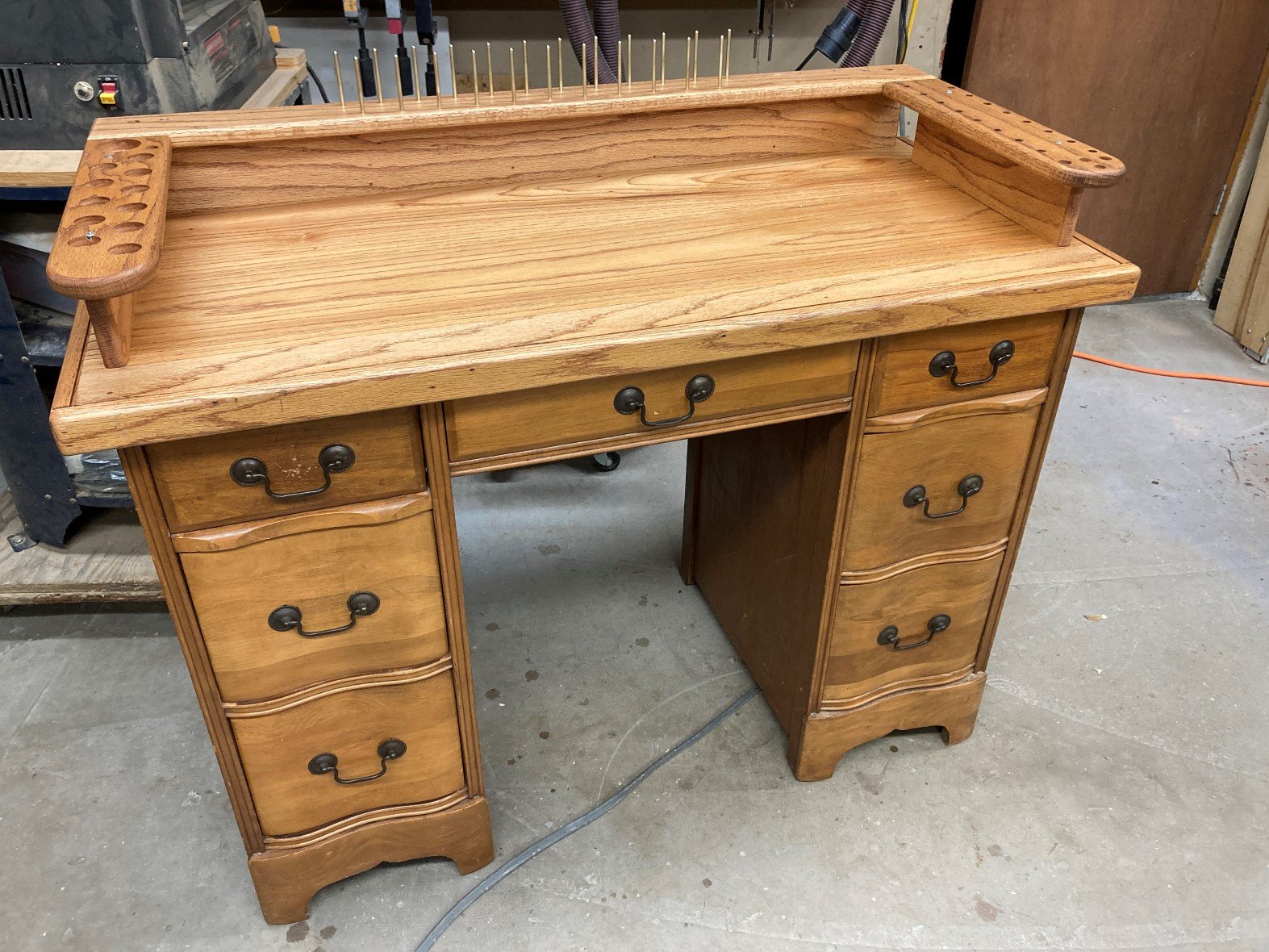

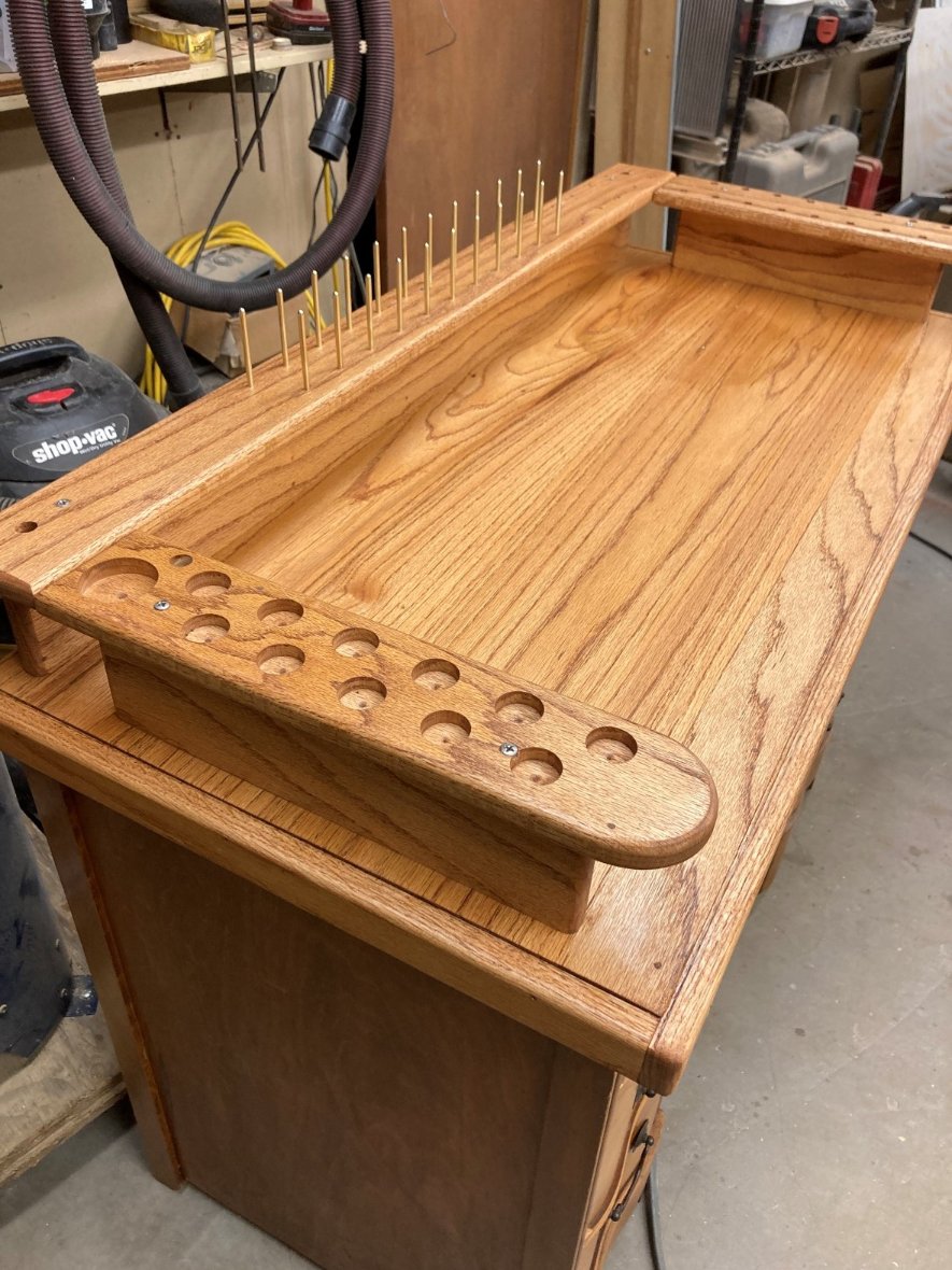

Well I don't know if it's better to add more pictures to my first post or reply to myself. :confused: Anyway I'm done. I'm pretty happy with my stain job, I know it's not a great match but I'm ok with it since everything is reused/repurpose/recycled. I bought 3/16x36" brass rod, cut it into 3" pieces and then rounded the ends chucked up in my powerpro. I really like the slow speed :D .
IMG_0430 (Custom).JPG (411.73 KiB) Viewed 5183 times
IMG_0431 (Custom).JPG (228.28 KiB) Viewed 5183 times
IMG_0432 (Custom).JPG (209.44 KiB) Viewed 5183 times

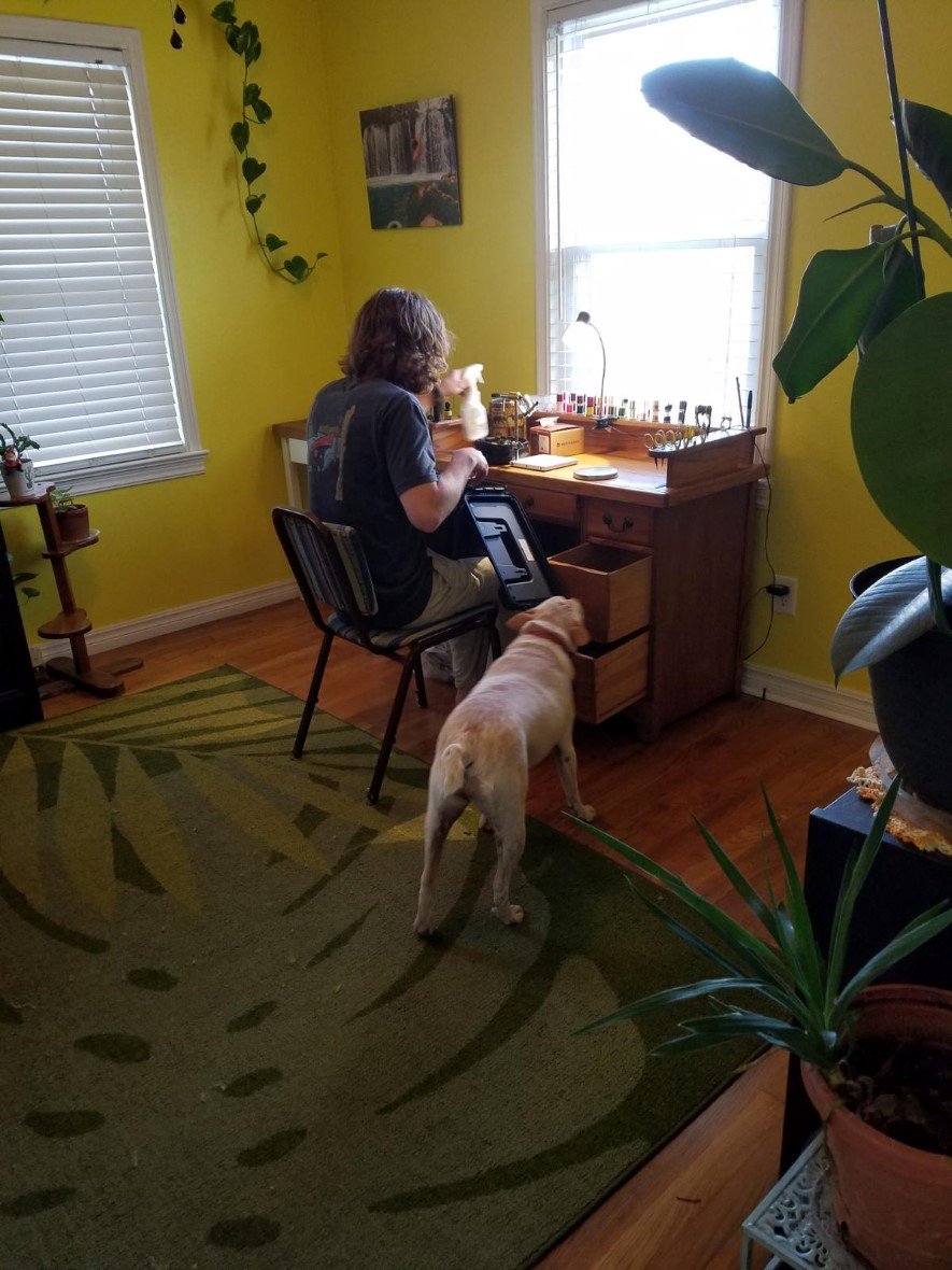

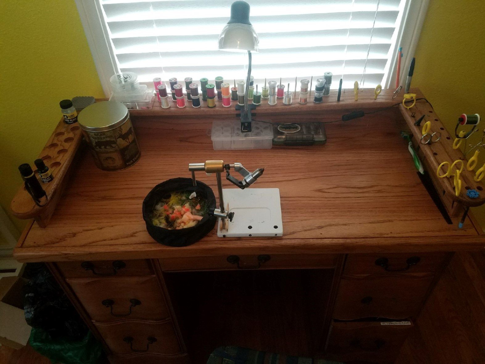

They took it home Thanksgiving day. I believe he liked it, he had it moved in and set up in a couple of hours and that included removing a couch and rearranging furniture to make room for the desk. I don't remember saying earlier but the new desk top is 20X41. This concludes everything I know about fly tying and even fishing in general except for eating them. :D
No wrapping required!
IMG_0433 (Custom).JPG (241.56 KiB) Viewed 3511 times
Setting up
Setting up
IMG_0435 (Custom).JPG (169.59 KiB) Viewed 3511 times
Ready
Ready
IMG_0434 (Custom).JPG (243.87 KiB) Viewed 3511 times
