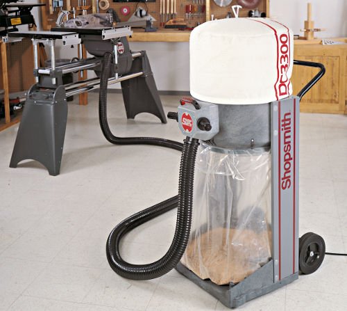

Maybe the actual Shopsmith DC-6000 Dust Collector will give better clues. The picture in the new catalog is a cropped and edited one of the DC-3300 from the online catalog.

I think the change in the hood is simply the printed logo on the new one (P/N 556710) vs. the model number of the old one (P/N 514808). The old one will likely be discontinued after stock sells out since the new one should be interchangeable with it. The 24" and 42" are interchangeable already and only have the logo. Maybe an upgrade will include a decal "Shopsmith DC-6000" for the legs.
