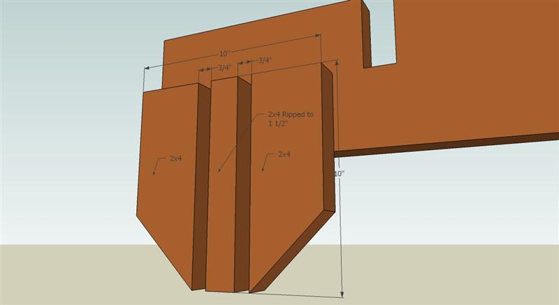

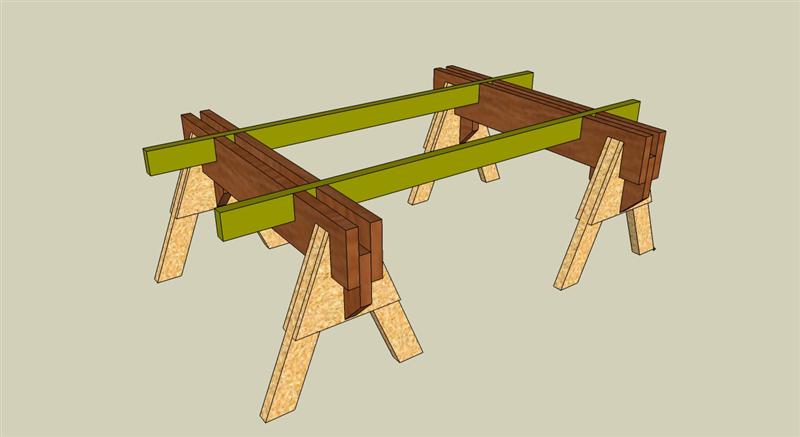

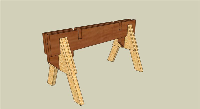

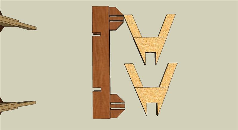

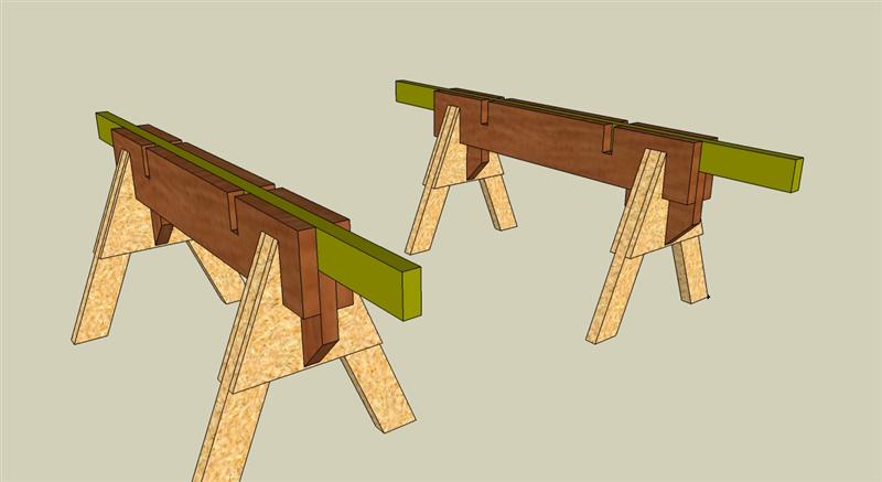

tom_k/mo I dont know if you just want to have your plans on your website but If you are interested I have a sketchup model of my saw horses that are build to last a nuclear blast. My Dad build his Kit Car on them infact. I dont know how to put it to pdf. format or do the 3d preview. But if you interested I will send you the model. Here is them holding a few SS accessories Image

Regnar, interesting design on the sawhorses. I like the option of the groove to run 2x4's between the 2 sawhorses. I'd be glad to add plans for your set of horses to the website if you want to send me the SketchUp model. They look very stable.

They are very stable. The 2x4's going across make it really nice. I can put a full sheet of ply down and rip it to size and when the pieces get to small I just move the horses in and still have great support.
You can also run the 2x4 Vertically in between them and add a top brace. I used this to hang my doors so that I could paint them with a sprayer outside.

I forgot to mention that I used 3 2"x4" and 2 2x10 and scrap 8ply which was less than 4'x4'
