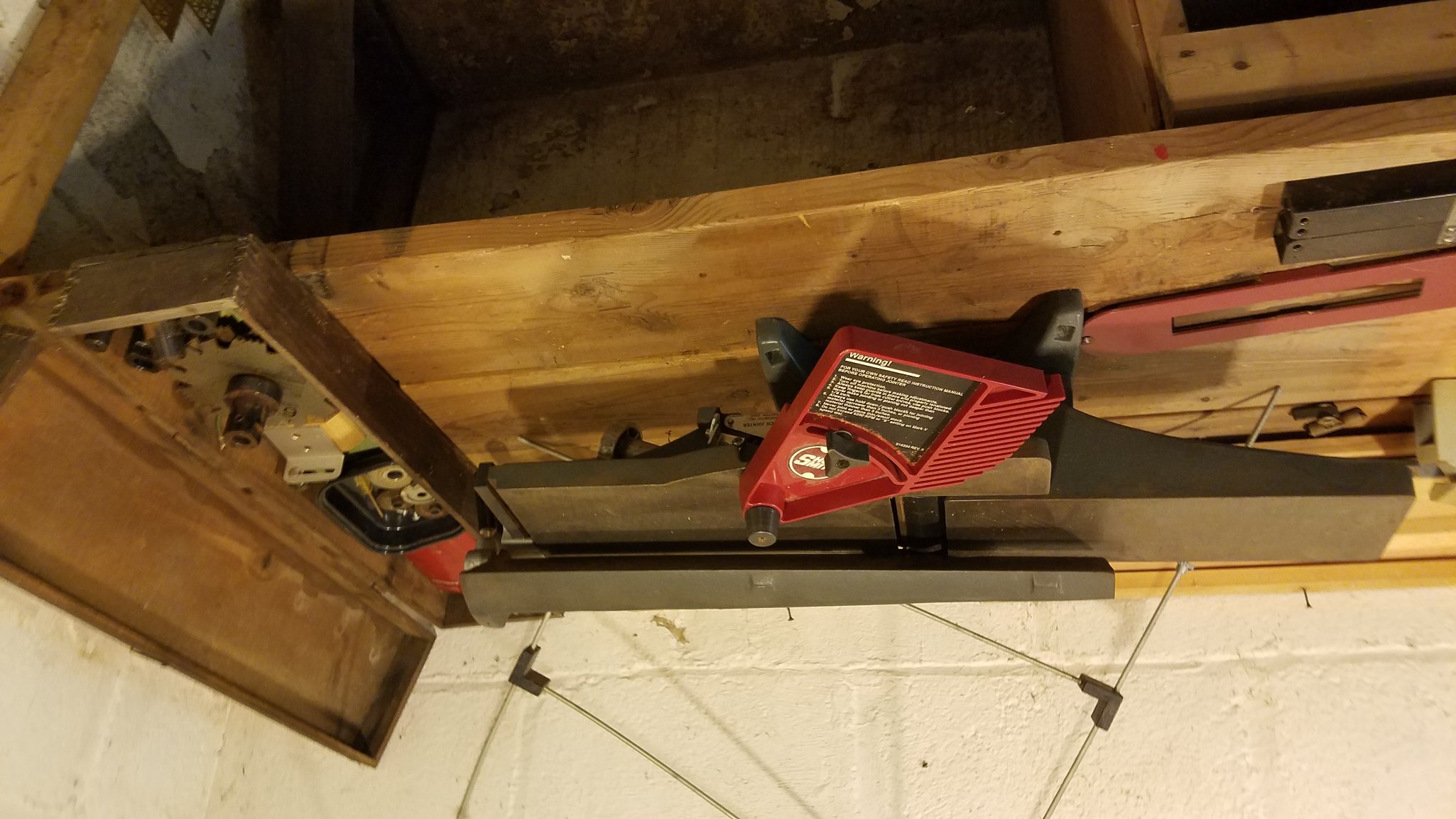

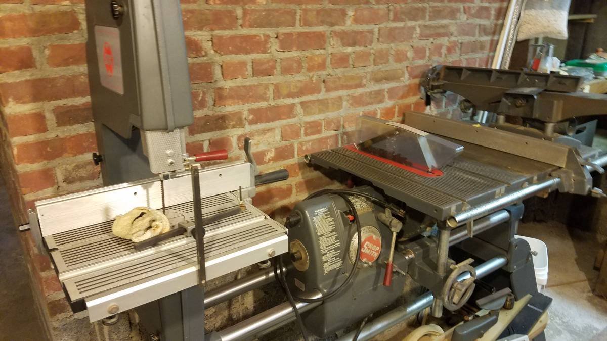

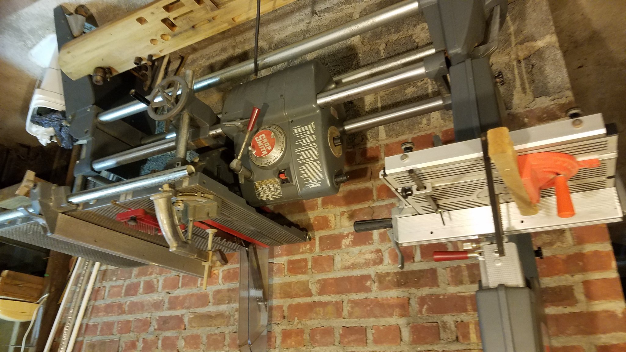

I'm setting up a home shop in the garage of a house we recently purchased. I have some experience with general carpentry and have built furniture in a joinery class I took a few years back. Anyway, without room for stand alone equipment, I'm looking at a shopsmith 510 from craigslist.
Looks to be in good condition and includes bandsaw, planer, extra table attachment, and router. Router doesn't look like the router attachment from the SS website as it seems to have its own motor and plug in. I assume it mounts underneath the main table. Is this router any good?

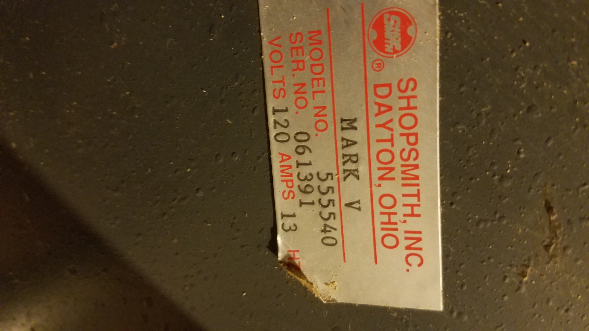

The model plate lists it as model 555540 and serial number 061391. From other threads I've learned this means it was manufactured on June 13th, 1991.
The bad: motor is not working. The guys said, "it's been sitting for a long time when I plugged it in the motor sound like it's binding then it pops the circuit breaker".
Original ad was asking $700, but the guy will accept $600 for everything.
Questions:
1) Is this a fair price? I've spent some time looking around and while there are other units within driving distance (<2hrs), I've mostly seen older Mark V's in worse overall condition albeit with working motors.
2) Does the motor problem sound like it requires a full rebuild of the headstock? How would you test it or proceeds with diagnosis?

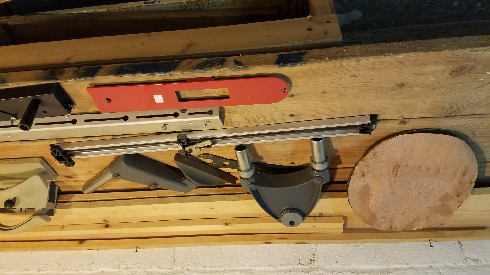

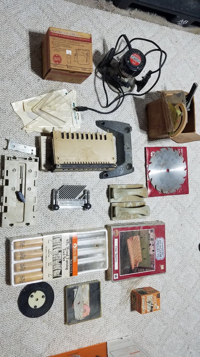

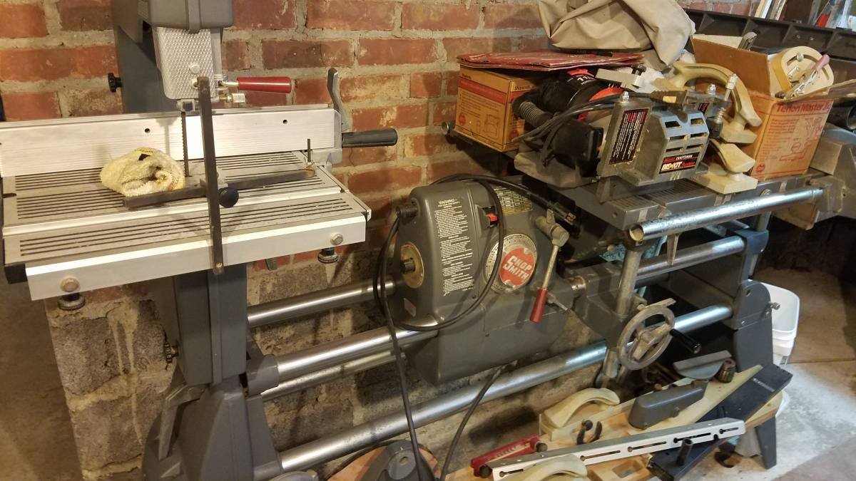

3) Can you see anything in the pictures I'm missing in terms of extra attachments?

In my area (NJ) that would be a fairly good price for a 510, especially with the band saw, a set of lathe tools and what looks like a dado set.
I wouldn't assume the motor is bad. It seems more likely that things are gummed up from sitting and lack of lubrication.

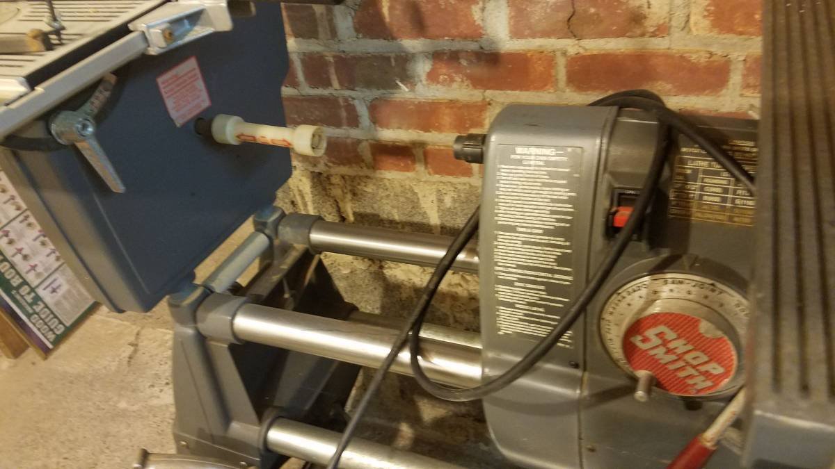

I didn't see the dado set. Is that a biscuit joiner in the 6th picture from the top?

It is a nice setup under than not turning. I think it is a good buy as long as you're prepared to spend a bit more getting it up and running. It includes a Jointer and I don't see a Planer, not an unusual error. The whole thing comes with a lot of accessories, which is great. The bandsaw appears to include all major accessories: fence, table extension, and circle cutter, probably worth $300-ish by itself. Jointer is a recent version so no upgrades needed. It has a taper jig, Tenon Master, stack dado set, etc. The router appears to be a stand-alone Craftsman router, not directly related to the 510. I don't see a complete set of tables, extension tubes, and support legs in any one picture.mattmeek wrote: Thu Dec 17, 2020 1:26 pm The bad: motor is not working. The guys said, "it's been sitting for a long time when I plugged it in the motor sound like it's binding then it pops the circuit breaker".

Whatever is preventing the headstock from turning could be major or minor, it is certainly repairable. You can bind one up by adjusting the speed control toward slow with it not running, for example, and not even damage it. On the other hand, you can burn out the motor and destroy the speed control the same way. If it were me I'd offer $500 because of this, but I'd pay $600 for it the way it is without much hesitation because of the extras. I would not try to diagnose the problem before buying it in this case because of the extras.

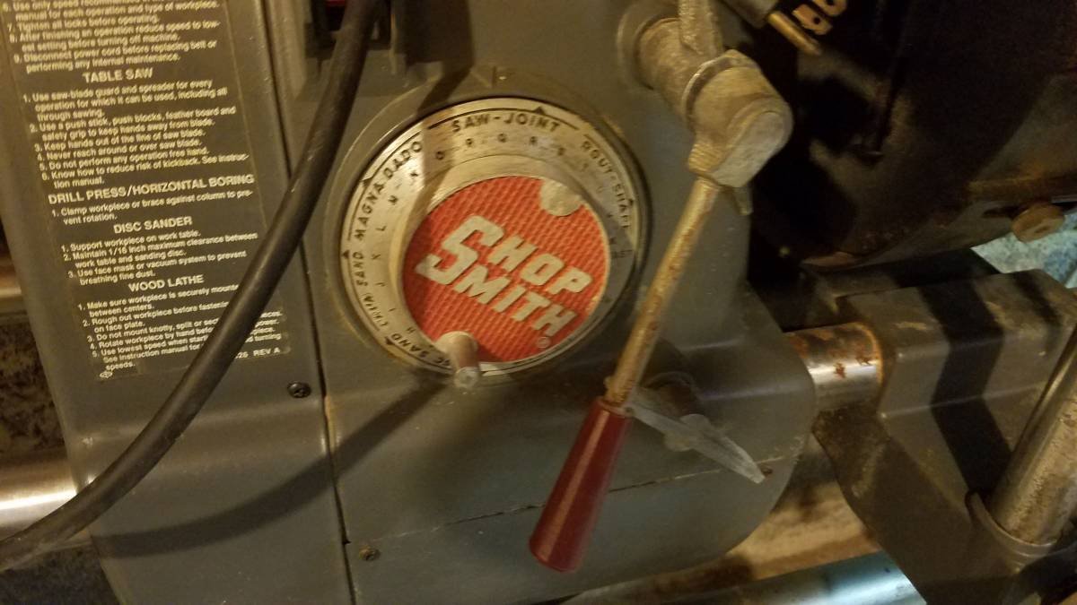

I'd ask the guy to try a few things to try to get the motor turning. The speed dial is on Q in the pictures, if the speed can be dialed back while turning the spindle by hand it might not need anything more.

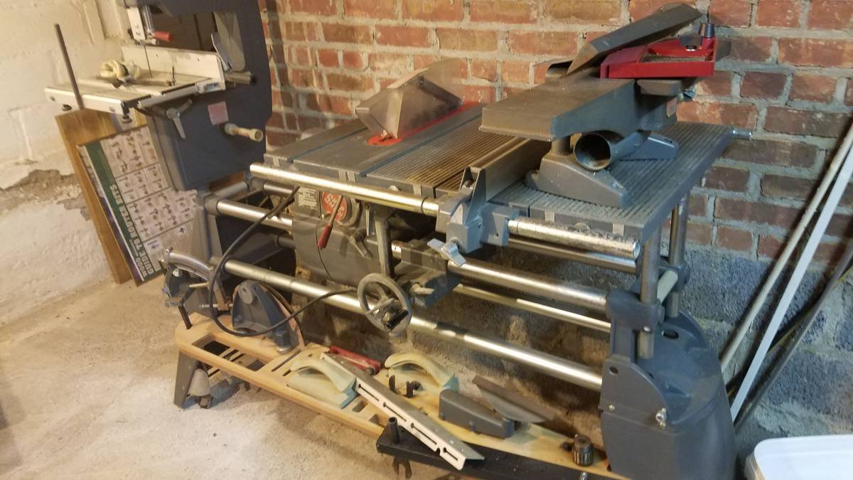

Might be the blades on an arbor in a box in the 3rd photo, and more chippers in a box in the 5th photo.mattmeek wrote: Thu Dec 17, 2020 3:29 pm I didn't see the dado set. Is that a biscuit joiner in the 6th picture from the top?
Those would be like my old dado set that were included with my old Greenie. I don't know if they were a Shopsmith product or not. Certainly different from the new ones. Didn't use those much, lots of flying splinters from the chippers, but they worked very well. I remember using them on a project for Cub Scouts to make wooden boxes, I had some pieces of African Zebrawood on hand and that stuff was hard as a rock. The dado set went right through it. And part of that is due to the Shopsmith variable speed. Dado blades are rarely well matched to table saw speed, not to mention the material and cut dimensions, but with a Shopsmith you can find the sweet spot on the dial, and now just by pushing buttons!
