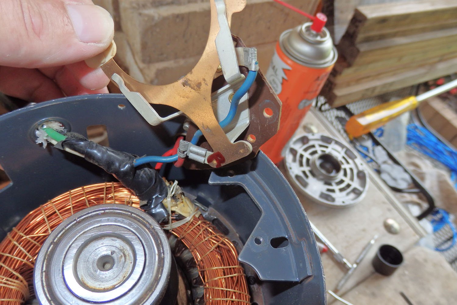

Re: Motor Problem AGAIN
Start switch! May require taking the motor apart. Some sharp rapping(with a NON-metallic hammer) MAY knock whatever is preventing the contacts from making loose before disassembly.

which part is the start switch? Yes the motor moves freely. Last time I tried it, it tripped a GF outlet and only hummed.

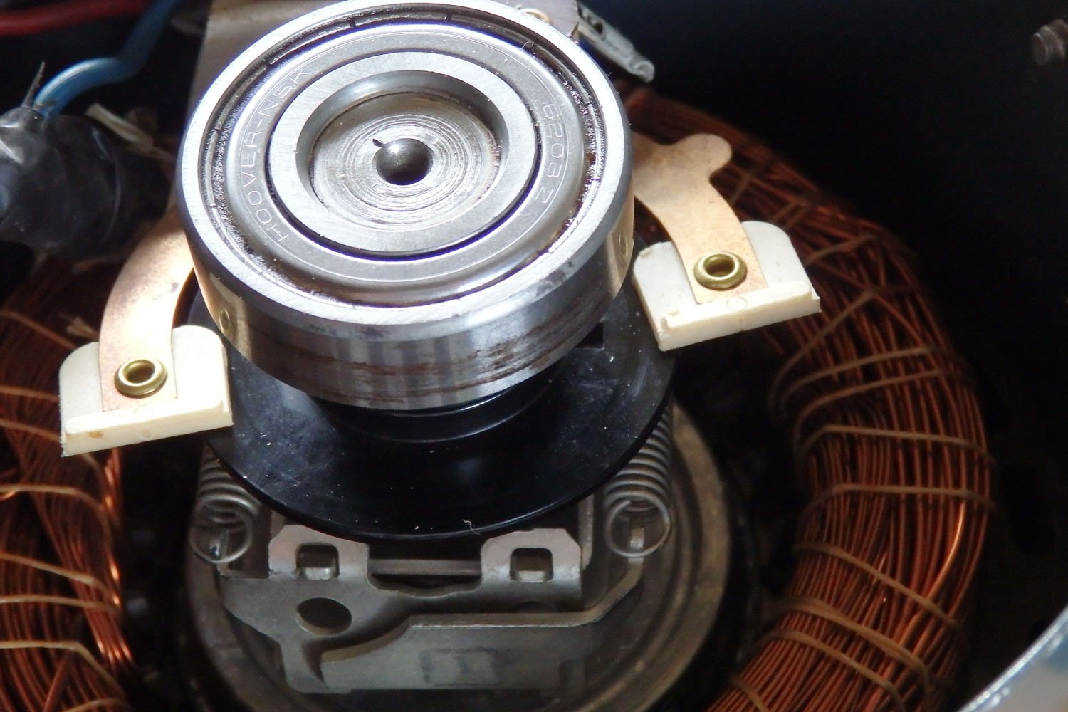

Depending on the brand of your motor, it may look different, but here is what my 1 1/8 hp GE motor's looks like:
And here is a link to a thread about the subject (and at least one other link within it)
viewtopic.php?f=10&t=17624

I should have mentioned its a Franklin 3/4 hp motor
Regardless of the brand, the start switch will consist of contact points and a centrifugally weighted mechanism that moves half of a contact pair.
