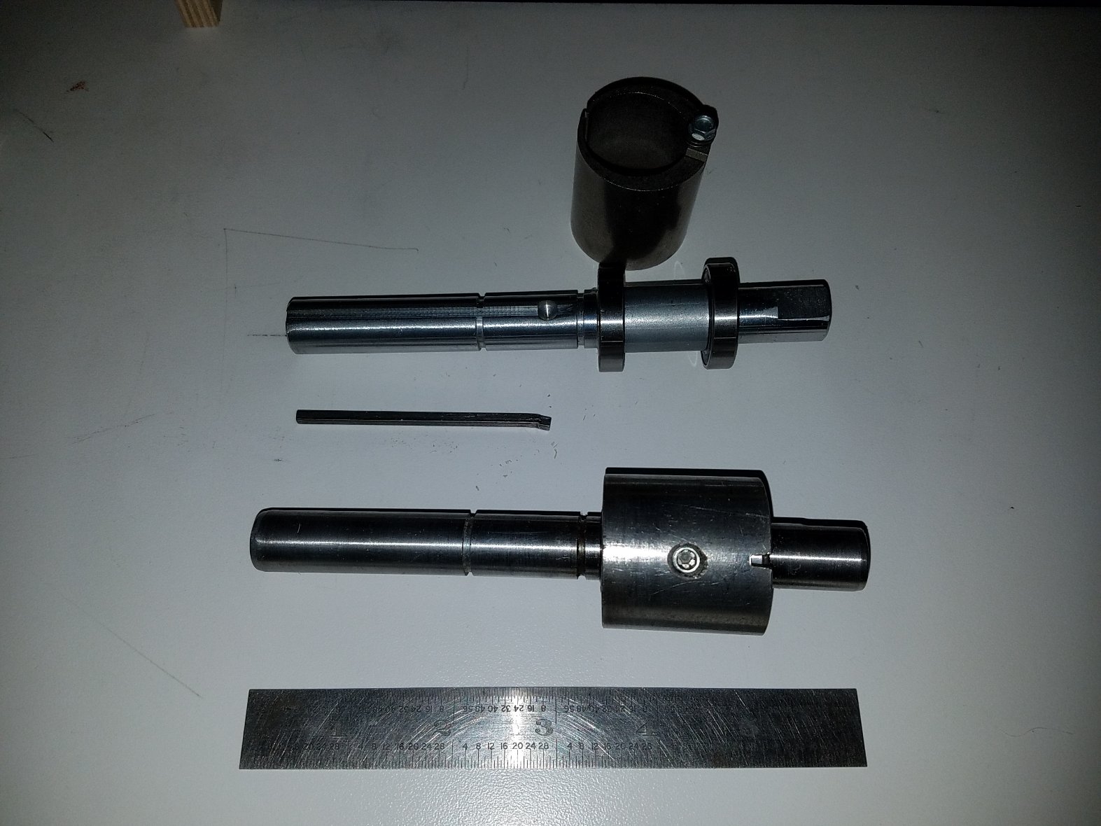

If someone has a new idler shaft 'handy' could you take some dimensions?
I assume the keyway and keyway 'hole' are the same as an older version.
What I am interested in is:
The over all length.
The existence of a groove for retaining clip for the quill end bearing and it's location.
Ditto for the rearmost bearing.
Is the internal bearing spacer a sleeve or shaft od step?
Am trying to determine if a MVII idler shaft replacement can be made from a new idler shaft.

JPG wrote: Sun Dec 20, 2020 10:56 pm If someone has a new idler shaft 'handy' could you take some dimensions?
The old and new idler shafts are the same length (6").
The keyway and key are the same.
Ignoring the differences in the bearings and the eccentric, they are interchangeable.
Old and New Idler Shafts with Key and Eccentric for New Indler shaft.
Re: "new" idler shaft dimensions
Thank You!!!
That is the answer I had hoped for.
However the MVII is a bit longer
What is the od of the bearings?
And the distance from the quill end to the key recess 'hole'.
I fear the control sheave part is longer.
P.S. Also the distance from the end to the SECOND groove?
The bearing OD is 1.18" and the shaft is .625" at both ends. On the new shaft the OD is .7675" between the bearings. The bearings on the new idler shaft are both 6903RZ.
The center of the hole for the keyway is 3" from the service end of the idler shaft (actually from either end).
The two groves are 1 1/16" apart and the groove is 1 1/8" from the end of the shaft. When the key isinstalled in the keyway the distance from the end of the key to the end of the shaft is 1/8".
