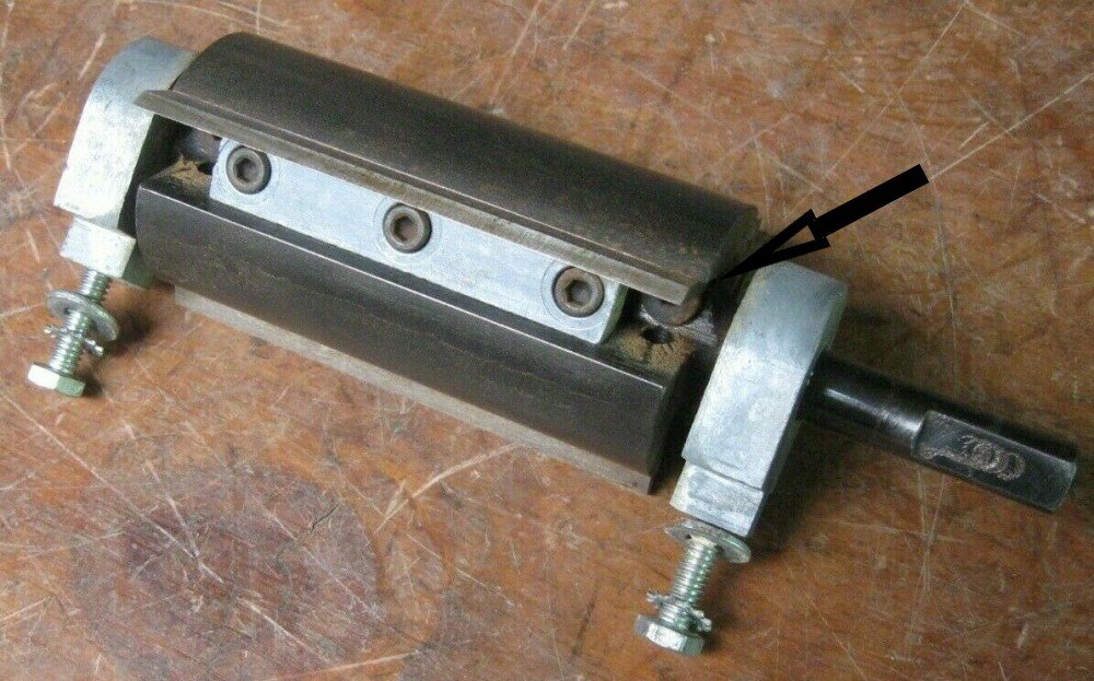

As JPG said there is room to offset the blades. If the nicks are small enough after sharpening offsetting the blades can work. I would recommend sharpening them before doing this to remove any burrs from the nicked edges. There is about an 1/8" of clearance on the near side before the blade will hit the infeed table. On the far side there is clearance between the head and the bearing/mounting. The picture below shows a blade offset towards the near side as indicated by the arrow.
Jointer Cutter Head - arrow.jpg (150.19 KiB) Viewed 1068 times
