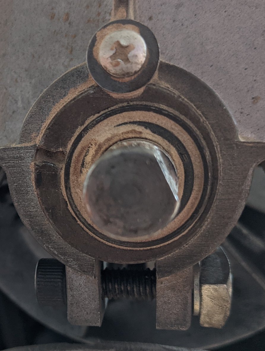

So WHERE is the belt tension adjustment slot on the eccentric positioned?
It should be between 0600 and1200 by way of 0900.
Re: Bandsaw Troubles and Questions
Sorry for the delay (I was out of town for Christmas). The eccentric is rotated to just past 0900 if I'm understanding you correctly. I'll try to post a picture below.
Also, I found Jacob Anderson's video on YouTube about the belt tension and he said he likes to see maybe a 1/4" give when he pushes on the belt, but mine gives quite a bit more than that.
- PXL_20201228_213355219~2.jpg (173.67 KiB) Viewed 1252 times
