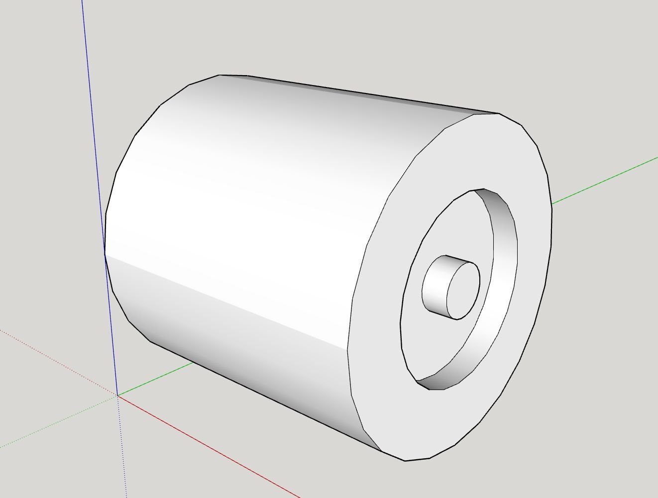

Without actually doing this I can't see any issues with just turning it with centers then removing the center section left for the tail stock center any way you can.
This is what I'm picturing:

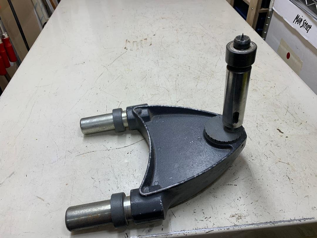

If you are short of room then you may want to get a tail stock extension like this:
lathe tail stock.jpg (154.43 KiB) Viewed 4487 times
Does that help?
