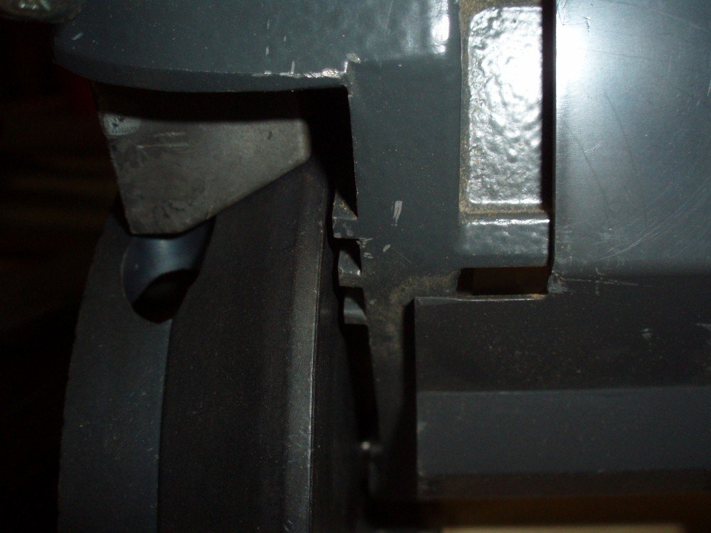

I found the other thread I was thinking of, evidently there are others: viewtopic.php?f=10&t=15439 Since this thread had a ton of detail I will skip the new pics, they won't add anything new. My attempt at a summary, as the other thread is 10 pages:
The OP, Dusty, reported tilt lock issues. Some other users had or have similar problems, most do not. The problem was found to be a gap, shown here, between the rear trunnion and the tie bar while the trunnion was locked:
It is my understanding that there was no such gap on the front side. Where the gap came from, or when it was introduced, was not determined. Dusty reassembled, realigned, and everything seemed good. The gap was eliminated and the tilt lock worked as intended. It is my current opinion, not directly supported in that earlier thread, that for this gap to exist it must have been present when the table was bolted to the trunnions. My thinking is that the trunnion must be jammed on its axle somehow by the combination of vertical and horizontal forces applied by the lock wedge, rather than slipping horizontally into its intended position. Once locked to the table in the wrong position, the trunnion will be held in that wrong position by the table.

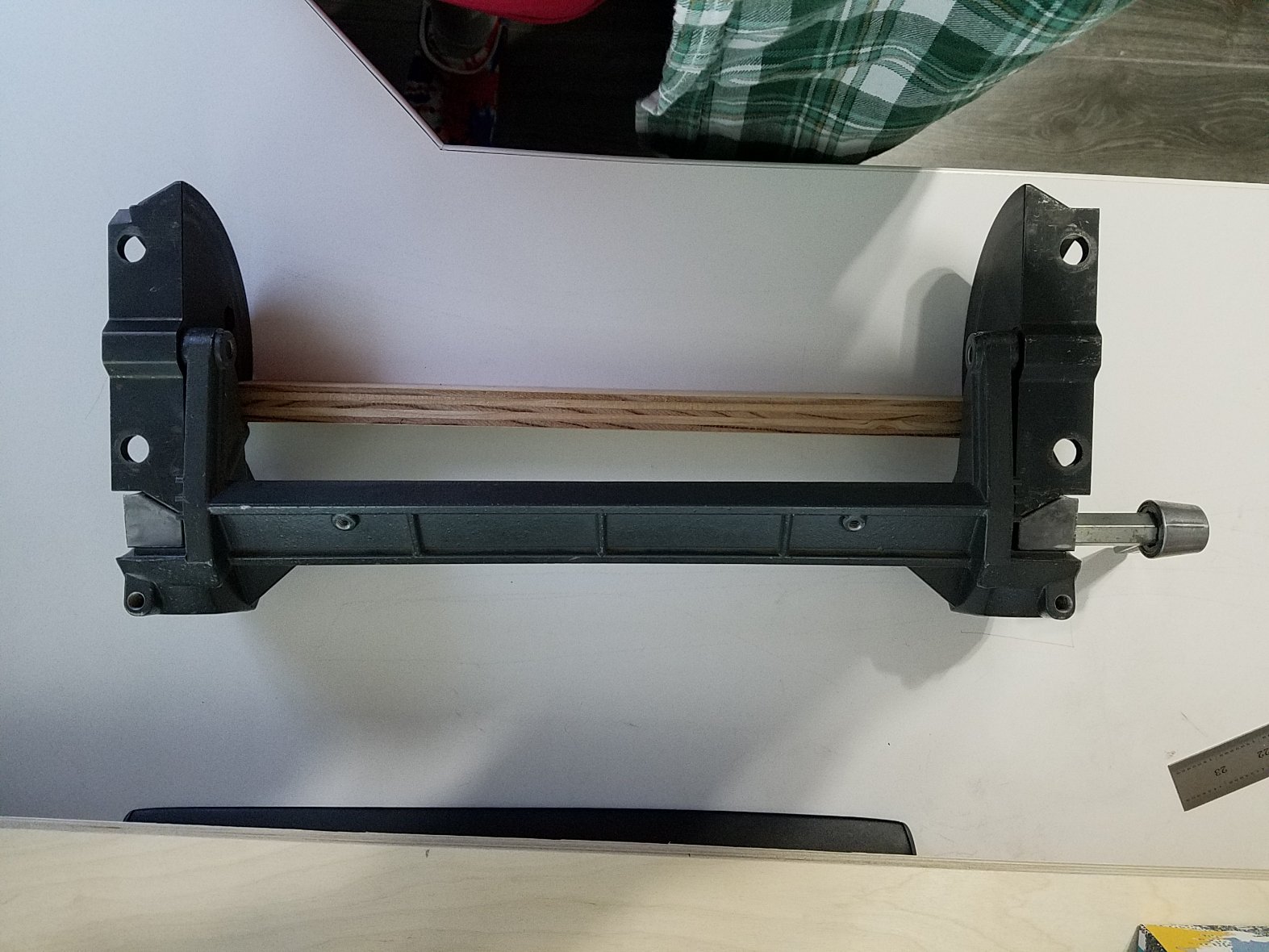

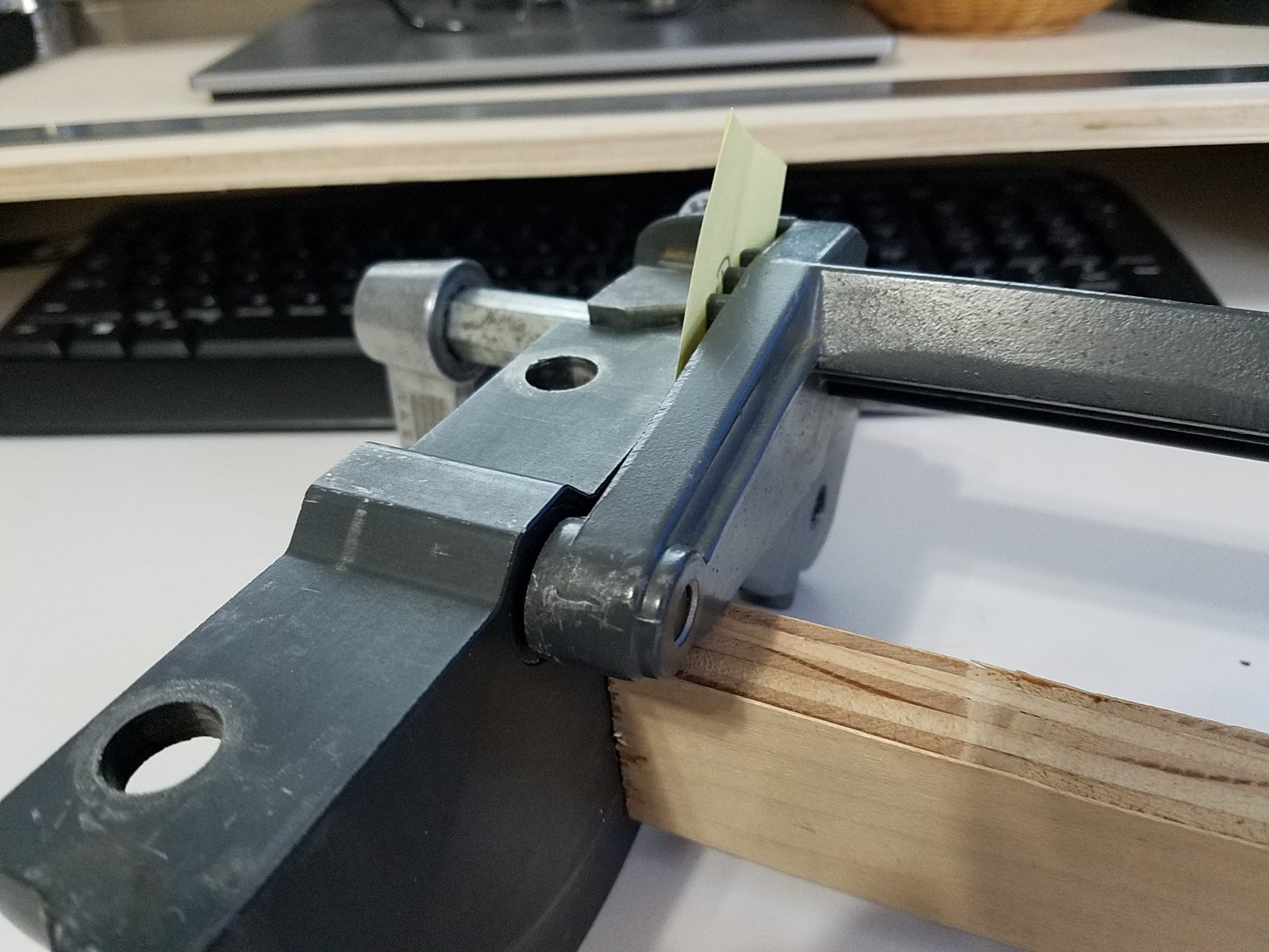

Nope. That theory is a pipe dream. I separated the trunnions with a piece of wood 14 1/2" long and the tilt lock captures the trunnions perfectly. I interpret this to mean that the way I bolt the trunnions to the table is not the root cause of my slippage.
- Trunions Separated 14 1/2" and Locked
- 20201231_082732[1].jpg (264.96 KiB) Viewed 2301 times

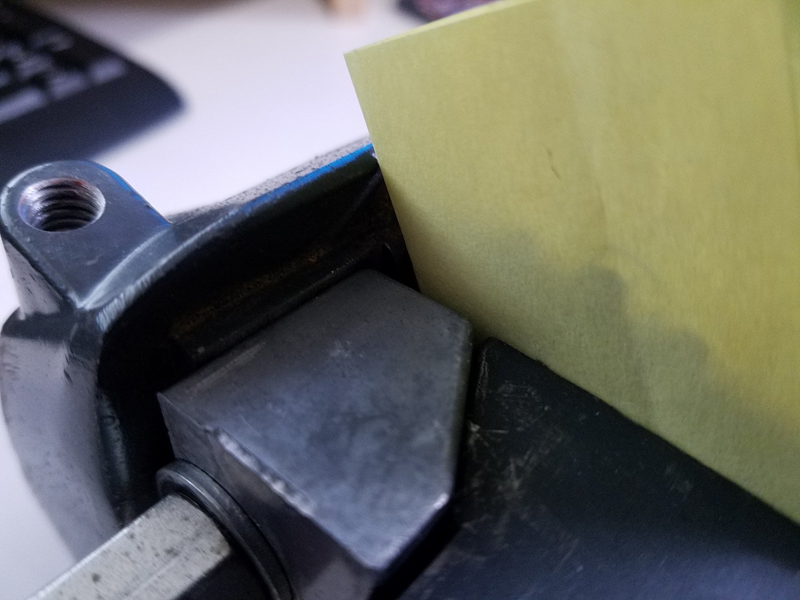

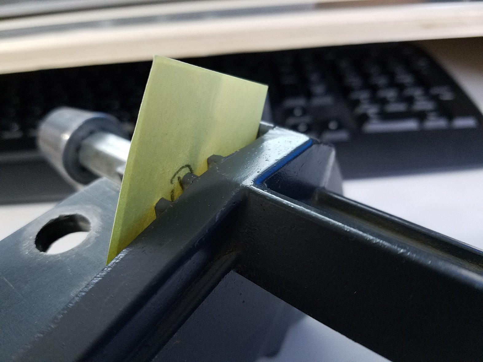

To confirm: tilt the table to vertical, lock the tilt lock and attempt tp insert the dollar bill (or piece of paper) between the boss and the trunion (showing that locking action does not involve the bosses on either end of the table bar.
If I pull the 14.5" spacer out and tighten down on the tilt lock, the wedges are forces inward and capture the trunnion. Yes it is locked and the trunnions are in hard contact with the table bar but the trunnions are also not separated as they would be if bolted to the table.
The dollar bill trick only ensures that there is some spave between those bosses and the trunnion.

I don't understand this, especially the 14 13/16" part. I measured two, one on the bench without a table measured slightly under 14-1/2", ~14-15/32". The other, with a table, measured very slightly over 14-1/2". These are both with the tilt lock applied. IMO, the difference would have something to do with manufacturing variation and/or wear, not the presence or absence of a table. Please explain the 14-13/16" measurement, I think this could be the key.dusty wrote: Thu Dec 31, 2020 9:27 am ... On the bench (without a table attached) those gaps differ. Obvious I guess because with the table attached the trunnions are a fixed distance apart (14 13/16" by my measurement). On my setup in the shop the distance is 14 1/2" (with the table tilt lock applied)...
