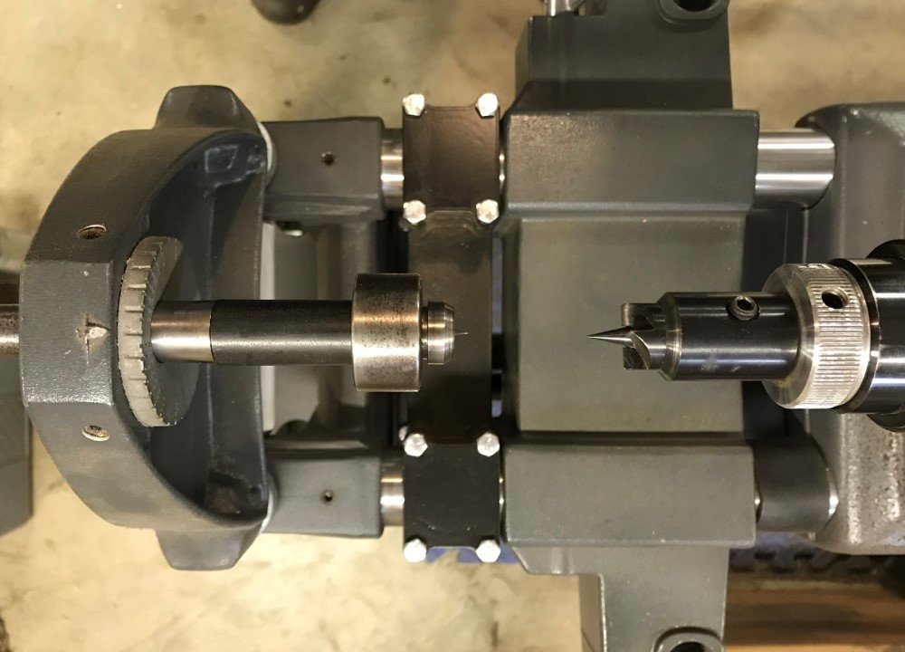

I'm not sure what you mean by "Lathe Kit" either. If you are talking about the Universal Tool Rest that will extend the distance the Headstock can get from the Tailstock. My Mark 7 has a Lift assist that keeps the headstock from going as close to the Tailstock by 2-1/2" as one without it. Without the Lift Assist using a Live Center with the 1-1/2" Extender I can extend the Quill they would touch points. In the picture below the Lathe drive and Live center points are 2" apart. Without the Extension (and no Lift Assist) the points would be about an inch apart. The Dead Center is a little shorter than the Live Center. The same should be true for the Mark V 520, 510 and 505. The Mark V 500 or earlier Mark V/5's should be even closer to touching as spacing between the Headstock and Tailstock is different. Someone with a Mark V/5 and the original (500) Table System can confirm this since I do not have one at this time.
_
Lathe Points.jpg (101.26 KiB) Viewed 1262 times

My Goldie spur point and dead center point will just barely overlap(< 1/16") with the quill fully extended.
However since the points are inside the outer ends of the work piece, the minimum workpiece length is slightly less than 1".
JPG's post above answers that.
