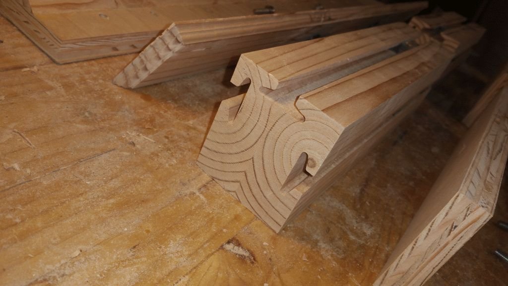

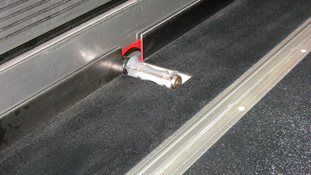

I have had good luck with these bits which are used for horizontal table routing.
https://www.mlcswoodworking.com/shopsit ... outer+bits
I built a table to set on top of the main table so the the bit is positioned in the headstock, horizontally, to the left and below the table. This picture shows it mounted on the right side end table and the main table set 90 degrees to it. It works but I have since used the main table in its normal position and positioned the bit to the left of it.

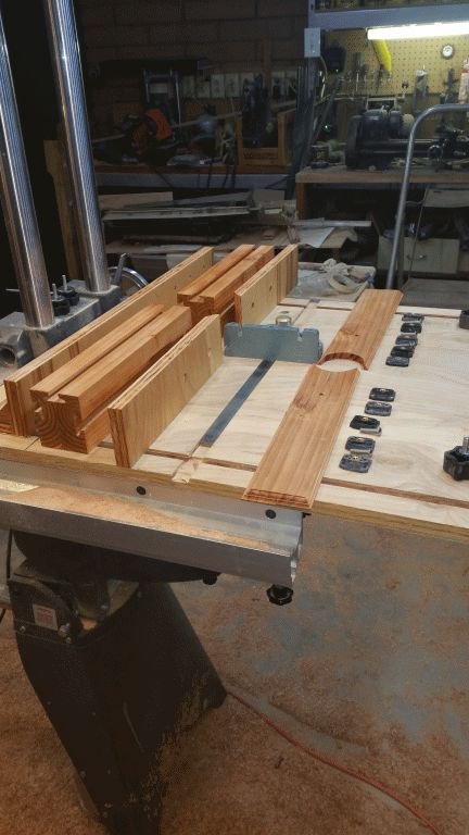

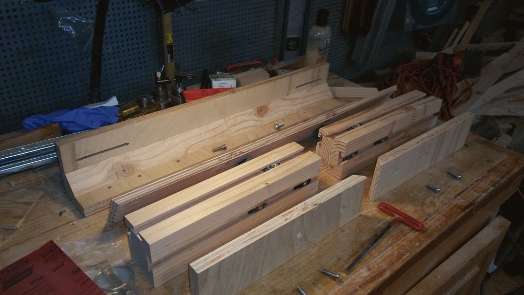

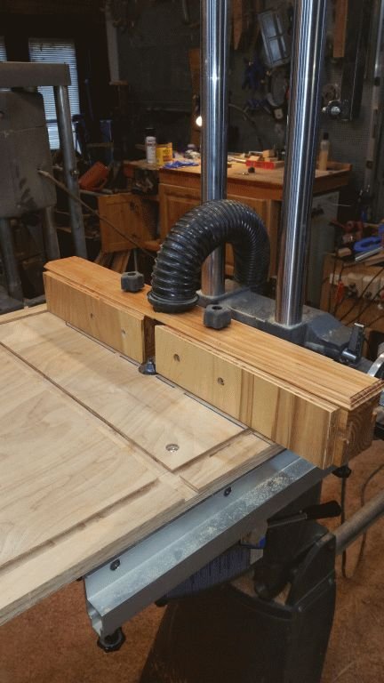

I use my Mark 7/VII all the time for making raised panel doors. I even built a router fence that helps a bunch with my ToolQuest fixturing system. Here are some pictures. I also use the same fence for the large bit for the floating panel but in drill press mode and slowed down to 6000 or less.
Works perfect.
I will start a new thread on not only this fence, but on the ToolQuest system itself. Absolutely an awesome idea and concept....

- Exploded view
- routerfence002.jpg (91.9 KiB) Viewed 2894 times
- Bookmatched ToolQuest sliding fixture
- routerfence003.jpg (85.71 KiB) Viewed 2894 times
- In place ready to go.
- routerfence010.jpg (57.23 KiB) Viewed 2894 times
- Another Exploded view
- routerfence004.jpg (59.2 KiB) Viewed 2894 times

Thanks for the response. I made that fence system because I use the Mark VII (60's) as well as the Mark 7 under and over table routing shaping and I wanted a fence that worked on both. I have the table "cover" for the M7 made to utilize the tslots of the 520 table system to lock it down and I made another table "cover" for the M VII utilizing the two threaded holes in the insert to secure it to the smaller table of the Mark VII. The center of the fence is of course going to be at different places on both machines so I wanted a fence to be able to accommodate that difference. There is adjustment slots on the angle bracket that allows lateral movement and then the blocks adjust infinitely as well. It makes it flexible enough to allow the over table large bit for the floating panels as well as moving the block narrow (like the SS fence) to use normal router and shaper bits.adrianpglover wrote: Wed Jan 27, 2021 8:43 am @rjent - That's an interesting setup. What advantages does this system give you over just getting a T-slot cutter router bit from Rockler/Woodcraft/etc and closet bolts to match the slot size? I see that there's a bit of a tapered profile on the slot, but wondering what the advantage of it is.
Also, how do you adjust the outfeed fence separate from the infeed fence for full profile cutters?
All of that said, I wanted a smooth sliding adjustment that I have never found in "T" slot configurations. The ToolQuest fixture nuts are smooth as glass with no play, and easy adjustment. Dennis tells me the shape is for holding power as well as ease of moving the the provisioning slot.
I am working on utilizing the same fence (down to the angle bracket) on the bandsaw table as well. 10ER's are my next victim.
