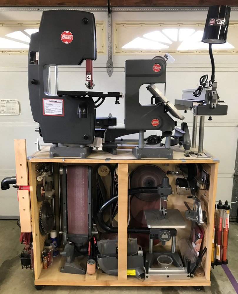

There have been other threads here about storage of extra items. This thread has some ideas.
viewtopic.php?f=5&t=24353&p=277188&hili ... ge#p277188

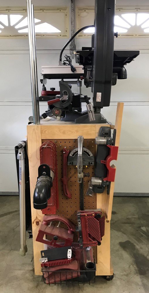

Posts: 4233
Re: Attachment storage/organization
Frank,

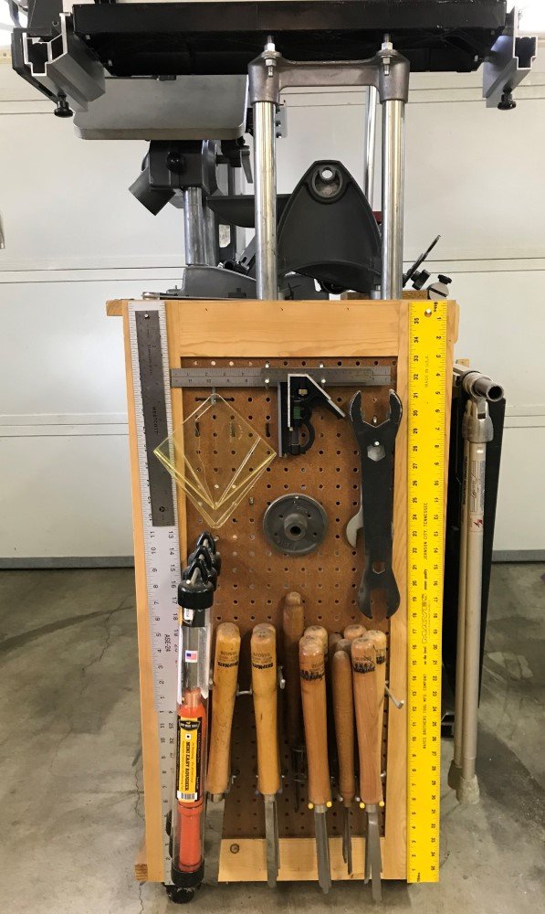

Gary's roll-a-round cabinet is a great storage idea and a nice piece of workmanship. The SPT shelf is an idea I have seen variations of including Shopsmith plans. It is an especially nice idea for storage over a Shopsmith stored against a wall. A real space saver. I use a 5 drawer base tool cabinet for storing smaller items and Model 10 accessories. It does the job similar to Gary's roll-a-round cabinet but not nearly as pretty. I built a cart to store most of my SPT's and other items. I got the idea from other storage I have seen. Being mobile it keeps most of my Mark 7 & Mark V 520 accessories close at hand. I built it when I had just the Mark V 520. My Scroll Saw sits on a Power Station and my Model 10 Jig Saw & Jointer have storage mounts on top of the tool cabinet.
_
Storage - front.jpg (159.97 KiB) Viewed 4404 times
_
All the SPT's are mounted on SPT Mounting Bases and the Extension Table, Tailstock and 5" connector tubes are stored in holes drilled into the cabinet.
_
Storage - right.jpg (119.52 KiB) Viewed 4404 times
_
The ends are framed peg board and allows for easy reorganization.

The table storage rack has 4 connector tubes under the Table Support Leg. It's made out of wood but is modeled after the metal storage brackets Shopsmith sells.
_

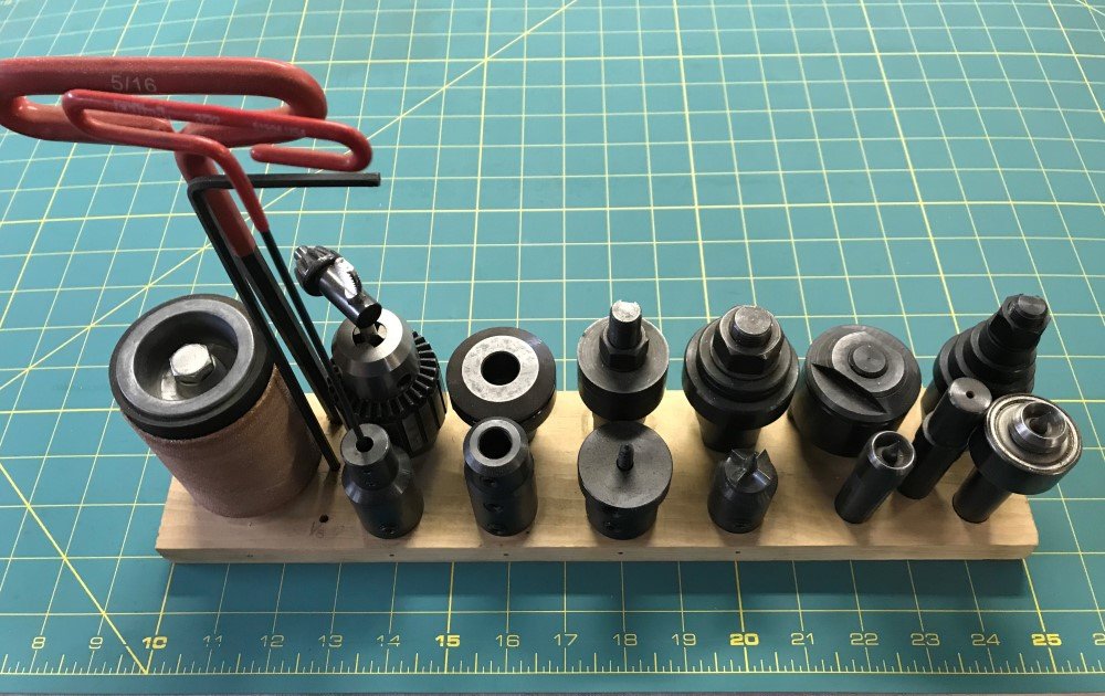

I have a piece of 1 x 4 that stores arbors, lathe centers and other spindle accessories that sits on the bottom shelf of the cart under the Belt Sander. It also has the needed Allen Wrenches that are not the 5/32" size but the 1/8" one is not there in this picture.
_

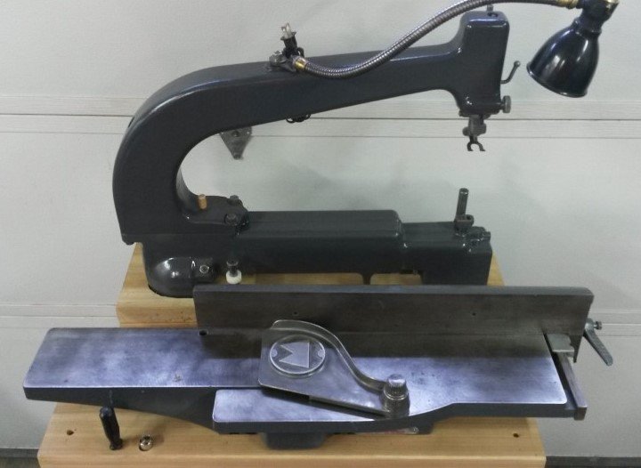

Below is my Model 4E Jointer and Jig Saw for my Model 10ER sitting on the wood storage bases I made for them.
_
