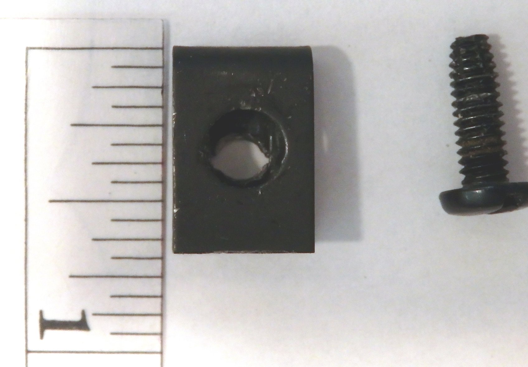

Restoring an 1980's headstock that was given to me. Does anyone know the size U-nut and pan head screw that is used to hold the motor pan and belt cover to the headstock. Also, any recommendations for gray paint to repaint without going back to Shopsmith for paint.

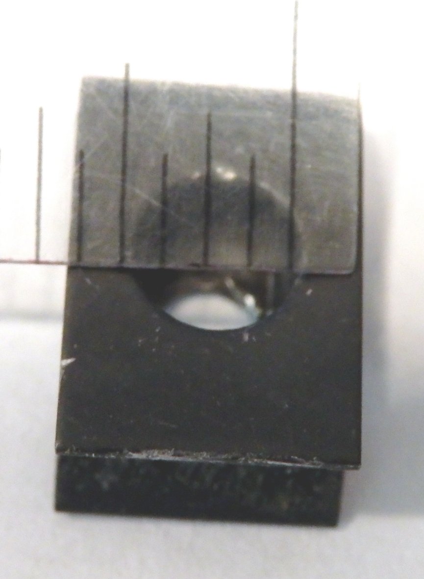

Here's what mine from a 1980 model look like and measure. Forgot to photograph the distance between the two legs of the clip, but it measures about 1/8".
I think the screws are 1/2" long #6-32, but I couldn't get them to thread into nuts that size ... perhaps the starting threads were just too messed up.
I have since replaced all of the original screws with hex washer head sheet metal screws as shown in the last picture. The slotted head screws were too difficult for me to remove and replace with a flat blade screw driver for fear of slipping out and scratching the covers. And, the grip wasn't always the best with machine screws. A 1/4" nut driver is all I need now.

The 'clip' needs to be the 'thicker' variety that fits the thickness of the casting. They have a 'name' but it escapes me at the moment.(tinnerman?)

The screws on mine are Phillips Head #8 about a 1/2" long and Tinnerman clips to match. They were the same on a 1982 Mark V I restored. Earlier Slotted Head screws were used and the casting holes on older Mark 5's were threaded.

Don't recall if you had threaded holes originally but if so they are probably stripped out. You need to get some Tinnerman clips so you can use sheet metal screws or something similar with a tapered point to replace the original screws. Tinnerman clips are shown in the picture up above and are available at hardware stores in a variety of sizes.shackman66 wrote: ↑Tue Aug 31, 2021 8:40 am If anyone knows the correct size and thread pitch for the motor pan fasteners on and old greenie I'd appreciate it. I bought and repaired one that was apart and without fasteners. Despite keeping every fastener that's ever come across my bench I couldn't find a match. I wound up firing five rivets into it. If I have to take it apart again I can just drill the heads off without damaging the threads.

Unless the holes in the Headstock casting have been damaged in the last 60 plus years they were threaded and I believe they were # 8 - 32 screws and should be the same as the belt cover. If the holes are stripped out you could change to screws and Tinnerman clips.
