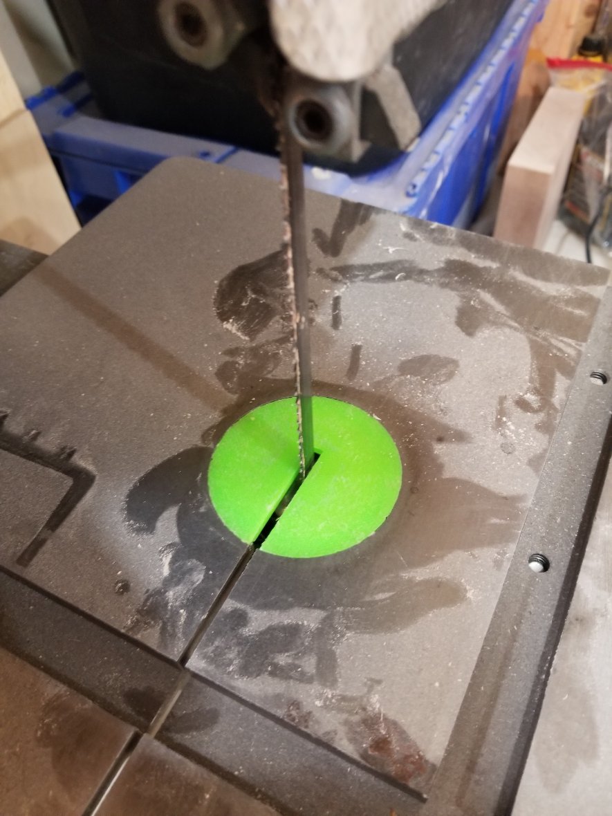

Hi all, attached is a photo of the 3D printed part. It's a snug fit so it won't jiggle around. I've also tried to share this through my Google drive so let me know if it works:
https://drive.google.com/file/d/1fjnfBf ... sp=sharing
if it does not, message me directly and I'll email it to you no problem. If you want/need this but don't have a 3D printer, I am happy to print it and mail it to you as well if you'll cover shipping + materials.
One note: the diameter is 63.5mm cuz I wanted a tight snug fit. I'd suggest backing off to 63mm if you want it to have some play

- Bandsaw insert
- SSbandsawinsert.jpg (148.82 KiB) Viewed 39511 times
