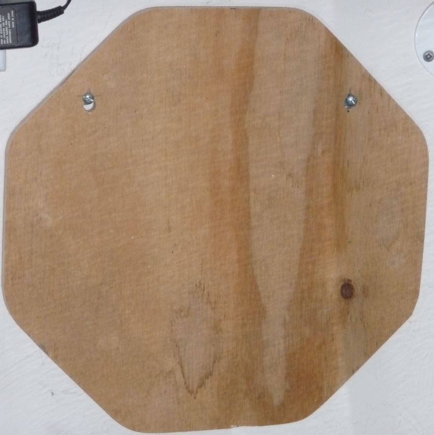

I solved the problem by by using c-clamps and a pressure plate. Works great and had no issues with the paper coming unglued.

The sandpaper disks were several years old and the glue wasn't sticking. I cleaned the disk with lacquer thinner, put on the disk, rolled over it with a rolling pin but the next day it had popped up on the edges. This was done last summer. I then made the pressure plate, clamped it overnight with c-clamps and even in this cold weather it still holds. BTW these were not Shopsmith disks; just some I found on sale at a local tool store.
