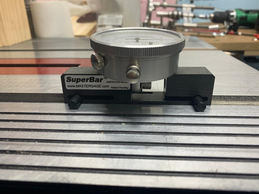

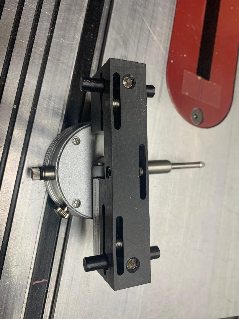

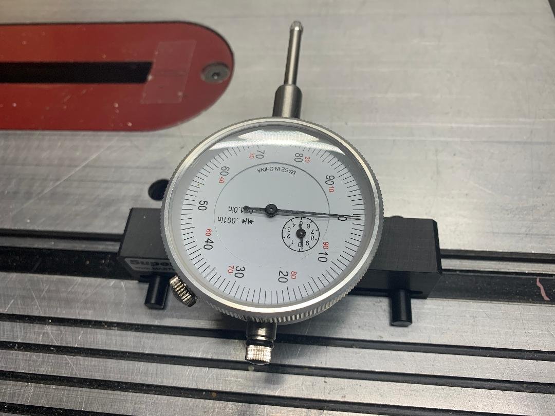

At this point I can't review it but I have put it together and adjust it to fit the slot on my shopsmith. I can get a nice sliding tight fit so I think this could be the answer to some of you wishing you had something better then the sloppy shopsmith system. I took a few pictures which should be useful for getting an idea of how this might work. Come spring I'll give it a try.

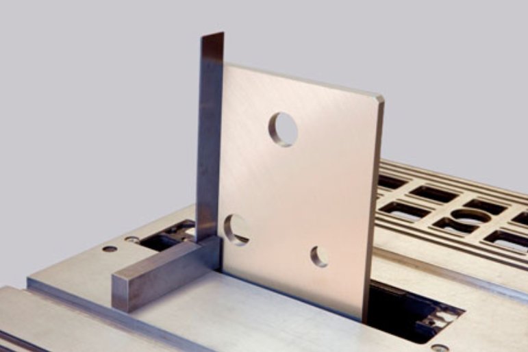

Anyone considering the SuperBar should check out the MasterPlate from the same people - also available in a shopsmith version - which makes it even easier to align your table to spindle. Gives you a machined flat reference plate to put on the saw arbor and with a good dial indicator setup in the miter slot (like the SuperBar, although I have the SS version which works just fine) it makes quick work of the job.

Interesting three point width adjustment. Does it suggest equal 'tightening' of the three screws?
- Posts: 21481
Re: Preview SuperBar
Equal tightening...No.
The instructions say to adjust the two outer screws for a "smooth" slide back and forth in the miter slot (which reduces most all of the slop) and to then adjust the center one for a firm fit in the miter slot. The sides of the SuperBar will not necessarily be parallel to the edges of the miter slot.
It works. It really does. The base of the SuperBar measures .720" in width (with no adjustment. My miter track measures ,7344". My Shopsmith miter bar measures .725" allowing for .0094" of lateral movement.
In a static test against my alignment plate (not a blade and not a MasterPlate) I can reduce that movement to .001". Adjusting the setscrews on the SuperBar to get to that point was a slow and tedious procedure but I think well worth the time and effort. Now for a durability test. I'll come back after a few weeks of shop time and recheck the measurements. I use an arbor mounted plate from Infinity.
The SuperBar won't have changed but the Shopsmith table may.
Side Comment: I do not move the dial indicator back and forth (tooth to tooth) as many do. I use two dial indicators, each zeroed to the plate in the center of the plate and then position the dial indicators at the infeed and outfeed sides of the plate. In that setup, I then strive for "equal" indications on both dial indicators. Blade (plate) is then parallel to the miter slot.
Thanks for the note. Very accurate. I also do this, although I did not understand why it is better to do this, it was just that they somehow showed me that this is better and that's it, I do this out of habit.dusty wrote: ↑Sun Apr 04, 2021 9:33 am Side Comment: I do not move the dial indicator back and forth (tooth to tooth) as many do. I use two dial indicators, each zeroed to the plate in the center of the plate and then position the dial indicators at the infeed and outfeed sides of the plate. In that setup, I then strive for "equal" indications on both dial indicators. Blade (plate) is then parallel to the miter slot.
