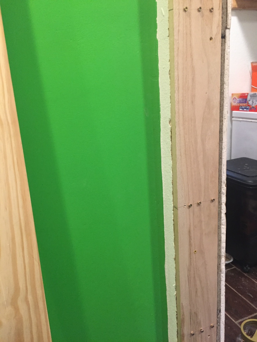

Odd solution I suppose...
Out of shims and needing to ensure hinge side of door jamb plumb. 1 3/4” solid core door in sound proofed wall.
Cut an Oak board to back custom jamb.
Hinge screws otherwise would have not been into anything but soft jamb material. Door jamb in wall was was not plumb. It bowed in at the jack stud in the middle.
My solution was to run in 3 screws in three areas and back them out to micro adjust them to plumb the jamb.
3 sets of 4” hinges will support the door with 1” screws all of which will anchor into Oak behind jamb.
1/2” Sheetrock and 1/2 Homasoate on both sides of wall made wall 5 1/2 thick opposed to traditional 4 1/2”
It will be exceptionally strong.

A mans got'a do what a mans got'a do !! Good thinking !!

Clever idea! Looks like it worked really well.
