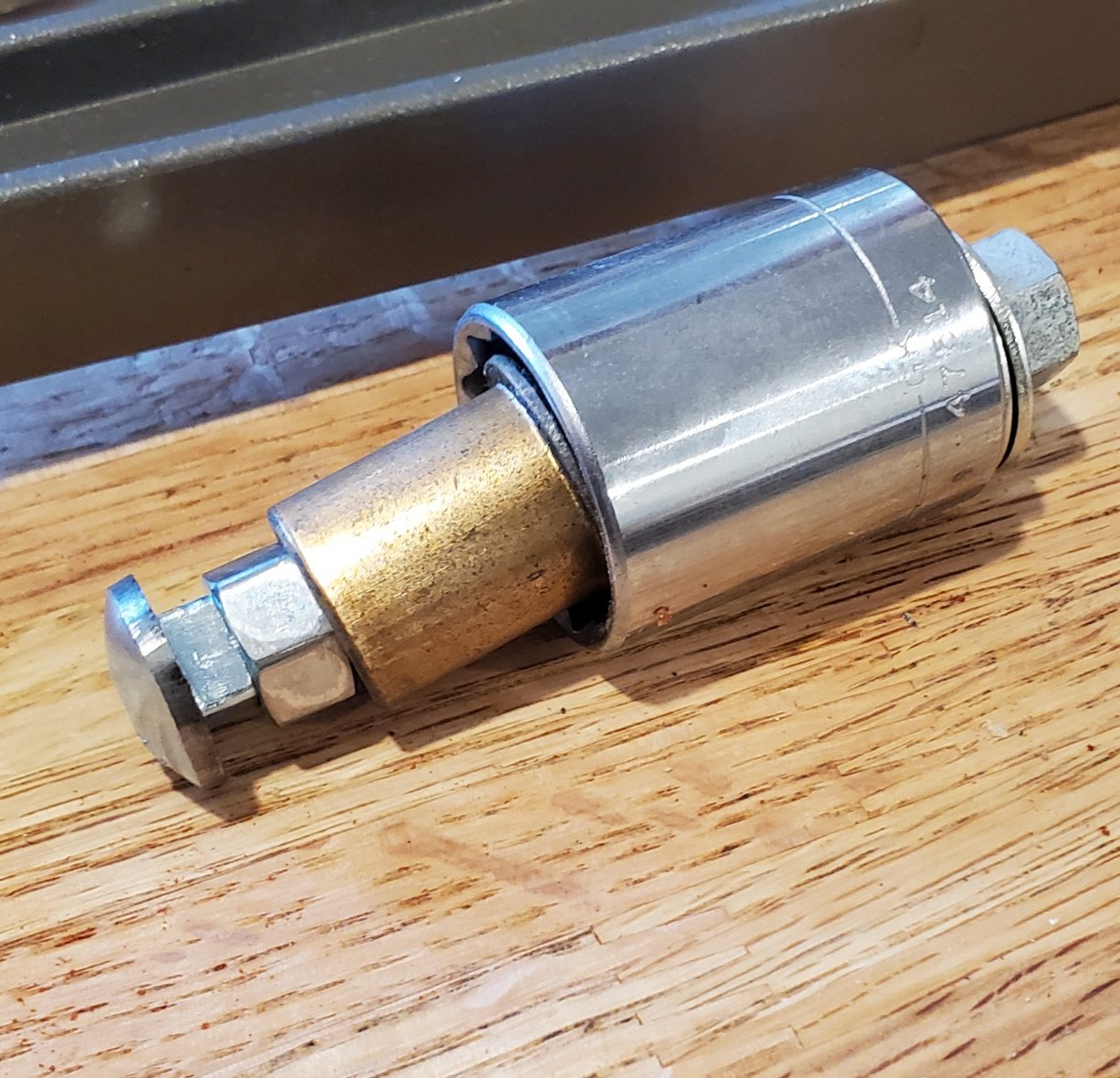

Finally got tired of the lateral play on my scroll saw and reviewed JPGs great thread including replacing the bushings. Here is my variation of his shadetree puller:
3/8 carriage bolt with head ground to a bit under 5/8
3/8 hex nut with corners ground to just under 13/16 to align the bolt to the bushing
1" socket, a couple washers, and a nut

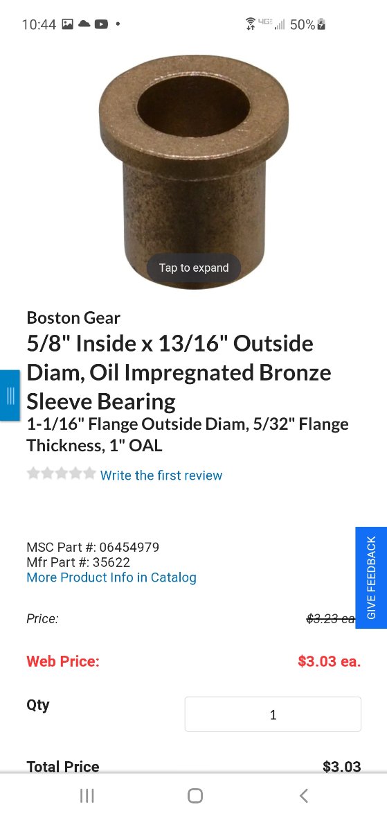

Remaining question is - where did you get replacement bushings?

JPG wrote: Fri Mar 12, 2021 10:06 pm Remaining question is - where did you get replacement bushings?
MSC, and I'm aware that I'll need to machine the flange to dimension.
