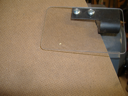

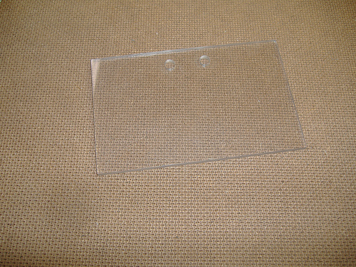

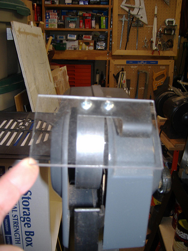

Hi more of the photos that are being removed from Flickr.
If you have this item and it has not been fixed you really should take care of it NOW!
[ATTACH]2646[/ATTACH]
90 deg. corner and sharp!
Hurt myself on this... I knew better and should have fixed this right off! Don't you do the same.
[ATTACH]2647[/ATTACH]
Close-up of shield, note the sharp conrners.
OUCH!
[ATTACH]2648[/ATTACH]
Rounded and I broke the edges as well so now you would have to work at hurting yourself

reible,
Just curious on what method you used to put the nice radius on the corners. Was it the "pattern sanding" method you illustrated recently on another post?
FYI... I recently saw a Hot Rodding article about some folks lowering the roof on a rarer old car. They wanted to take no chances on shattering the windshield, etc., as they removed 4 inches from the top of the glass. They used a Belt Sander (!). It used up a lot of belts but it was safe and effective.
Chris
Hi,
I think the picture makes it seem like a better job then it might really be, I just free handed it.
Interesting story on the chopped car. Reminds me of once when a friend had a broken sideview mirror and we were out looking for a replacement glass. Ended up having to go to a glass shop where the guy traced the broken mirror on to a sheet of mirror. Scored it twice and snapped it out then went to a big belt sander and sanded it to shape.... it just took a couple of minutes. Bingo a new mirror.
