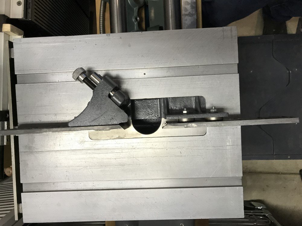

So lets make sure we are talking about the same parts. The Model 10E and 10ER Jointer/Shaper Fence that replaces the Table Insert is shown in the picture below.

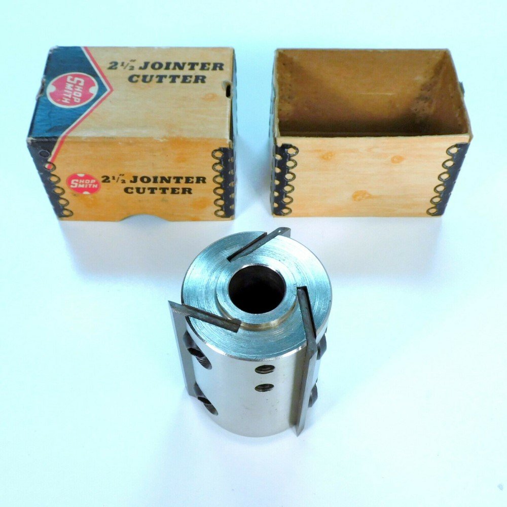

The 2-1/2" Jointer Cutter Head is shown in the picture below. As JPG said it attaches directly to the spindle.

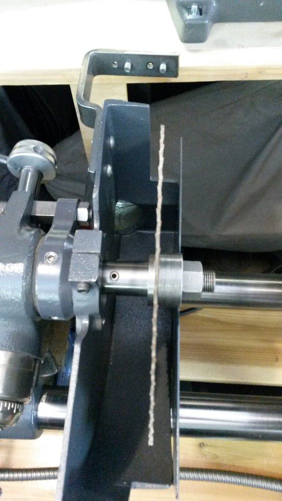

I have a set I use on my Model 10ER. When using it I mount the Saw Blade on the 5/8" Arbor with the machined washer first followed by the blade than the spacer and nut. This puts the blade in better alignment for use in this guard set. See the picture below.
