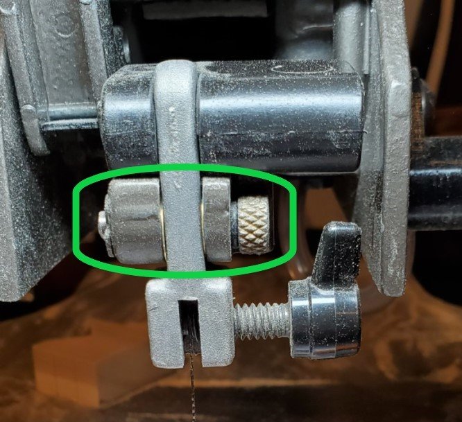

- Posts: 4541
Re: Scroll Saw Upper Blade Block
In paulrussell's picture above it shows a different mounting for the Blade Block than the older Scroll Saw used. The upper and lower arm ends are different and use a locking screw to hold the Blade Block in place as shown in the green circle in the picture below. With the older Scroll Saws using removable Blade Blocks they have a spring loaded pin to hold the blocks in place and different arm ends to hold the pin & spring. The part above the screw used to lock the Blade Block in place is a cam and flips over to the position shown in the picture after the blade is installed.

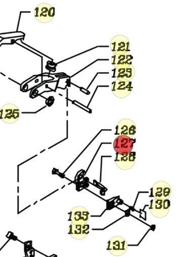

For my usage it's just the Blade Block and Thumb screw that are needed, those will replace all of the parts 126 to 133 in the picture below. It'll probably need washers or some filing to get the block aligned correctly, but the Shopsmith part should fit in the place of the original assembly in the tension adjust/support arm, part 122 below. The roll pin 123 is 1/8" like the Shopsmith part.

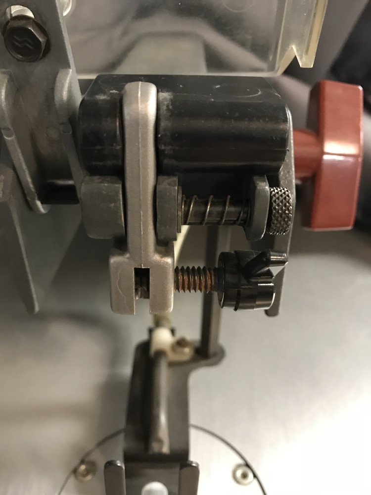

Russ - My upper Blade Block looks a lot like the one in the lower picture. The black plastic bits on the ends of the blade mounting screws were broken off, but I think those screws are otherwise correct. First question, what goes into the mounting block from the other side? It looks like it should be a setscrew(?), but with what type of tip? My upper had nothing and my lower has a setscrew with a pointed tip. (Almost certainly not correct.) Mine has the black plastic cam at the top. Are there any other identifying characteristics of the Blade Block Upgrade? Assuming I have that Upgrade, does that mean I don't need the Blade Mounting Fixture that I don't have? And, again assuming yes, are there any tricks to mounting the blade, or is it release the cam, insert blade, tighten screws, engage cam? Thanks,chapmanruss wrote: Thu Apr 22, 2021 12:38 pm In paulrussell's picture above it shows a different mounting for the Blade Block than the older Scroll Saw used. The upper and lower arm ends are different and use a locking screw to hold the Blade Block in place as shown in the green circle in the picture below. With the older Scroll Saws using removable Blade Blocks they have a spring loaded pin to hold the blocks in place and different arm ends to hold the pin & spring. The part above the screw used to lock the Blade Block in place is a cam and flips over to the position shown in the picture after the blade is installed.
..._
Below shows the Blade Block Upgrade on a Model 555220 Scroll Saw.
_
Edit: I should add that the hinged cover on mine is gray metal, not clear plastic as shown in the second pic.
