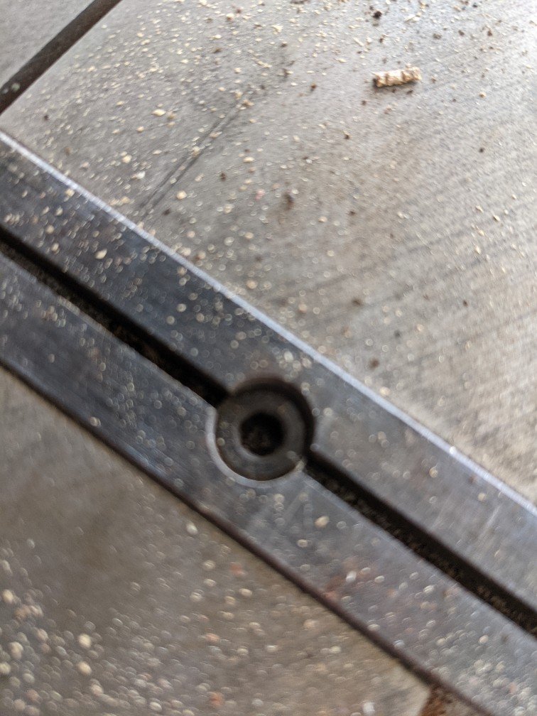

My mitre gauge is stuck in my band saw table! I kept having issues with it sliding around while resawing so I guess I over tightened it. I think the nut is stripped now somewhat. Any ideas on how I might get this thing loose? Thanks!

Is the Allen hex stripped to the point that an Allen Wrench will no longer turn it? You could try a new Allen Wrench that is not worn on the end and if that doesn't work maybe a stripped screw extractor like the ones found at the link below.

Those tapered screws can be pretty sticky. I've found that putting some powdered graphite on the threads helps, but it wouldn't solve your immediate problem. I'd be tempted to try a drop of oil, though.
Is it the threads or the hex-drive socket of the tapered screw that you suspect is stripping? If it's the socket, you might try a 4 mm hex key -- they're just a fuzz larger than 5/32".
Failing that, just how tightly is the miter bar stuck? Can you get the blade of a large flat screwdriver beneath it in the transverse miter slot, and wedge/pry it out?

There may not be enough depth to use a screw extractor. The hex socket in the head of my locking screws runs all the way through so make sure your hex wrench is all the way down in the screw until it hits the table (I don't know if they're all like that). If it's too stripped out as then use a slightly larger wrench as already suggested. Hammer it in if you have to. You may as well let some penetrating oil seep into the threads if it will.

If you are using the SS standard allen wrench or the T handled one they are too springy to turn a tight screw. I had a problem removing the cap head screws from the wedges that hold the knives in the SS Pro Planer. They would not budge with the long SS T handled wrench. I have a few Apex bit holders and bits. The hex bits are only about 1" long. One of those and a 1/4" ratchet and they came right out with only moderate pressure.

Thank you all for the advice! It looks like the hex part is the part that's stripped. I was able to use a screwdriver to leverage it out of the slot. Now it's gone be a challenge to get the screw out of the mitre gauge I think. Also does anyone know what size screw that is?

That is a special screw with tapered threads. That is why it expands the miter bar when you tighten it. I doubt it is commonly available. Someone here will know.

Well that just figures. Ah well. I still can't get it out of the slot. My screw extractors aren't gaining purchase and it strips every allen wrench I use on it.

Heat????
Re: stuck mitre gauge!
Heat might work. I don't have a propane torch or anything like that, but I have a heat gun I could try.

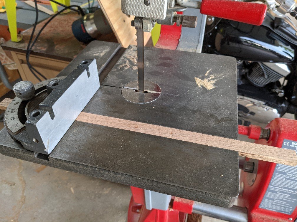

I'm the meantime I remembered I was a woodworker and made a temporary (I hope) replacement
