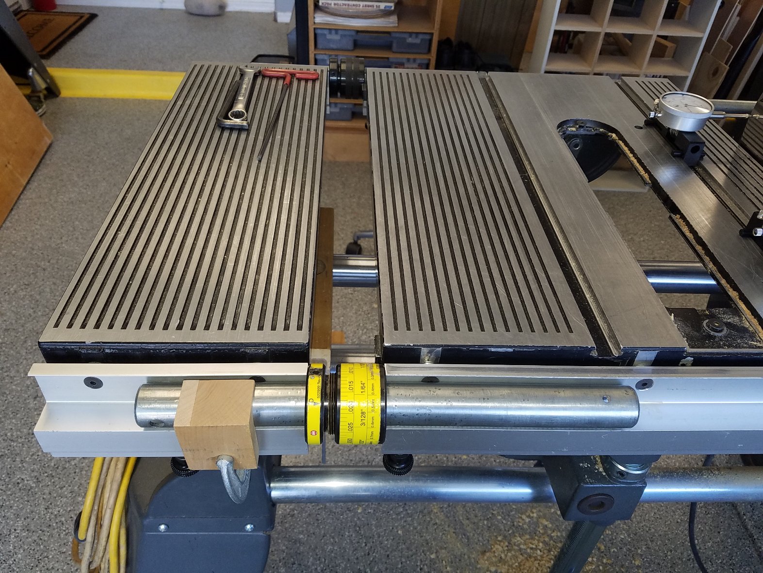

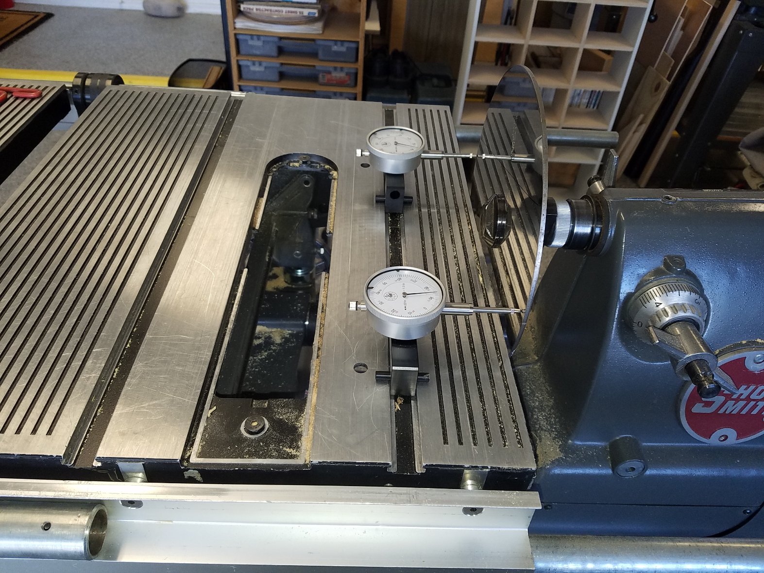

My Table to Blade Alignment
is done this way with all four trunnion bolts loose to allow the table to be repositioned under control of the two Adjustable Stop Collars.
"Equal radings" on dial indicators indicate parallelism of a miter track to the alignment plate (saw blade). I do this only when table to blade alignment is in doubt (which is seldom).
NOT BETTER just EASIER and LESS TIME CONSUMING
A pair of Shopsmith  Adjustable Stop Collars mounted on Extension Table Legs replaced by Double Tilt modification.
A pair of SuperBar Alignment Gauges and an Infinity Alignment Disk.
